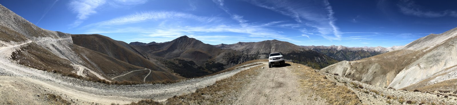

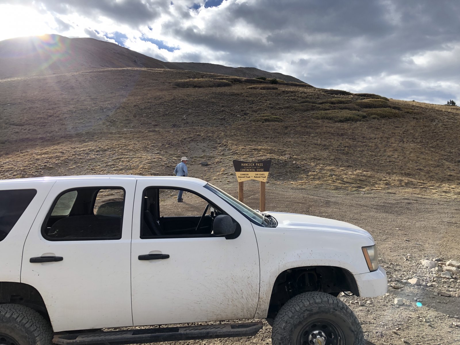

It’s days like the one pictured that make me question myself on whether to upgrade this further or get something newer.
This photo only shows the flat easy spot at the pass, not the torturous trail to get there. Nor the descent on the other side. It was NASTY. Rock ledges, waterfalls, basketball sized boulders littered the trail. People on quads were offloading passengers to get through the bad spots. Didn’t see another street legal vehicle, nothing but quads and SxS.
And the old girl just crawled up and over, not really struggling. ATV riders complemented me on making it look easy. I’ve had a bunch of 4x4 vehicles, and this platform is more capable than most. The only street legal vehicle I’ve had that could top it was a heavily modified Jeep with front and rear lockers.
So maybe she WILL get another season at bat. And if not, a newer GMT 900 is probably my solution.
Decisions, decisions…

Navigated some long shelf road sections in CO today.
Stopped for lunch at this spot with nothing but high peaks in all directions, and came to a kind of bittersweet decision. This will be the Tahoe’s last trip with us out to places like this.
One of my goals this summer was to assess the build and decide whether to proceed with more mods, or move on. The Hoe may stay in the fleet and stay closer to home, but the potential consequences of mechanical failure in an area like this are just too severe. So I’ll be getting something new or newer for future exploring.
For the kind of places we like to go, it just makes sense to stay in the sweet spot of a machine’s reliability, which is neither the first 90 days nor 13 years+ of age.
Well, sort of like the weather, I’ve changed my mind. We have been kicking around ideas for what to take on our 2022 expedition; newer Hoe, new Wrangler Rubicon, 4Runner, or the Bronco. After many conversations and wandering around car lot we’ve decided nothing suits us quite as well as the purpose built TrailHoe. Even a newer GMT900 Hoe would present a new set of unknowns.
So, I’ll proceed to fix up the few known to me weaknesses, and then the old girl will get a trip to the dealer where I’ll pay them a few hours labor to inspect it front to rear and identify anything potentially leaving me trailside with a no-start situation. Depending on their findings, I’ll probably just have them fix anything they can find.

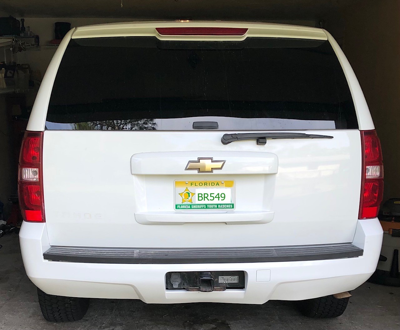

Today I made a donation to the state to get myself a specialty tag. I figure this will give people pause from 50 feet away. :D
And no, that's not my real tag number, that's photoshop. If you get that joke you're telling your age.
Great idea, as it would definitely make me slow down coming up on your six if I were doing my usual 9-11 miles over the limit.
