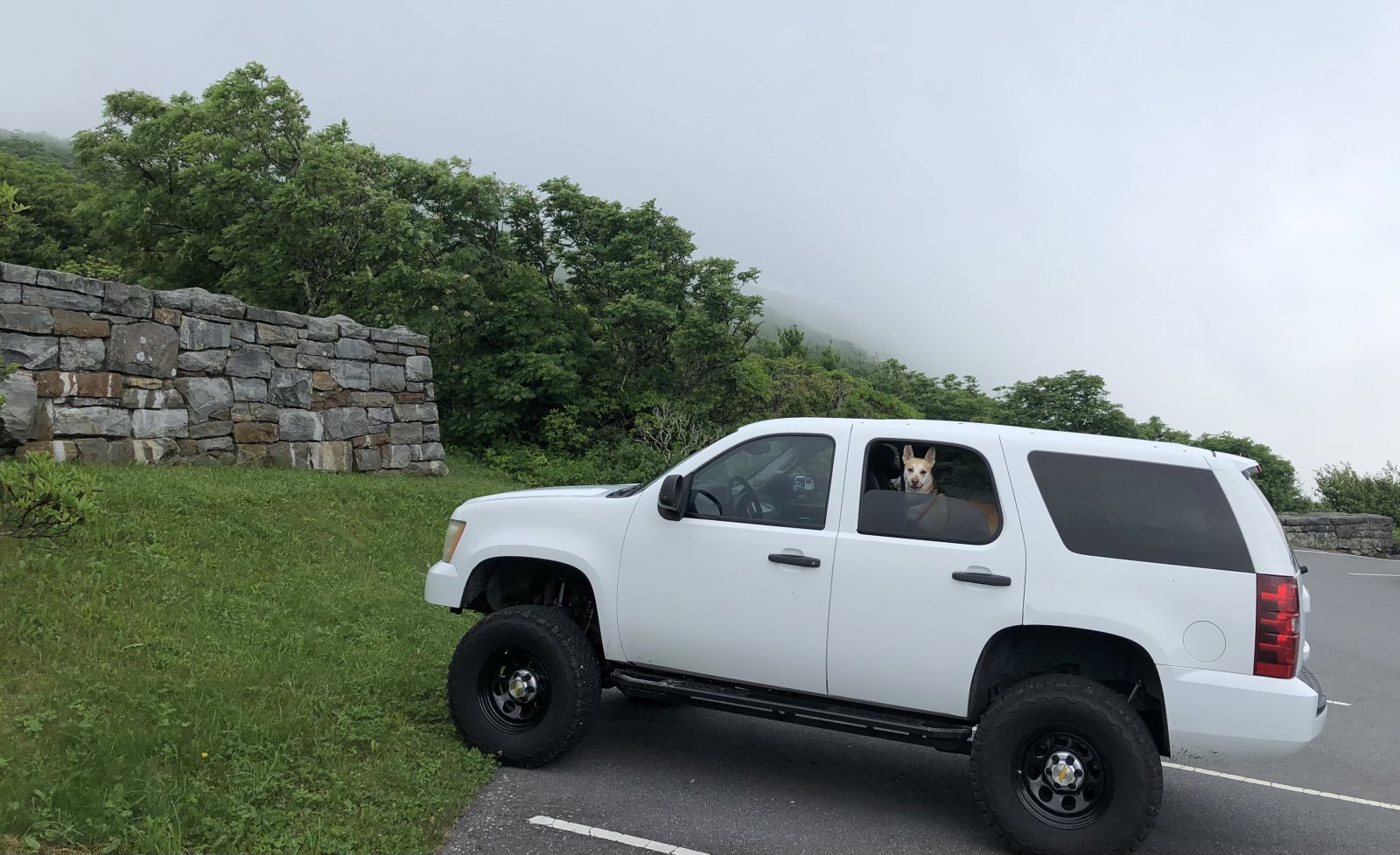

Been doing some more roaming around along the blue ridge.

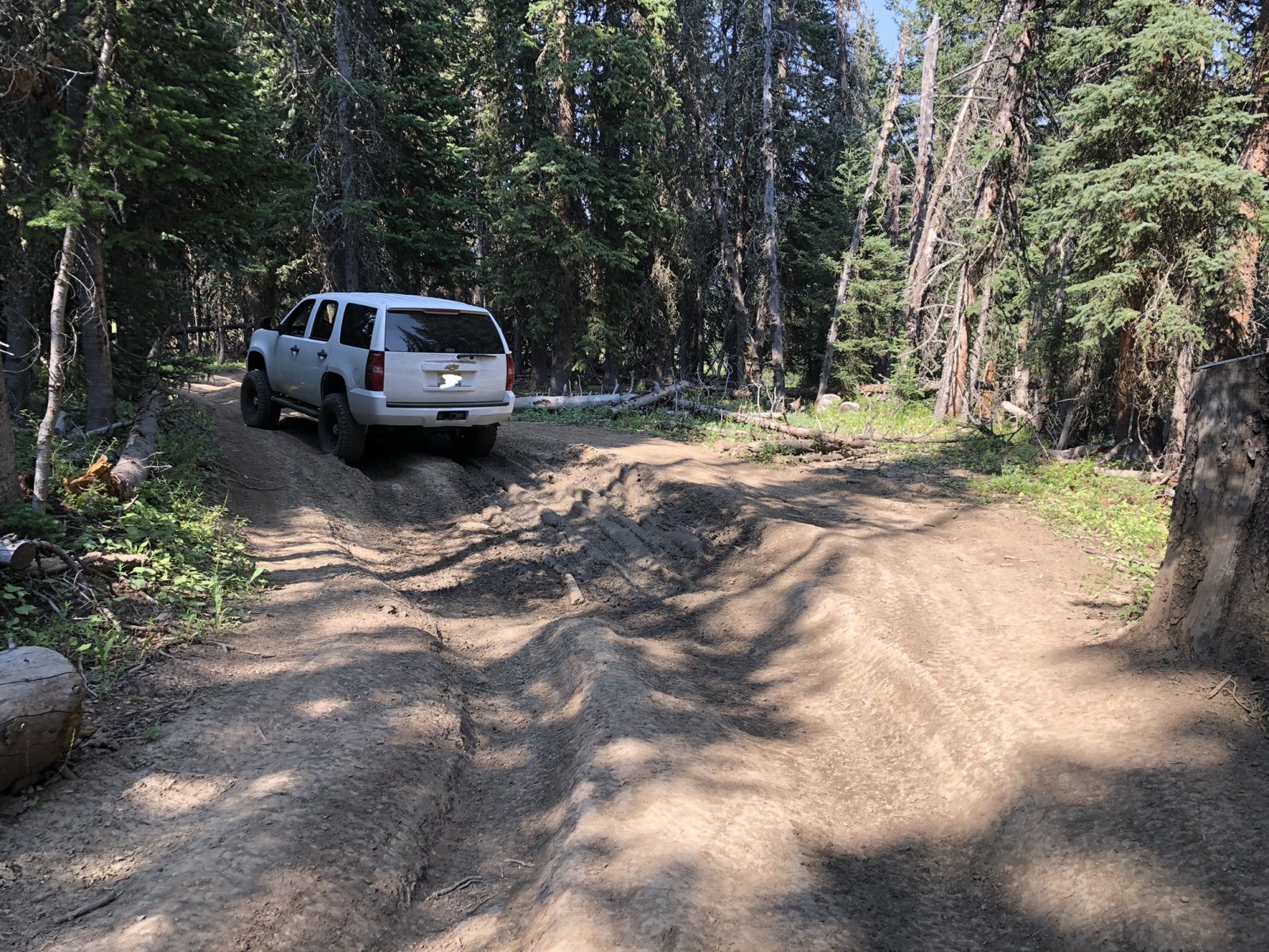

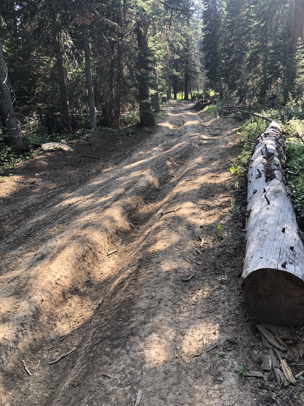

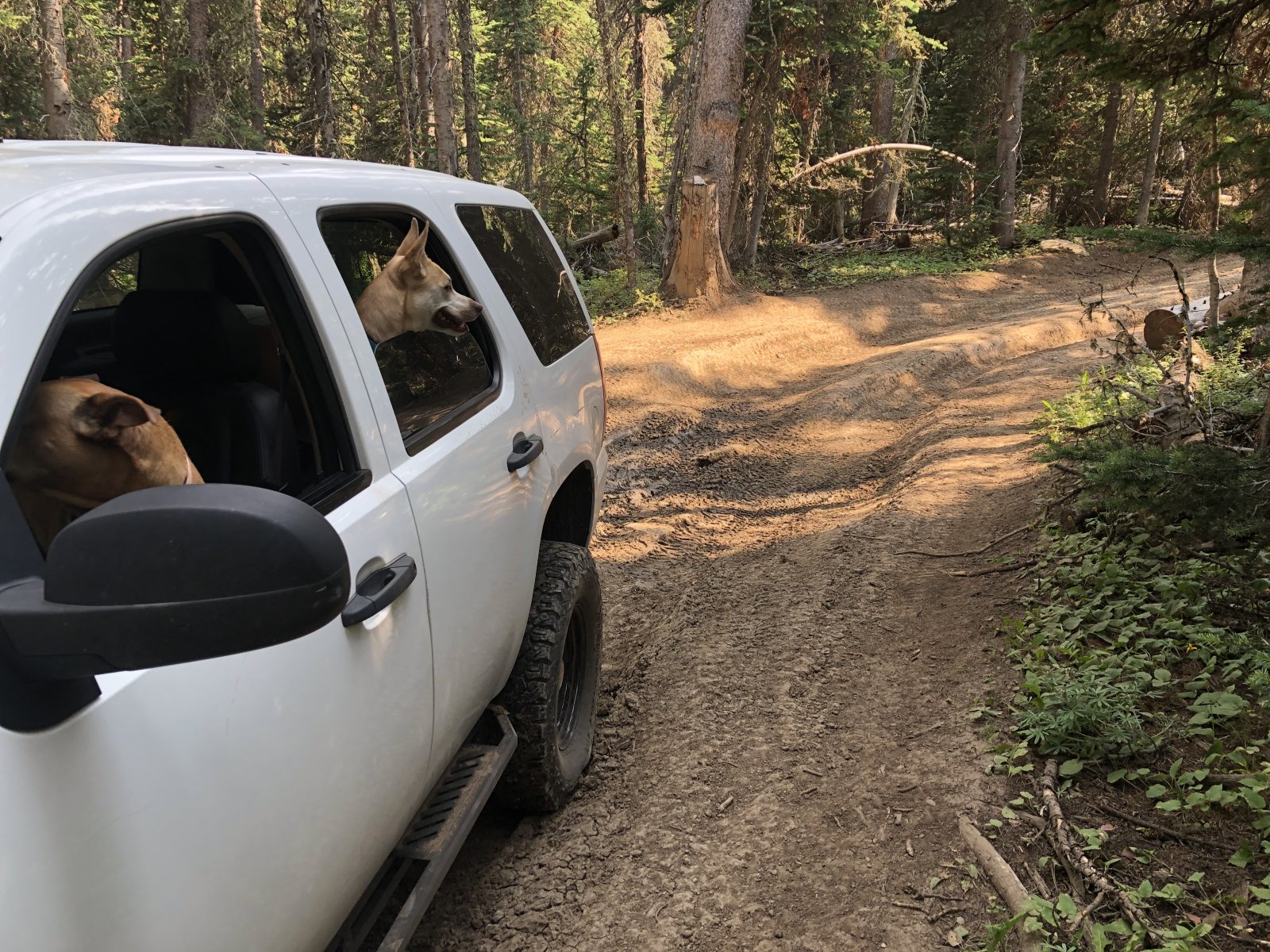

Yesterday spent some time trail riding on what was essentially a trail for ATV and UTV drivers. It was the first time I’ve had an opportunity to test the Hoe on a trail where a stock 4x4 would not be happy. I came away feeling good about the decisions on lift and tire size. I have often wondered if I went too far.
Yesterday illuminated the value of lots of clearance. Deep ruts, roots, rocks, the 35’s make it so much easier. The approach, departure and break over clearance let it stroll right over whoops and ledges that would force a lower vehicle to take an oblique angle.
I do still feel that the front diff is a weakness, and I drive it carefully in the rough.
As the summer progresses, I’ll get some better pictures of it in action.

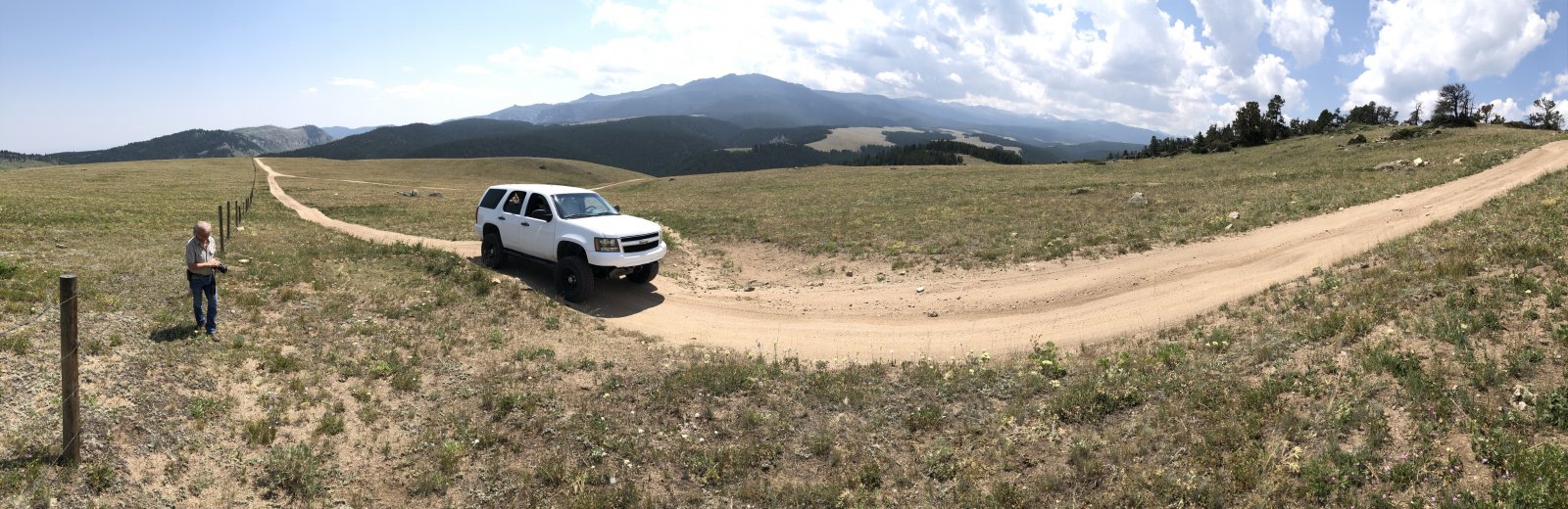

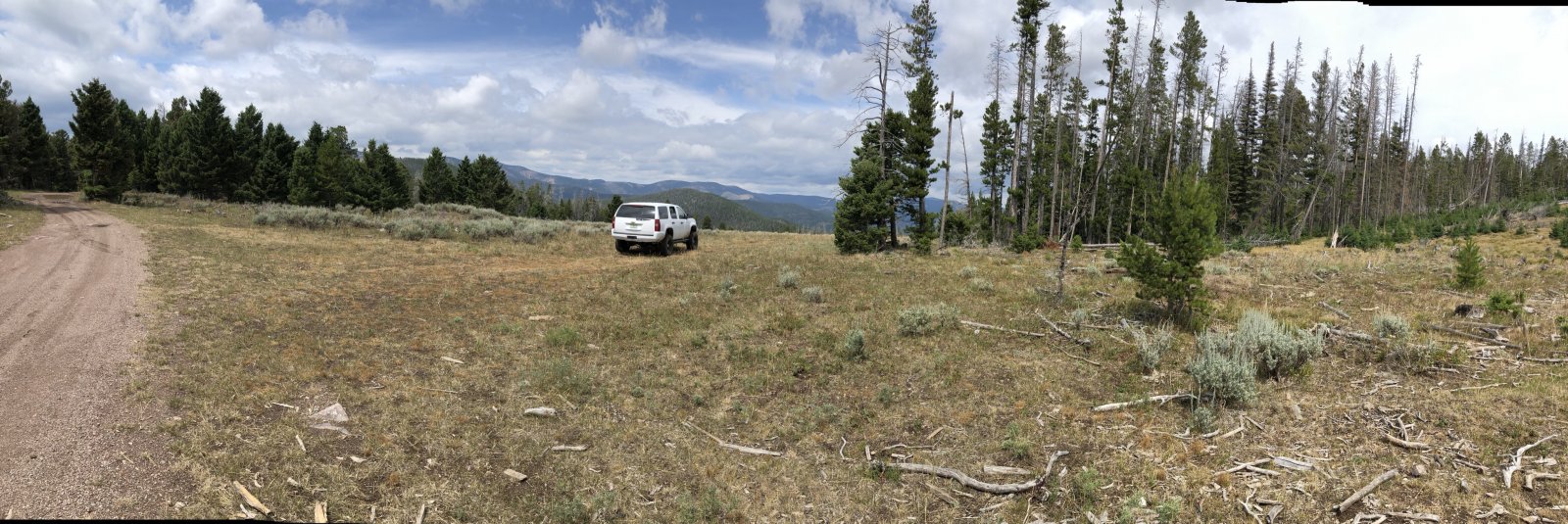

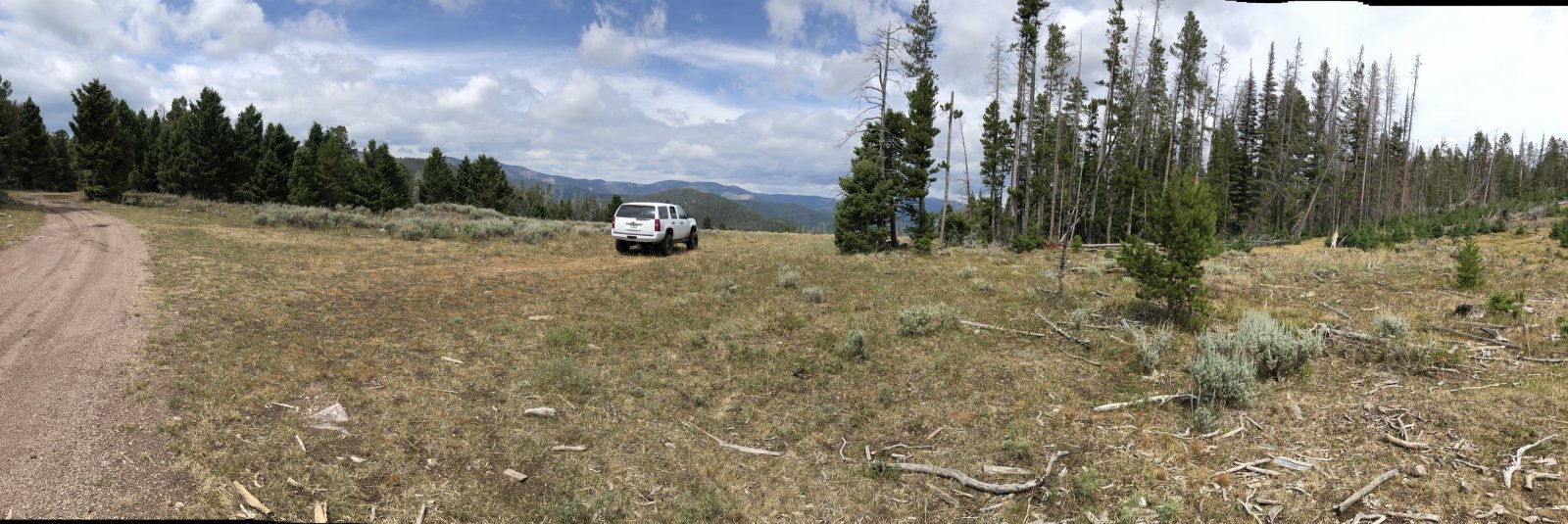

Today took a ride along the continental divide trail in MT. Parts of it were nothing more than a SxS trail but the Hoe didn’t break a sweat through mud, rocks, and roots.
Here’s a pic along the top of the divide.
21,321
30,315
Nothing going on build wise, just maintenance lately. Brake booster in WY and fuel pump in MT.
Performance on and off road has been everything I hoped for. Yesterday we were out in the National forest and picked up a hiker caught out in a rainstorm without adequate gear and took her back to her camp. She commented on how smooth the ride was on the rough track. I’ve put in so much seat time now I’ve forgotten how bad factory vehicles ride off pavement.
