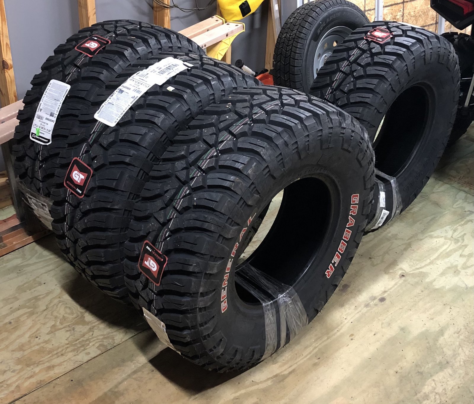

View attachment 268032 Good work by TireRack and UPS. Ordered these Wednesday and delivered on Saturday. :thumbsup:
Grabber X3 MT 35/12.5/17 in load range C, from which I hope to get a nice soft ride.
The lift, meanwhile, is meandering around in the ****** of LTL freight. :whip:
Eight days and counting.
Nice grabbers. We make those in southern Illinois. Hope you like them. Thanks for supporting USA made.
Every chance I get. :waytogo:
And thanks for making things! Too many people in our economy today don’t want a job unless it’s sitting behind a computer screen.

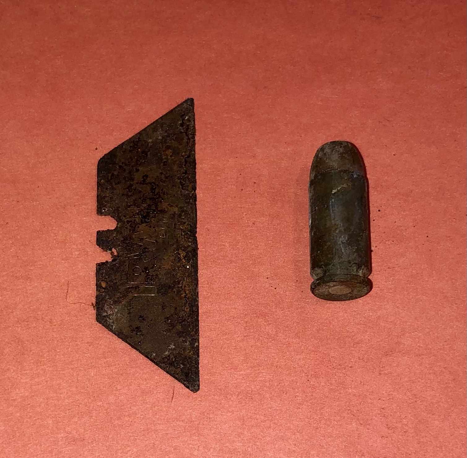

Note to future buyers of retired police vehicles: don’t go blindly feeling around under the seats!
Found these had migrated all the way down below the carpet under the back seat. A somber reminder of what officers have to deal with on a daily basis.

Looks like they've encountered some moisture down there.
Yeah, I don’t like to think about what exactly that may have been. :eek:
Although there’s no traces under the floor insulation, so maybe it’s been cleaned.
Or maybe the CBP took it swimming on occasion. No trace of flooding damage or rust in the body, though.

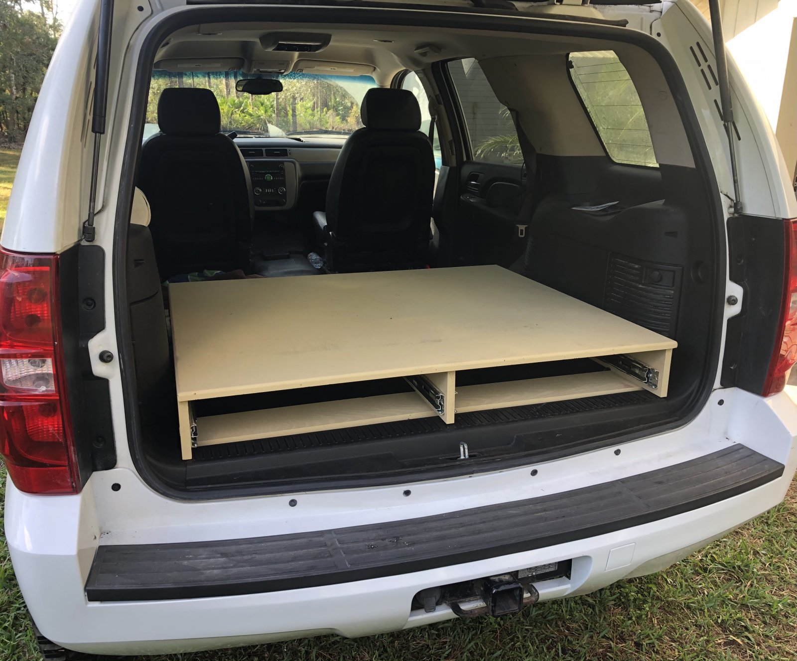

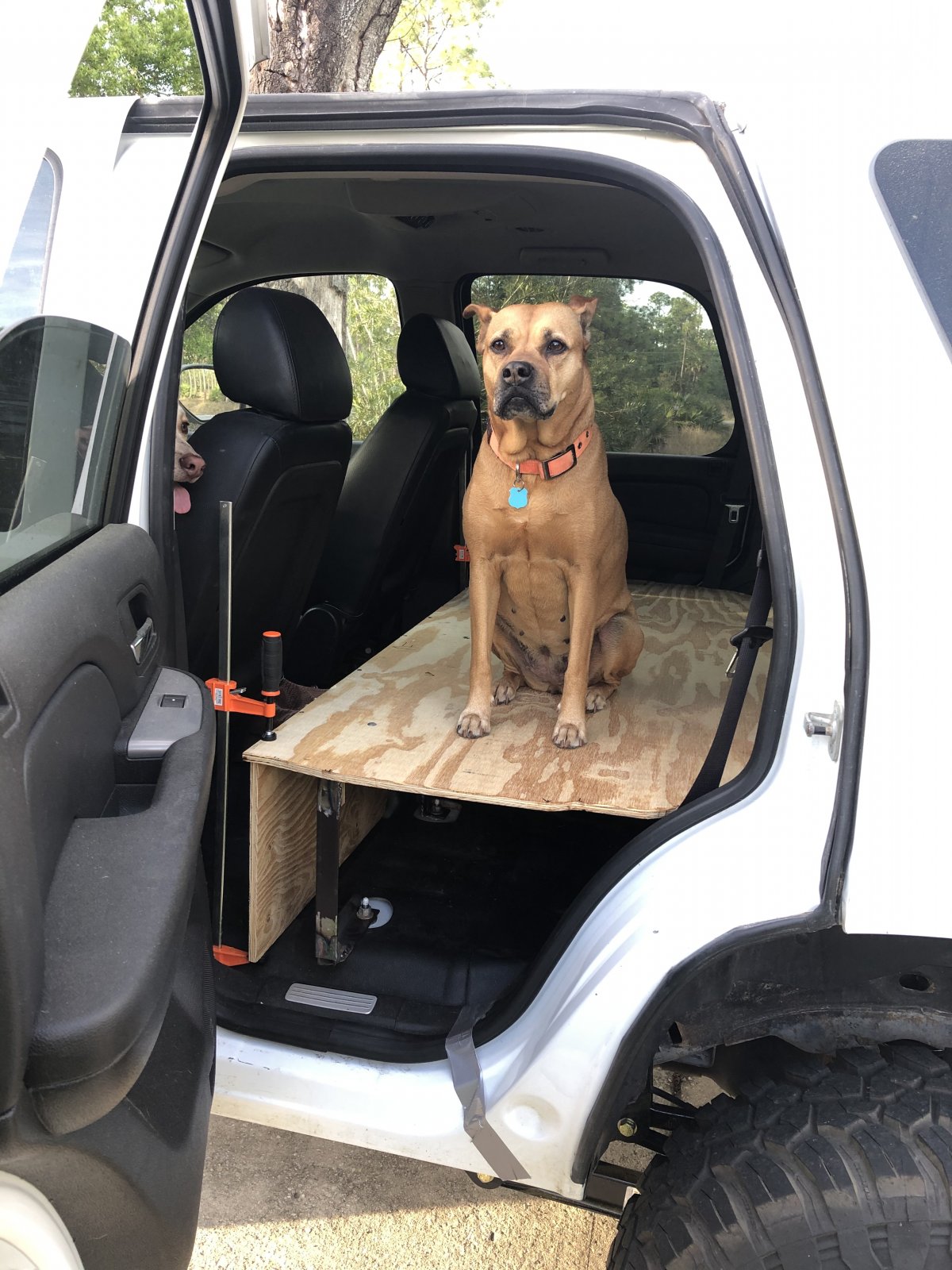

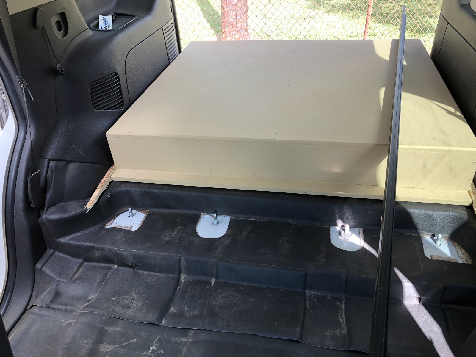

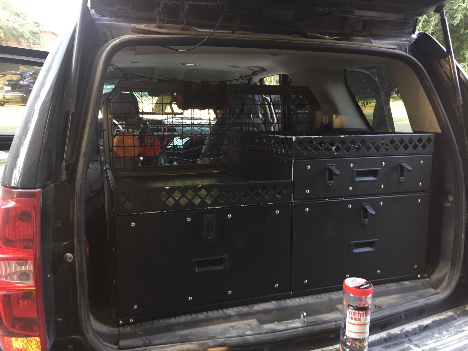

I’ve been pecking away at the storage deck in between other priorities. Got the rear portion done, other than waiting for the paint to cure so I can carpet it. Two drawers with full extension slides in that.
I’m building the deck in three parts. The rear section can be in place with or without the rear seating. The front portion will be in two parts so if I want to use one side of the 60/40 rear seat I can.
B
Bill 1960
Testing the Limits
Dec 17, 2020
1,480
2,866

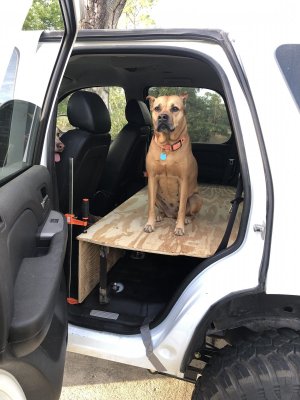

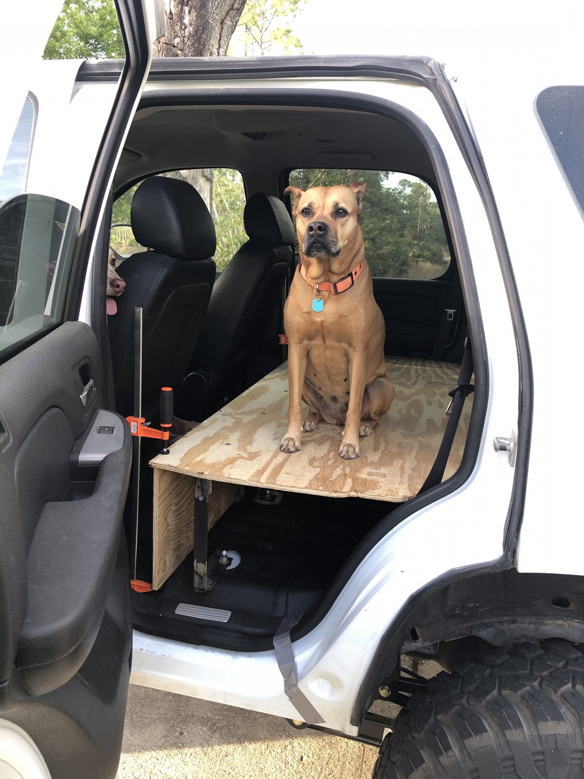

Partially complete; enough for a fit test.
It was designed to be at the height where the dogs can see out those rear half-opening windows.

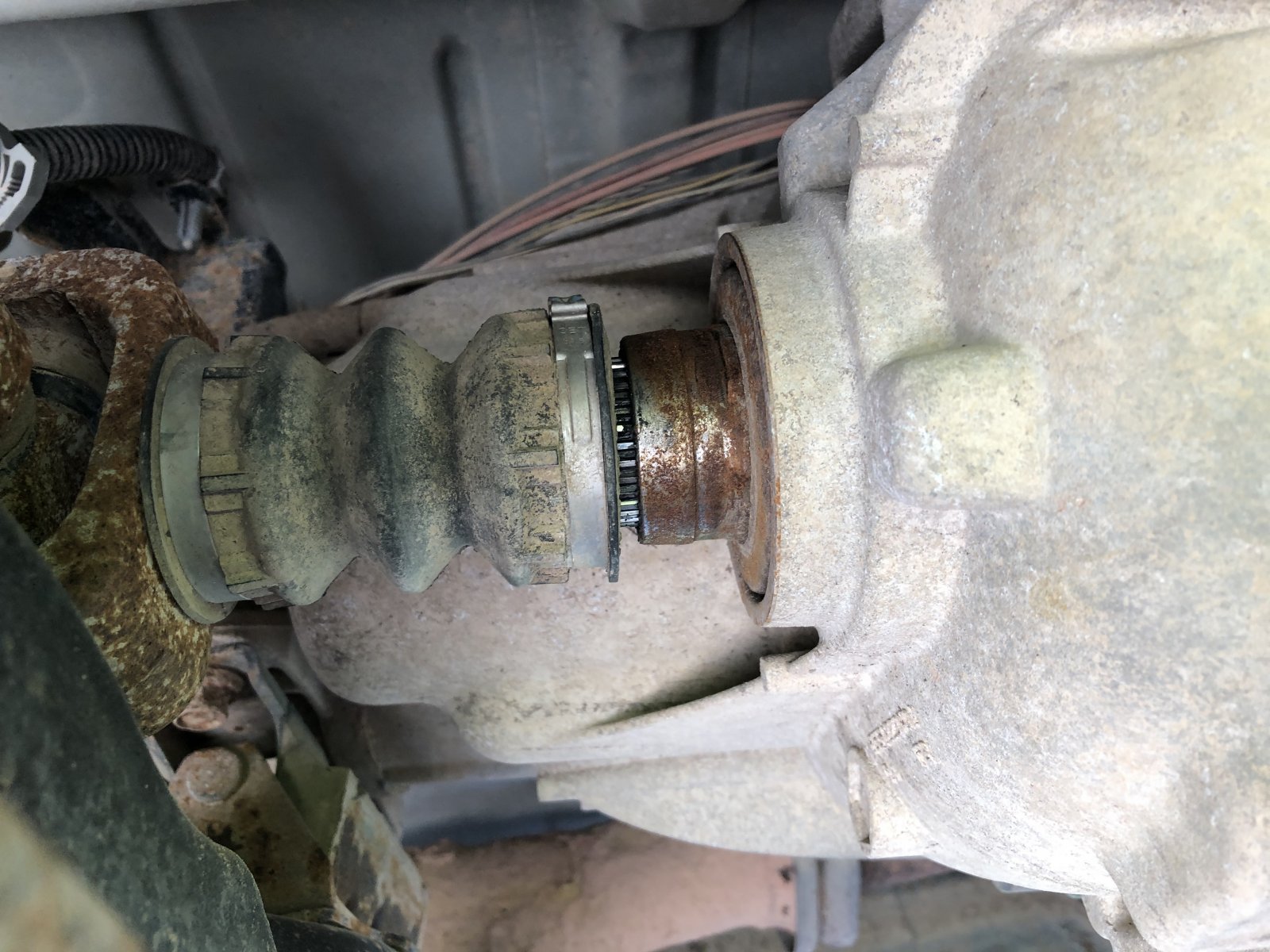

Discovered a side effect of the lowered front diff. When I reinstalled the front driveshaft I noted the boot on the transfer case end was stretched pretty tight. A few hundred miles and it’s popped off one end. I’ll be getting a new shaft built 7/8” longer to return the splines to the factory engagement. And a new boot, the rubber on the original has hardened somewhat.

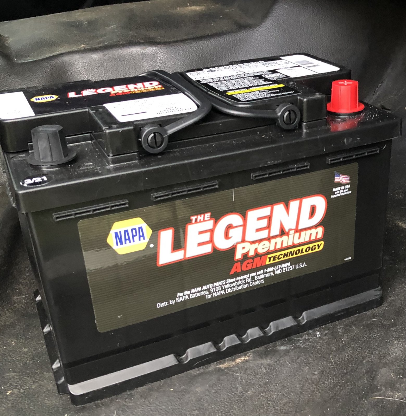

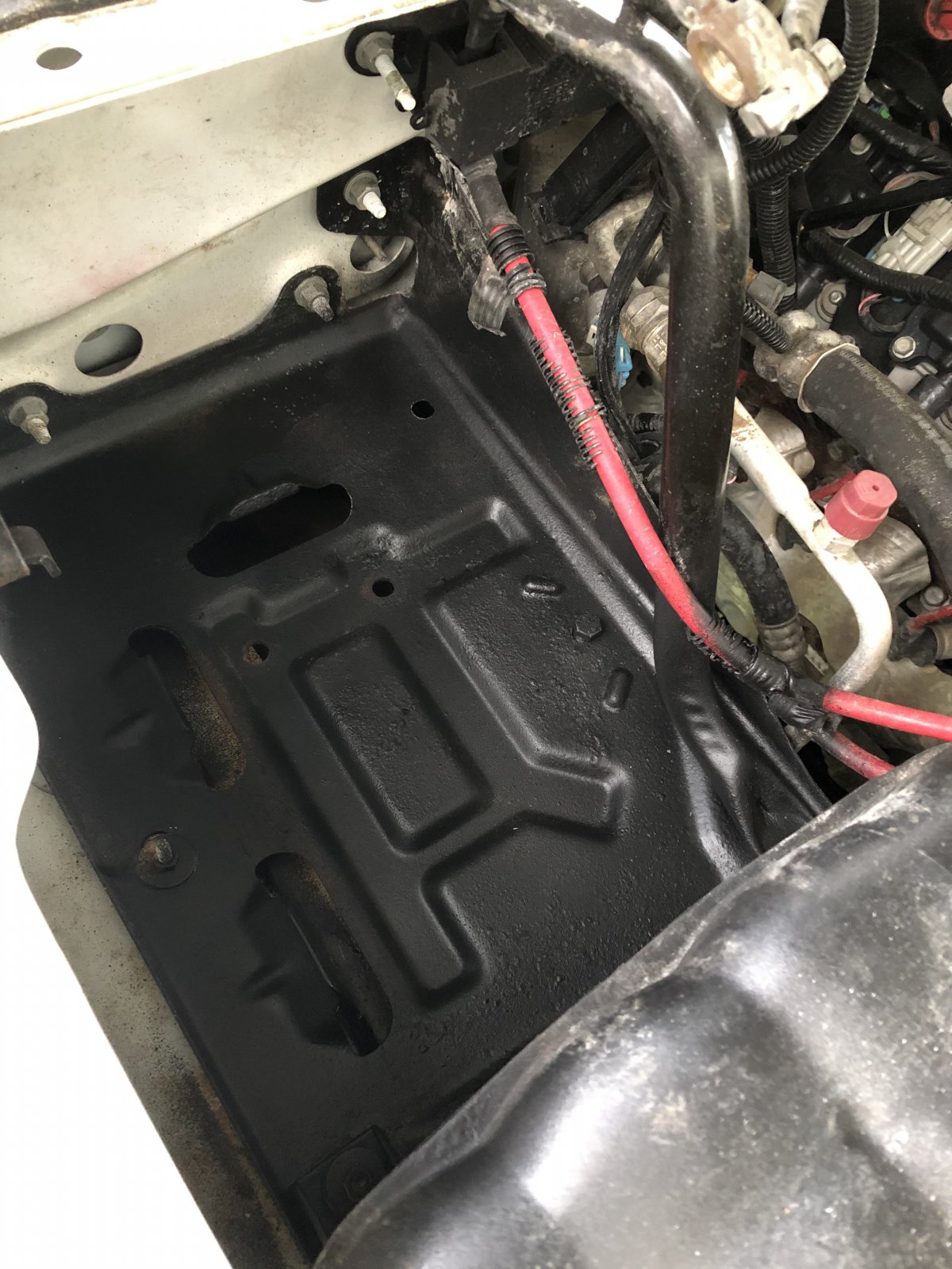

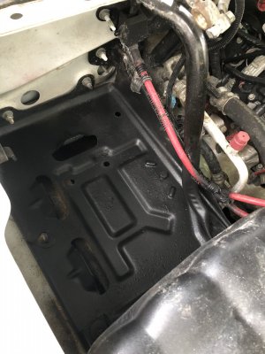

The battery was on life support when I bought the truck, so time to drop in a new AGM. I hate cleaning up acid spills and corrosion so that’s the only type I buy. While I was in there I cleaned up the battery tray and sprayed some rattle can bedliner on it.
