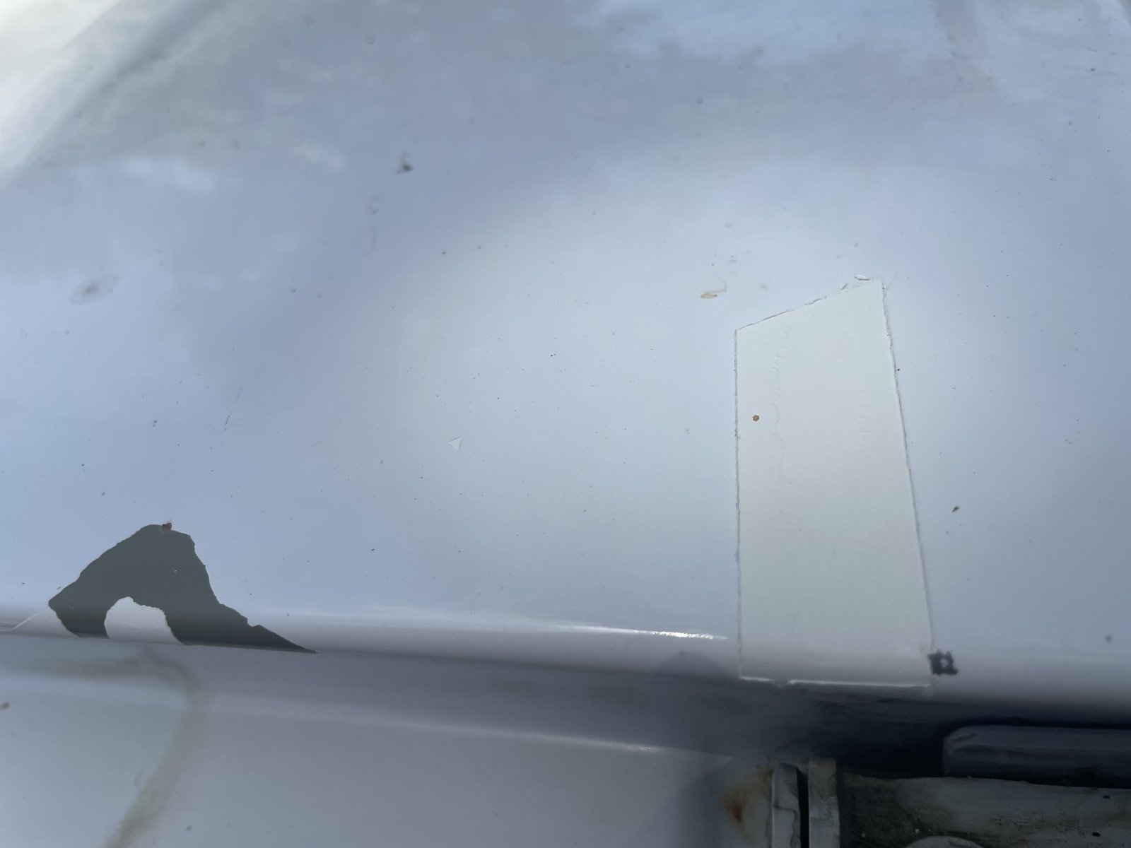

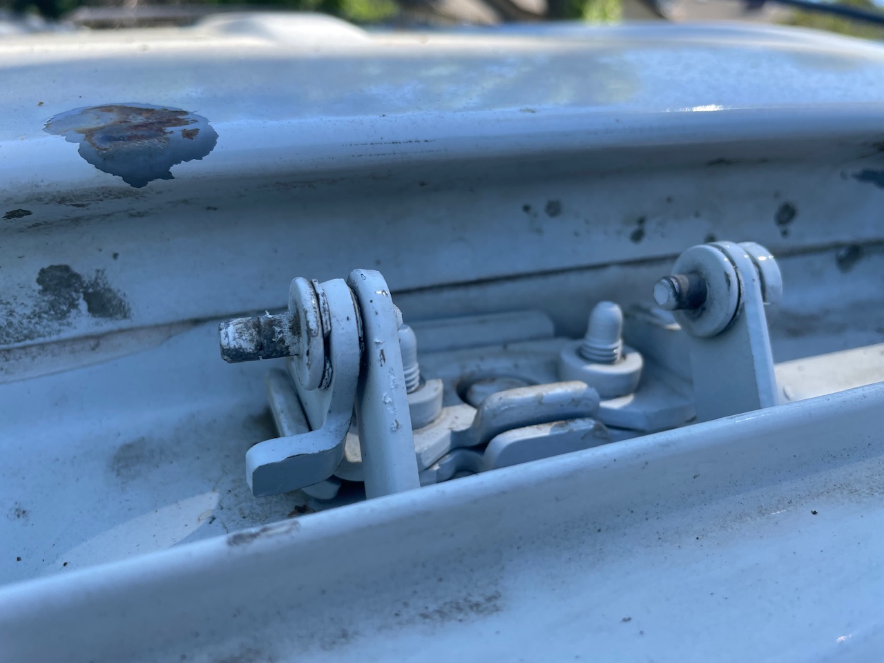

I have several spots where the paint has flaked. Looking for a cheap & easy way to stop it from spreading.. OK a little rust here too..
I'm thinking about cleaning the surface, sanding the edges down a little, spraying some primer, then spraying matched color from a rattle can.
Doesn't have to be perfect, but it would be nice if it looked decent and stopped the paint from flaking more..
Any tips, suggestions?

Only real fix is to sand the whole hood down and do a compete respray; anything else is a bandaid.
If you don’t care how it looks your method would work in the interim. But it will flake again as it’s compromised and will continue.
Or sand the whole hood down and wrap it.

Bandaid was what I was thinking.. My hood is actually NOT flaking. Most spots are half dollar size, one hand sized spot at front roof.
Doesn't have to look great.. But hoping it doesn't look terribly bad, and can keep it from flaking & rusting for awhile..
I sure don't want to sand the whole hood or car! At least not as the truck sits currently.. (Bought to be a 'work' truck basically)
If the build progresses, maybe someday.. (even then I don't want to do the sanding!)

Question 1: Are you in the Rustbelt?
I think California, right?
Is that the roof at the liftgate hinges?
Just sand it with 220, then 320 feathering into the good paint (maybe try 120 first to get rid of the rust). Hit it with an aerosol self-etch primer, then matching white spray paint.
Clearcoat: A 2k clearcoat will be best. But you don't want to mess with that, you can get some protection with the 1k clear aerosol cans from the auto parts stores. Not sure how long those last TBH. They do sell 2k aerosol cans though. They only have a few hours pot life, so if you go that route, at least get something else lined up, like the wiper arms.

Yep California, and that is the roof above liftgate.
I'm going to stick with aerosol cans, no compressor or spray gun and I hate cleaning up paint mess :)

it's pretty typical for the gm white paint of that era, it just peels off (like a onion) and exposes bare metal then the metal will get a smidge of surface rust.
just like the red paint fades of the same era

You could just also sand it and prep it, and shoot it with the white Rustoleum primer and a white paint, both in spray bombs. I just saw your photo again and that looks very small. And no one will ever notice it.
Yes, you can do a solvent cleaner like wax and grease remover (or 1:1 isopropyl alcohol with water). Then follow it with Sprayaway glass cleaner. Some folks do the alcohol last because it removes the static charge to minimize attracting dust.
Those wide paper masking rolls work fine for protecting adjacent areas. Just don't use polyethylene plastic because the dry paint flakes off and will land on the next paint coat you are doing. Specialty plastic used for body work is coated to prevent this, but not the plastic stuff from the home centers meant for painting your house.

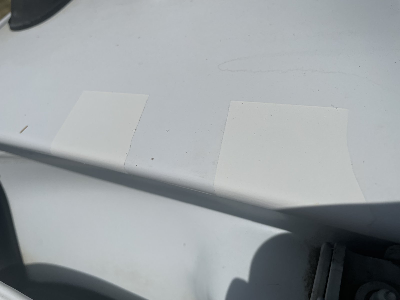

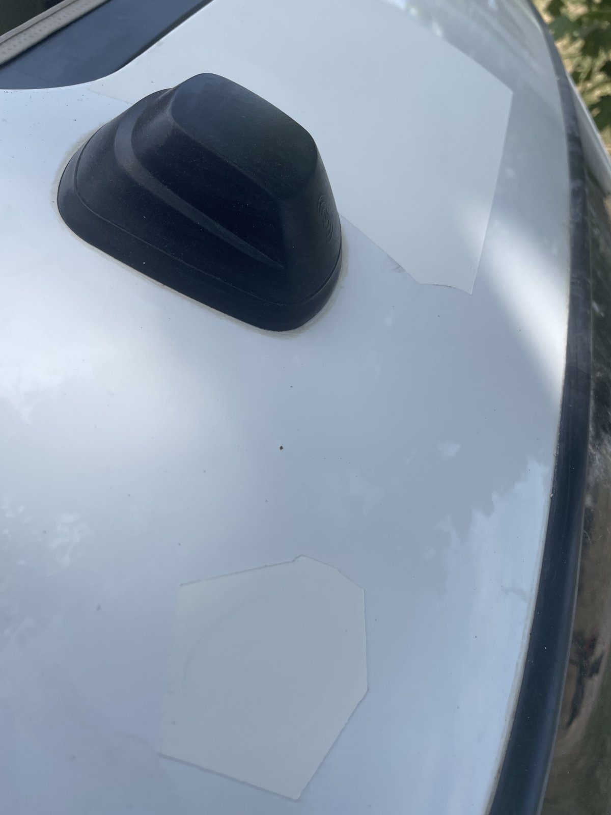

I'm slow to paint!.. I just primered some yesterday..
Had an issue with first primer coat too wet, and it rippled along some of the feathered edges.. Sand the ripples out, and do it again.
But sometimes they lay flat while sanding and you can't see where you need to sand anymore.. (until you spray again!)
Then I discovered, when peeling off the blue tape.. it will rip more paint off! Ripples under primer on the right...
So now I have a couple more spots to prime.. Will try green purple tape next round..
At least the big bare flaking spots are covered.
The rusty spots mostly sanded out, and was not deep like the photo seemed.
Used a little rust remover for some tiny pinhead specks because I didn't want to sand the metal too thin. Rusty spot in first post on the right.
I got 1k paint and no clear coat..
I know the sheen will be off, but I don't see myself painting this whole truck and polishing it..
If it's just solidly white looking and stops flaking I'll be happy for now.
Being white, it doesn't look like it's getting on there, but the primer built up to the thickness of the tape already..
Now I got a couple more spots to prime, then I need to feather the primer edges where I masked it off..
Then I'll try spraying the paint.. with a natural edge I guess?
