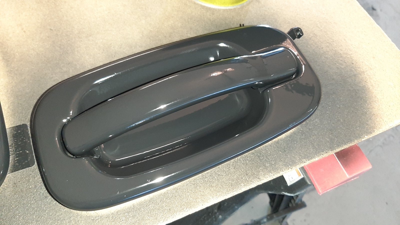

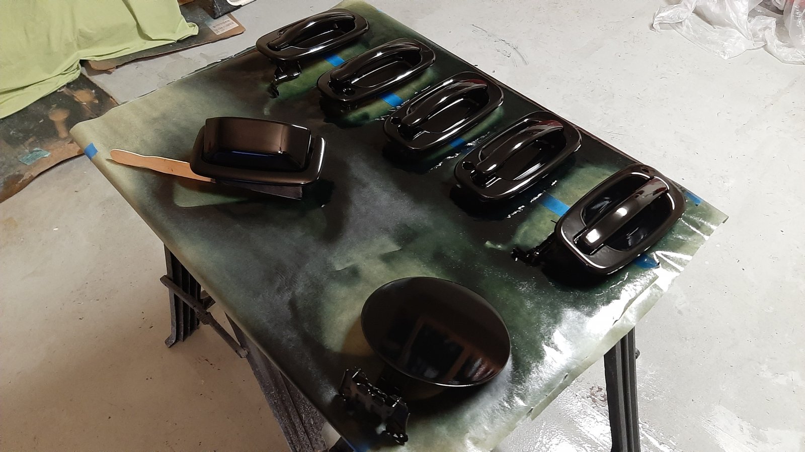

This paint job is an absolute nightmare. I've tried hiring a couple people to come to my house and help me spray. They never show up.
I need my truck finished for vacation in 2 weeks. So I tried painting some more on my own. No go, I got fish eyes all over the parts I practiced on.
I had cleaned the parts twice with grease and wax remover. Followed by blowing them off. Followed by spraying them. Still got nasty fish eyes :(
It was the door handles and gas cap cover. I'm going to leave the door handles as a flat finish now with just the epoxy sealer on them.

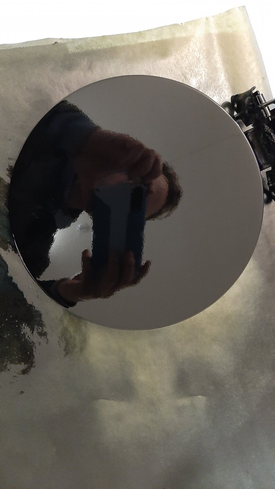

Okay, so I made some progress!!!! I cannot believe it. I have been interviewing body shop guys... Most are more willing to share tips than take on the job. I took in my gas door with me while chatting with local body shop. He said it looked like (1) I had too much pressure on the gun which created waves in finish and (2) I didn't allow enough flash time / dry time between coats. The short flash time created solvent pop and those little bubbles.
He told me an AWESOME trick that 100+ hours of youtube hasn't taught me yet about body work... Wait for epoxy sealer to dry 1 day or so. Wet sand it with 800 grit. Pure water no soap or anything... just the water and paper.
It PERFECTLY cleaned up the defects in the gas door. I then took my new found confidence and tried to seal a door. It worked! Minus one question... I'm not sure how much hiding I need to achieve before applying color. I photoshopped the picture below to bring out contrast. The finish isn't a perfect flat color / finish. Some of the work from below seems to show through yet.
It has two coats. One pretty quick / dry - sprayed vertically. The second dry to medium - sprayed horizontally with 50% overlap.
NOTE: bottom of door is getting a truck bed liner so not being painted now.

Awesome progress man!!! Sounds like the tips he gave you were spot on!

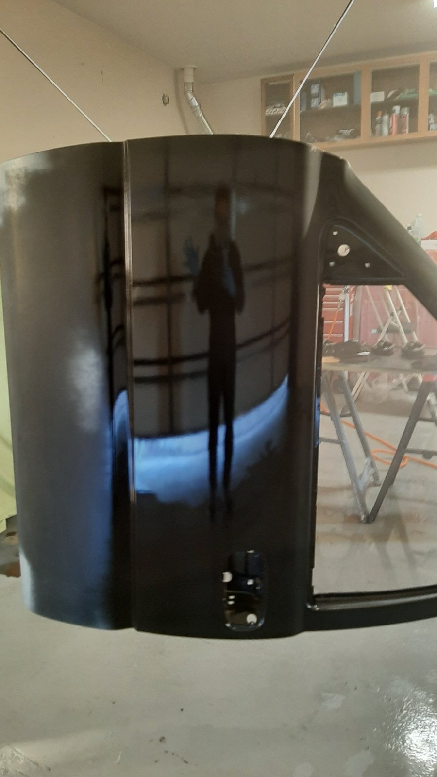

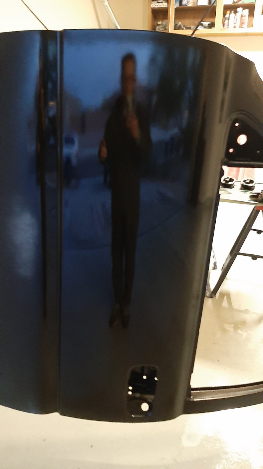

Oh wow oh wow oh wow lol My first practice door turned out AWESOME so far... I haven't done any color sanding, not for sure if I will as is an off road truck but I bought all the supplies and tools to color sand. Honestly, this is soooooooo technical and hard. I don't think there's any way to not mess this up as a newbie. You have to pay 100% attention to EVERY detail. Temperature, pot life / time, flash time, max flash time, cleanliness of parts, cleanliness of gun, remembering to remove seal vent from reservoir on gun. Those are just a few of the things I messed up so far.
- clean like 4 or 5 times prior to painting Windex, grease and wax remover, grease and wax remover again, blow off, tack cloth, then blow off with spray gun again and spray paint.
I followed up on my epoxy seal coat from 3 days ago. First I applied color coat, then my clear.
I had a spot in the color that didn't adhere properly. You could see surface below it. Unfortunately, I didn't take a pciture of it. The paint shop recommended waiting an hour for it to dry. Then wet sanding it with 400+ grit sand paper. Once removed color coat that spot again. Worked like a champ!
Then clear was a bit trickier. I messed up a bit as in, I'm not for sure why I got the amount of orange peal I did. Although The orange peal is perfectly acceptable to me. I did notice I forgot to remove the reservoir vent cap prior to applying first coat which maybe didn't let it flow out as well?
First clear coat was very orange pealie. I was honestly swearing when I saw it. However, second coat I went slower and overlapped a good 50%. It layed out nicely!
Honestly, really excited about this.

**** yeah man!! After all the research, buying parts / products, aggravations, effort... I’m so glad it’s coming together for you!

thanks, I missed a few spots lol
noticed this morning i missed edge of door as well... but heck, will look much better than before :)
