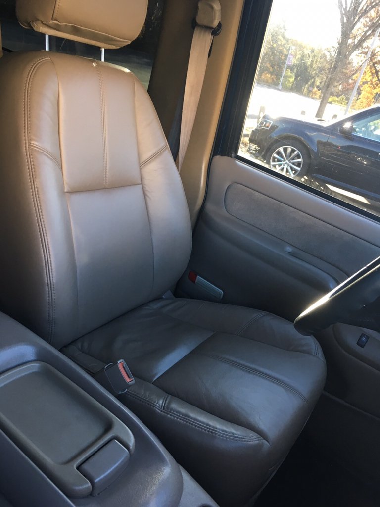

If you don't mind me backing up a bit here, I'm curious about your seats. Do you have pictures of them installed? What did you have to do to install them in your truck (mine's a '95)?
Thanks,
joe
T
Toomanyhobbies
Sep 18, 2017
139
139
Thanks,
joe

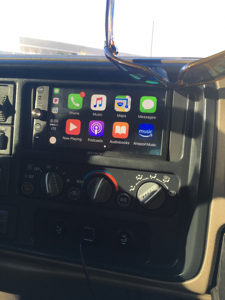

Here's a shot of the driver's seat. The GMT900 seats are mounted on the original seat frames. I didn't do this work so I can't say what was involved, and it's not possible to take a decent picture of it, but as far as I can tell the most the upholstery guy had to do was drill a few holes in the steel runners under the seats to mount them to the old frames. And for another $500, he was able to install seat heaters and put the switches and a USB cord in the dash where the CD player used to be.
Hope this helps
Hope this helps
It does. Thanks.
joe
