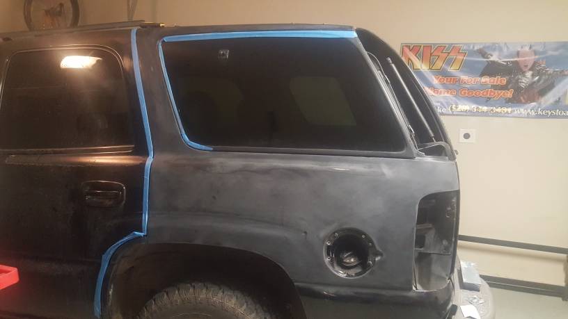

I have some questions about prepping the truck for paint. First my strategy is to paint panel by panel as I get my technique down.

  • 2:40 Clear coat damage goes into the seam around the rear quarter panel window. How do I remove that window?

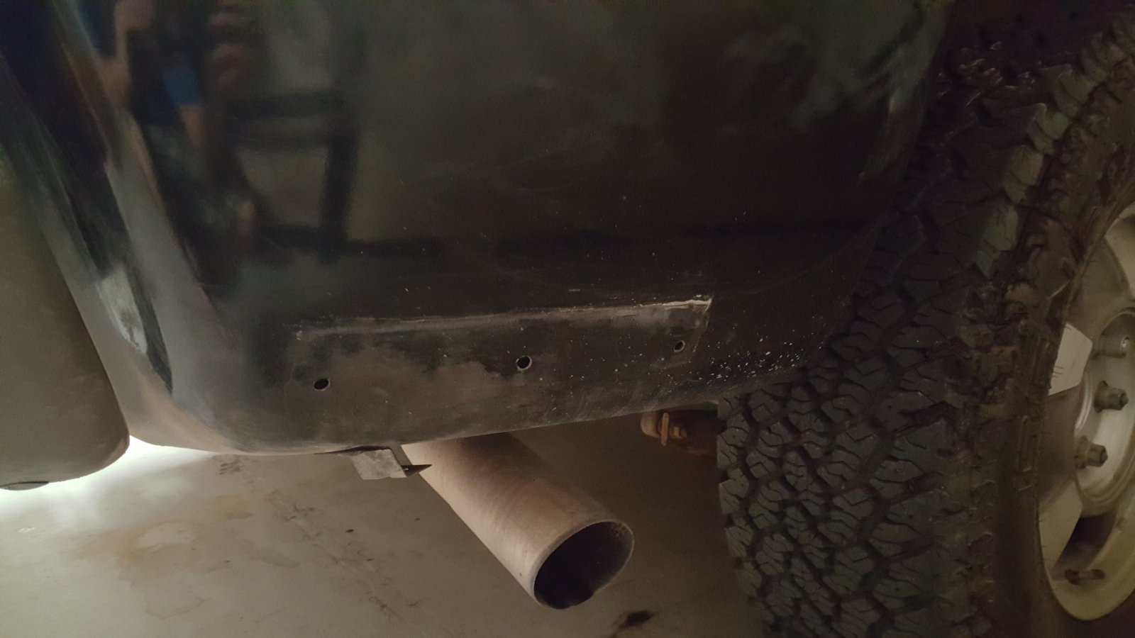

  • Bottom of right rear quarter panel has a crease where old trim attached. However, I have no way to get a dolly back there. Any tips to clean that up? Picture below, I forgot to get it in the video.

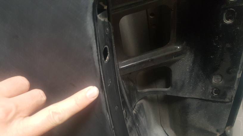

Drywall damage wraps around and into the seam with quarter panel glass. Not sure how to clean that up without removing the window and not sure how to remove the window.

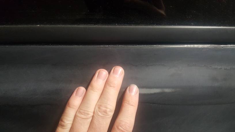

There is a crease in the body panel at bottom there (along gray line). I'd love to get it pulled out, however, I cannot get a dolly or anything behind there as a second piece of metal is blocking access. There is a small rubber plug there but not sure I can get tools in side that void. Any tips? Or does this have to be repaired with body filler?

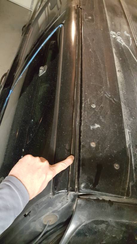

One thing that is annoying me rt now is the roof drip molding. Mine is im horrible shape. I found where to buy new but cannot figure out how to remove the old.

The roof rail moulding is 2 sided taped in. You are talking about what you are calling the gutter? If so just get a screwdriver (flat blade) , get a corner to start to lift , grab it with you hands a start to pull it up. careful you don't fall off the ladder.

This is the part I am referring to in picture below. It is crumbling appart. I may try and salvage ones at junkyard (they have a bunch of tahoes and yukons of this bodytype). Otherwise is 80$ each.

Yeah if the moulding is that brittle get new ones , its just 2 sided tape holding it there.
