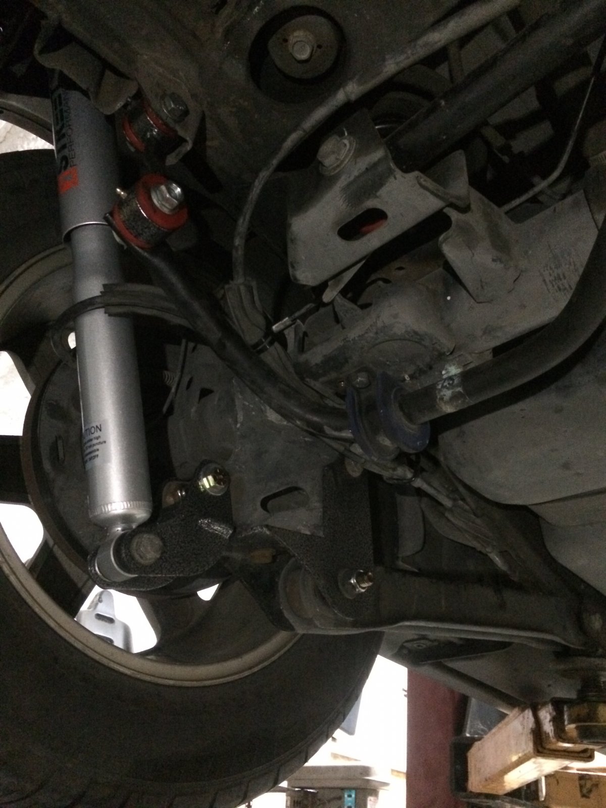

Nothing to roast you for! Really, I'm just glad you're getting somewhere and I'm very intrigued about what you have goin on. I wonder if the cables are routed differently on the K2xx than they are on the GT900. One wraps around the driver's side shock and, with shock extenders, it rubs the shock body a little since the extenders swing the shocks towards the back about two inches. I wonder if it's even tighter on your rig and it's tugging. I rerouted my cables slightly for more clearance and slack.
I don't know how this compares to yours, but I thought it'd be very similar. My cables are now routed above the sway bar but still below the axle. It only barely rubs the shock body, and maybe not at all when it's on the ground:

honestly the biggest amount of noise came from a bracket where two cables meet on frame rail near the driver side passenger door area. I think that might be were the main cable connects to the left/right cable that then go to each side of the axle. I will be investigating more when I get home and try to wrap any area of concern and test again.

Sounds very similar to how mine is setup. Actually, that's where I unhooked the cables to re-route them. Something's not right. It's gotta be pulling on the cables, possibly partially engaging and disengaging the e-brake as the suspension cycles.

I do believe my noise was from the Emergency brake cable. After securing the hell out of the cable I dont hear my noise anymore
