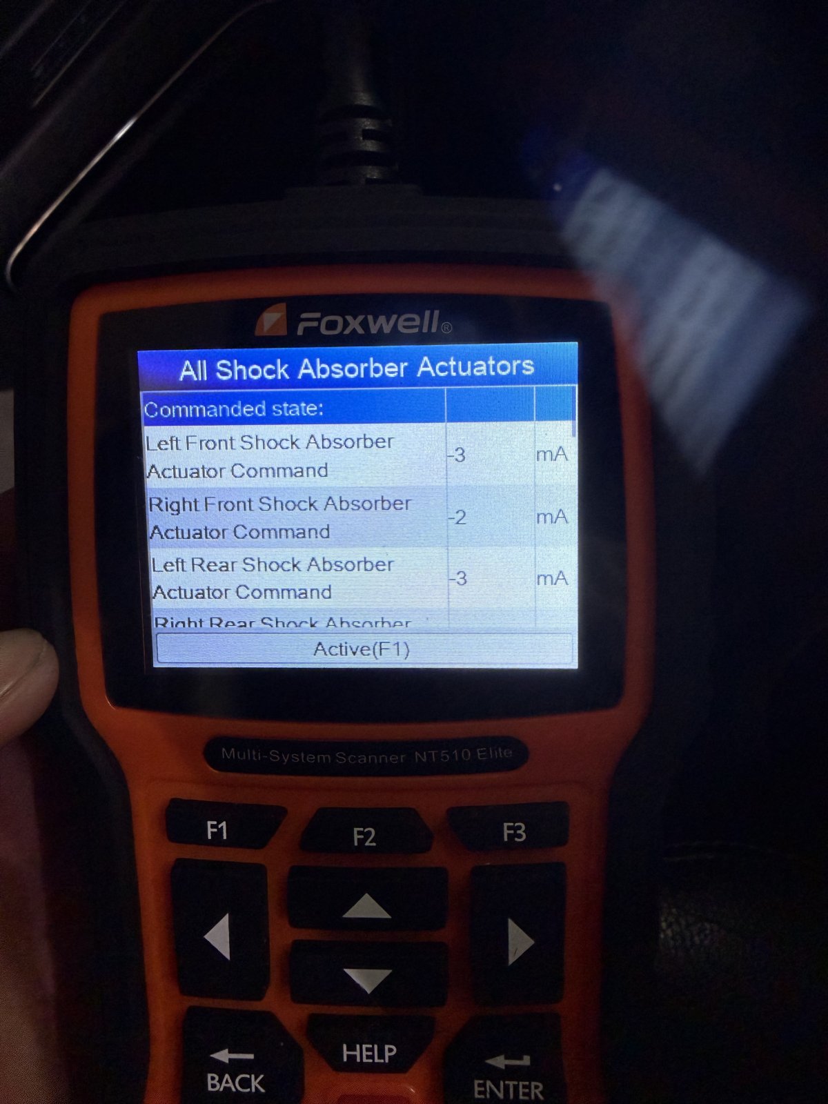

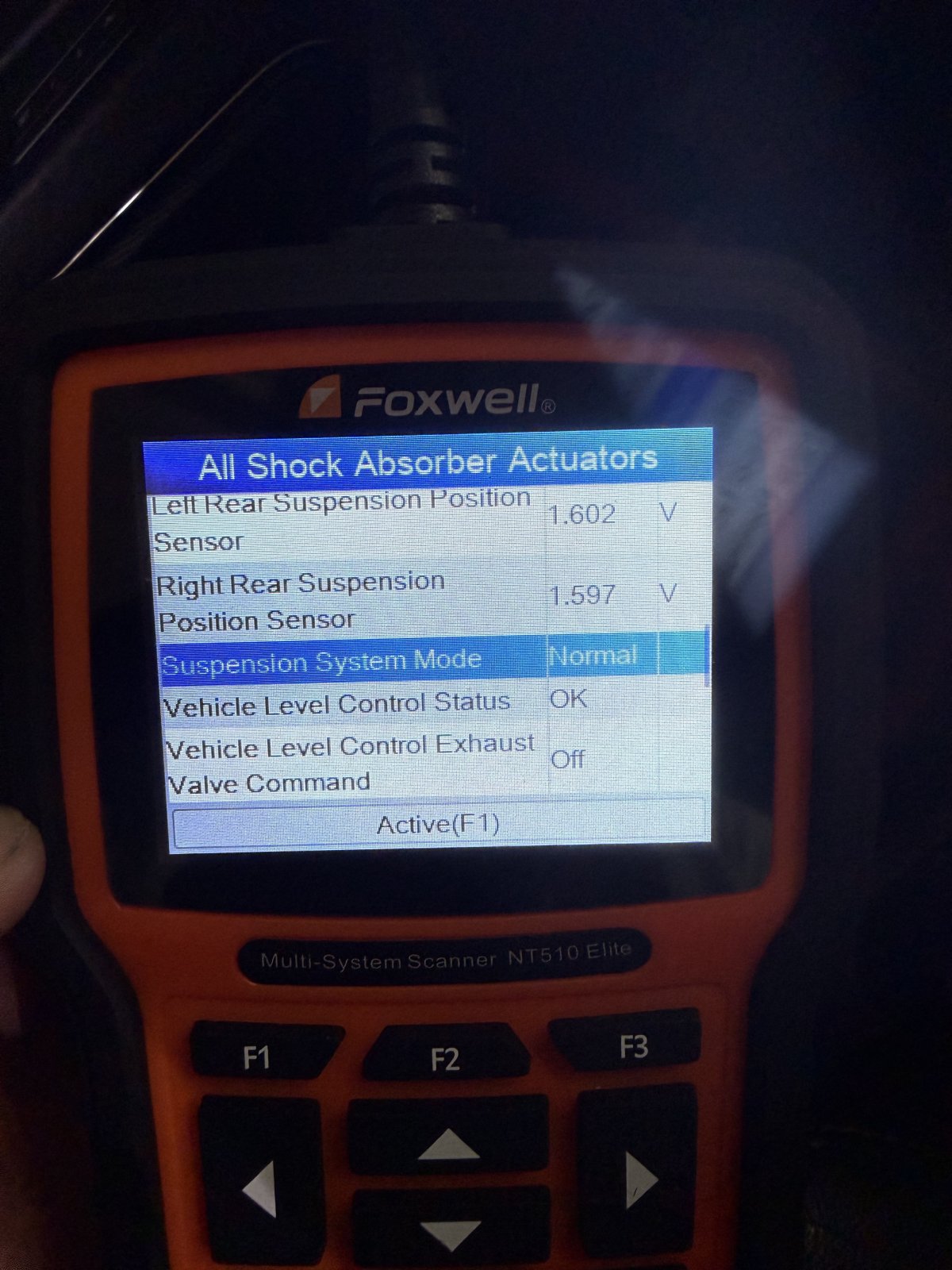

Last Thursday I replaced all the shocks with OEM. The ones I pulled out were leaking like a sieve and I thought, wow the ride is going to be so much better with fresh OEM magneride shocks. Low and behold, the ride didn't change at all still has stiff and bumpy as it was. So I took out my trusty Foxwell NT510 Elite to recalibrate it. There is a setting in there titled "Suspension System Mode" and mine was originally set to "Sport". After I recalibrated it, it is now defaulted to "Normal" and I can't figure out how to change it again with this scanner.
I feel like this may have softened up the ride slightly but not enough for me to rule out placebo. If I didn't know I had switched it from sport to normal I likely wouldn't have felt any difference. On the scanner I can see the live mA going to each shock and they all hover around 0 to -10 mA while stationary and then jump all around to positve numbers with the front being similar and the back being similar. Everything appears to be getting and receiving commands as it should.
