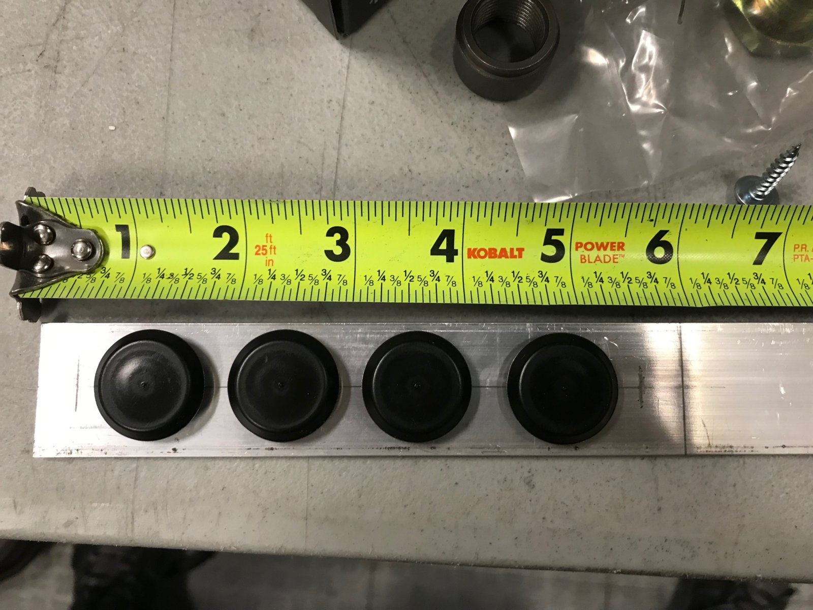

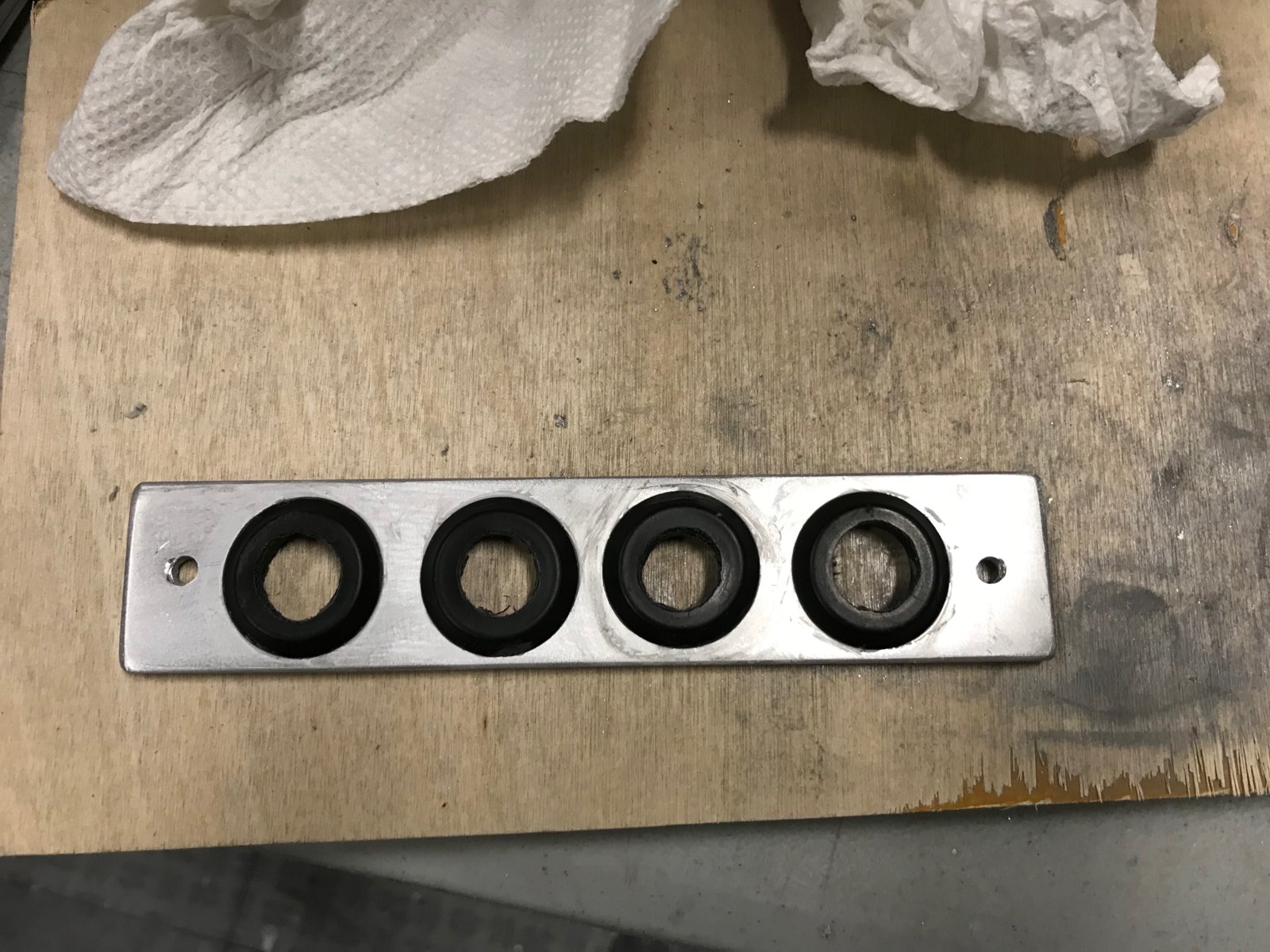

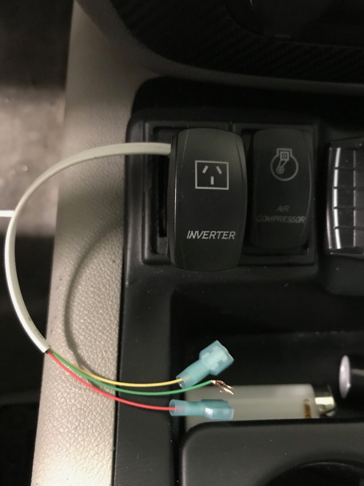

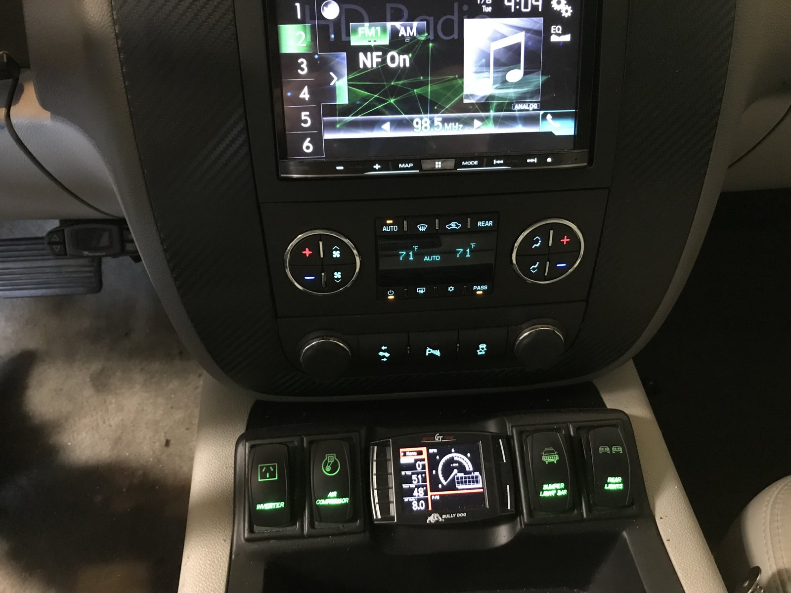

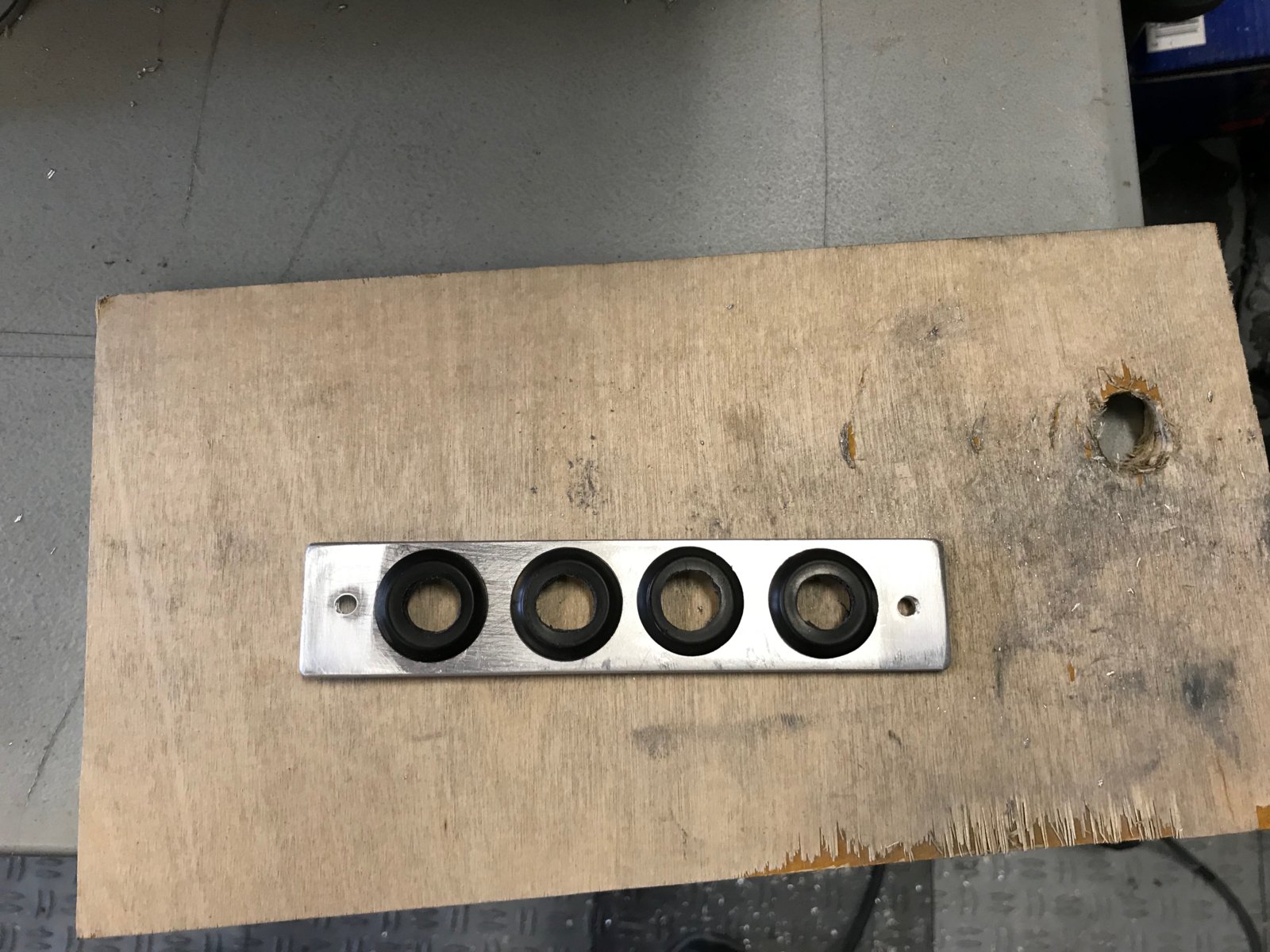

Ok, here it goes 2ND part. INVERTER INSTALLATION.
1.external switch install for inverter.

I had an Inverter installed in my work truck at a 2 way shop. They used a relay for the power line. i think this way the box wont come on w/o the Ignition... I wanted to see the way they did it but the wires are pretty well hidden. Was the relay hard to wire in?
Chrismnj
Chrismnj
Sep 17, 2015
1,227
2,121
NJ

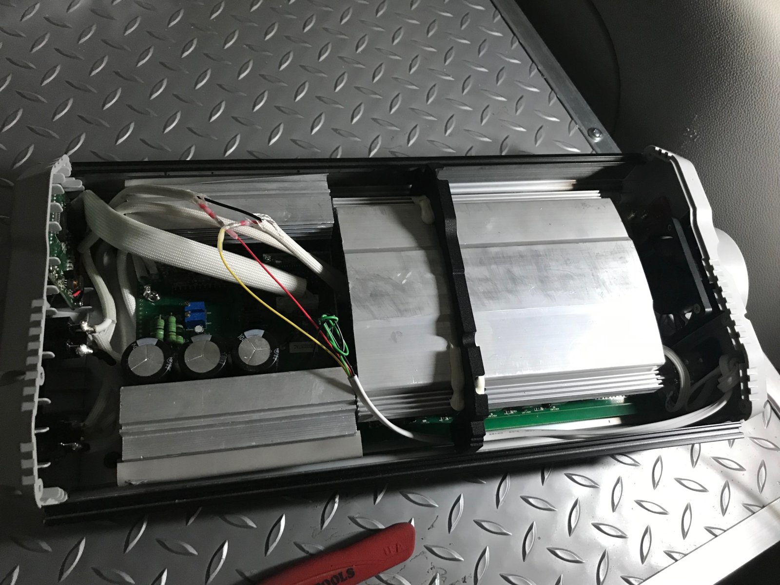

I have connected to existing switch in the unit.

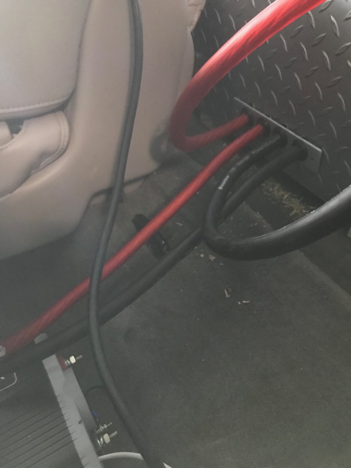

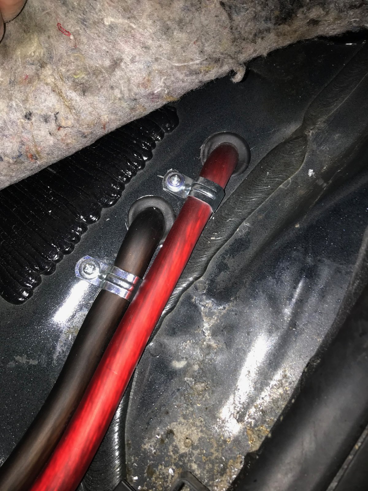

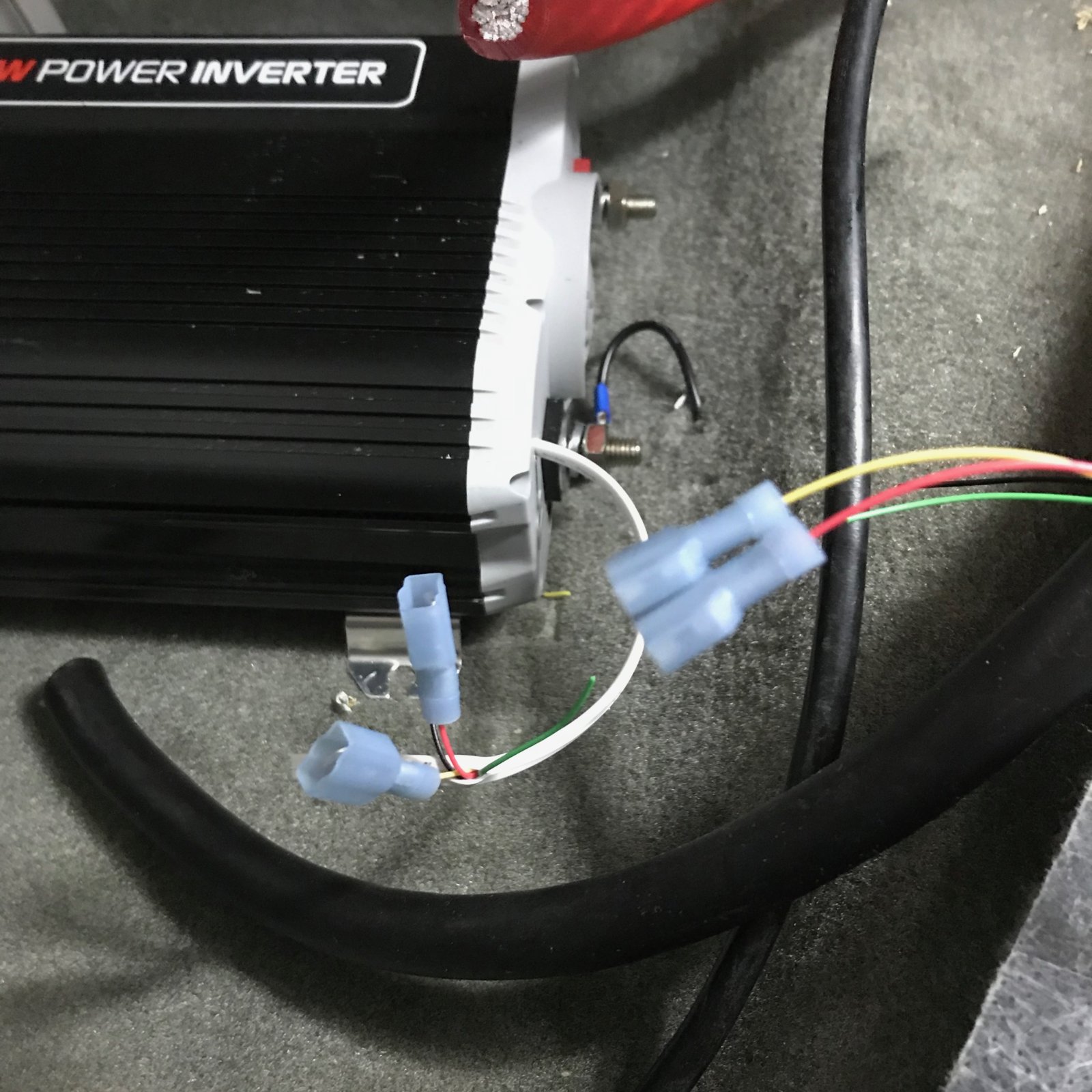

all wires are through the box

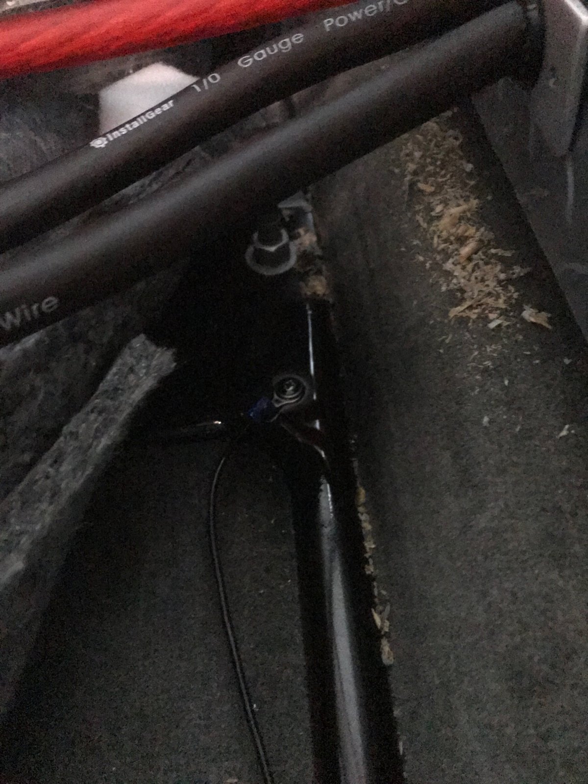

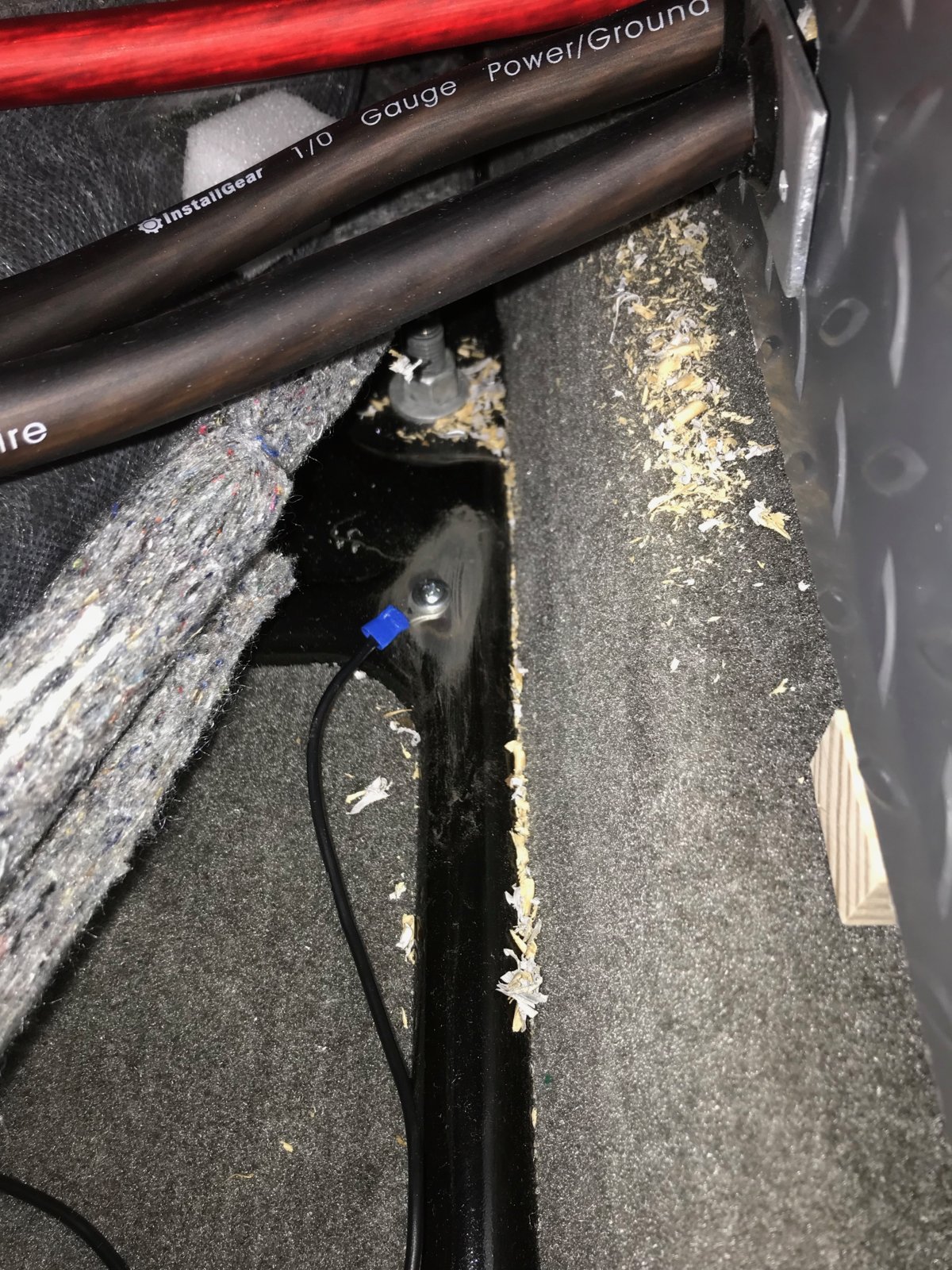

ground wire for inverter
switch connection
45,016
Are you serious about that ground? I feel like I must've misunderstood something because you seem to know your stuff electrically everywhere else, including doing the multiple batteries, Big 3 upgrade, etc. But that ground for the inverter...
Chrismnj
Chrismnj
Sep 17, 2015
1,227
2,121
NJ
for some reason inverters on board remote switch doesn't work without external ground just the way manufacture wired in, and I am doing 3 way switch on that, on the other hand more ground points win win

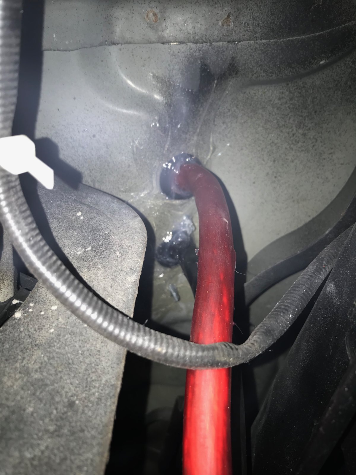

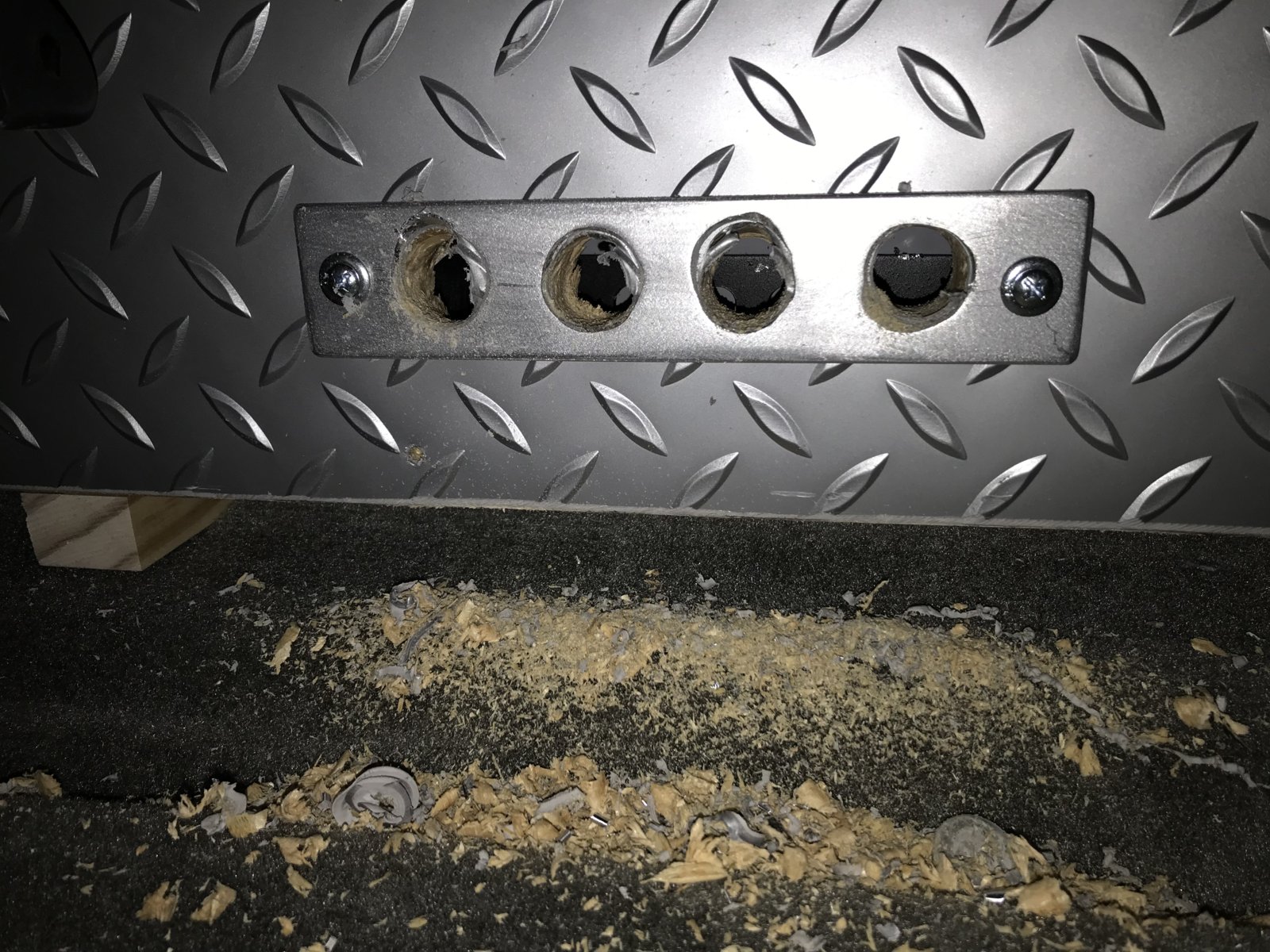

going under the truck with wires.
45,016
I thought you were grounding the inverter on the battery lug with that tiny wire instead of the 0 gauge.
Looking back at your other pic, I see that there's a small ground lug and that's what you attached it to. The pic in post #61 looks like you grounded it on that main lug. It's just the angle of the pic. Carry on!

look from under, I did put automotive silicone around
