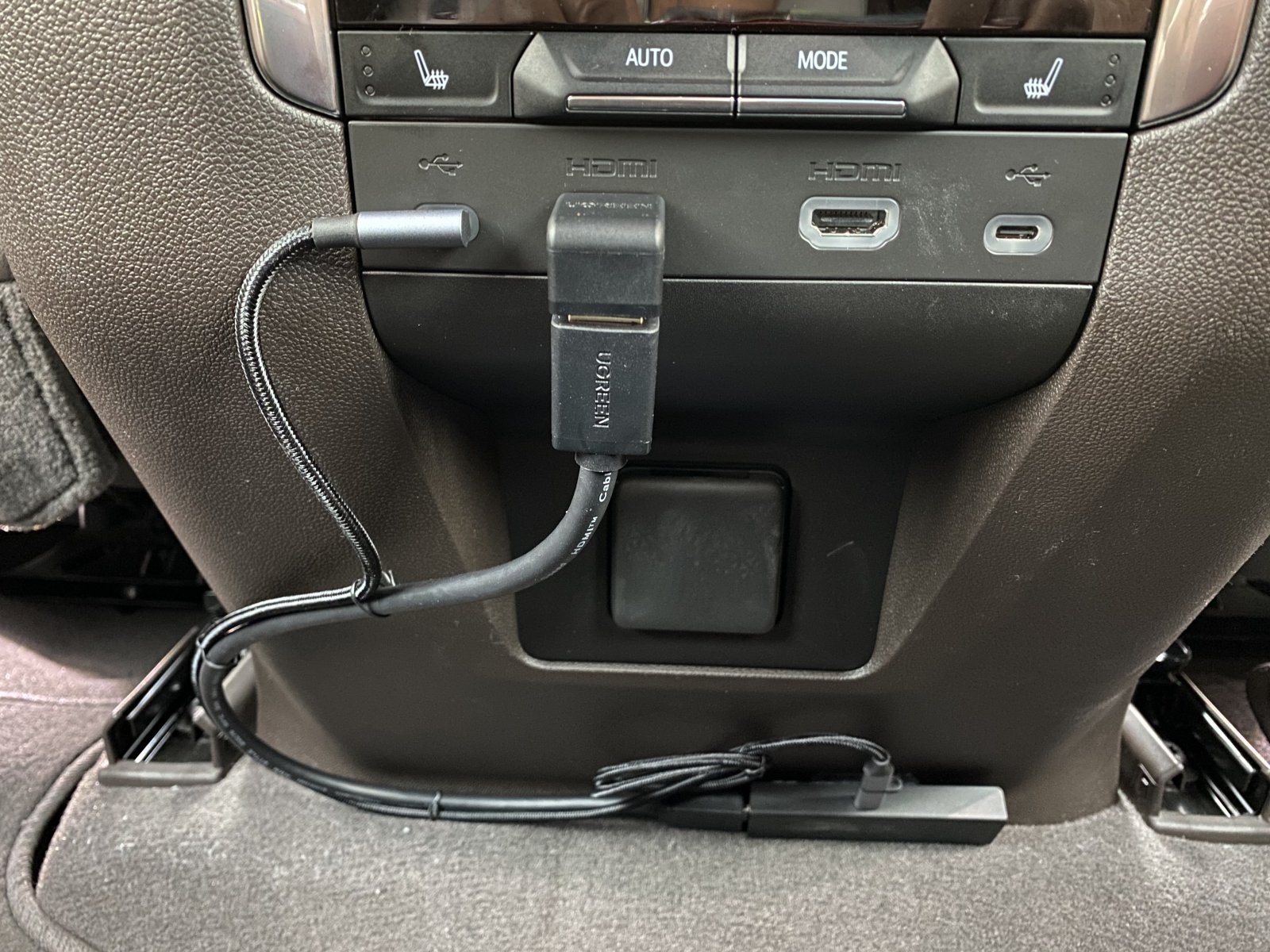

Do you mind posting a link to those exact cables you purchased? I can't find any online that look that perfect!

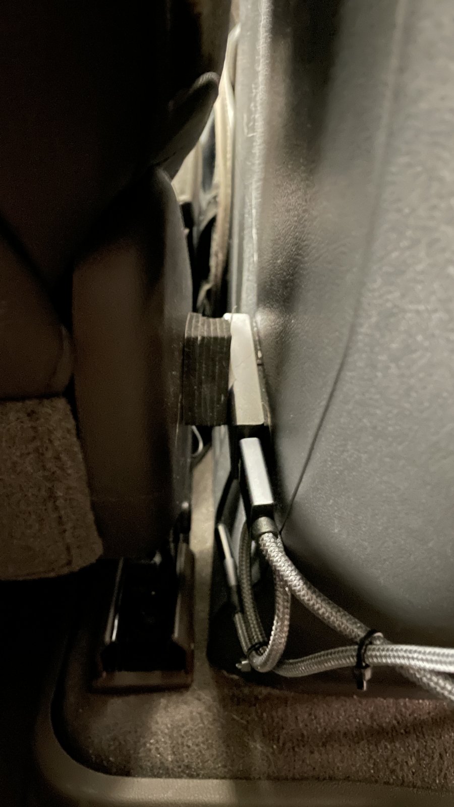

Ya. I will get the links. The biggest issue I has was the adhesive pads. The fire sticks are not left hand and right hand. I had to twist a cable and it wanted to pull it off. But over time I think I forced it to stay. I used a few of the extra pads and made a wedge between the seats until it stayed.

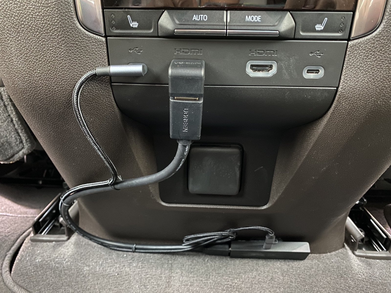

This is the angle hdmi cord
This is angle usb c cable
this is usb-c to micro usb for the fire stick power.
With this setup you do get a warning for low power on the fire sticks but they seem to work just fine and they don’t durn off if you forget to turn off the auto stop/start button.

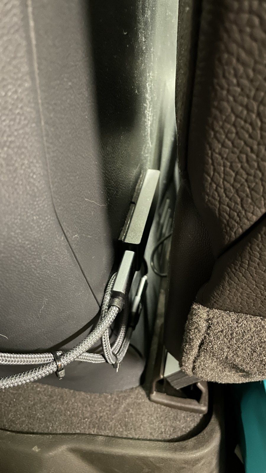

This side worked fine. The other side I wedged liked in the picture until the braided wire lost it’s memory and did not try to pull it off.
