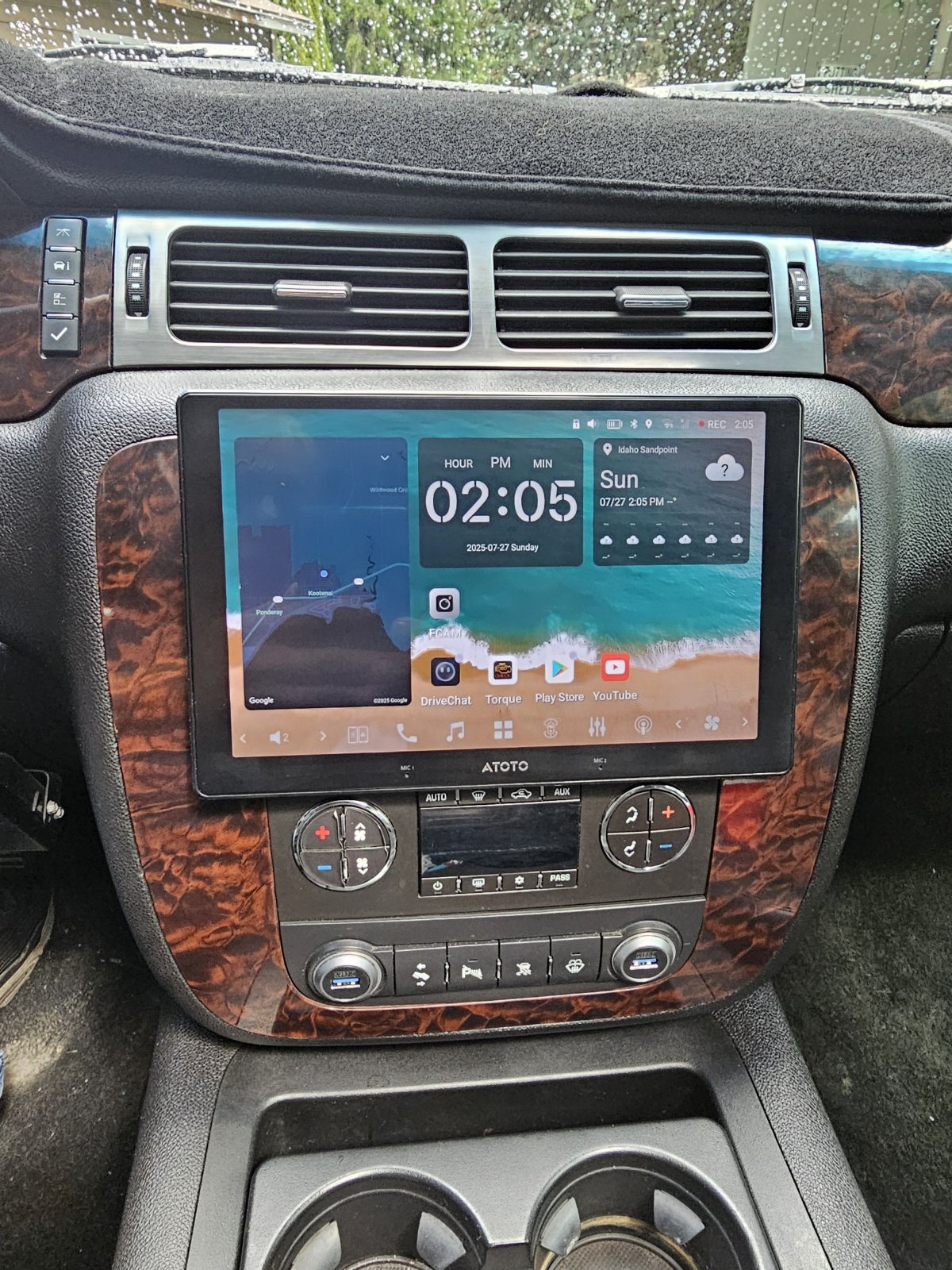

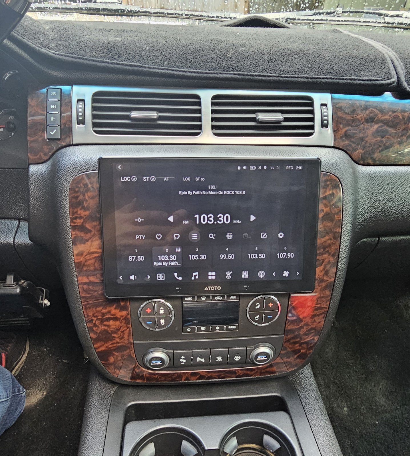

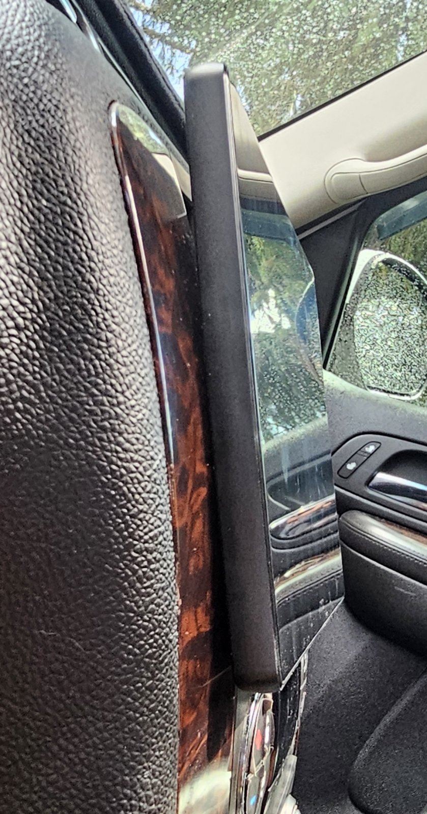

Finished getting it installed. Everything is working as it should that the PAC interface advertised to do.
I did not get to mess with it much today after finishing up, but i can say. It is an improvement over the stock radio.
Fuller or richer i don't know but it is an improvement for sure.
Over the next week or two, i'll be able to learn all the settings and get it dialed in to my liking.

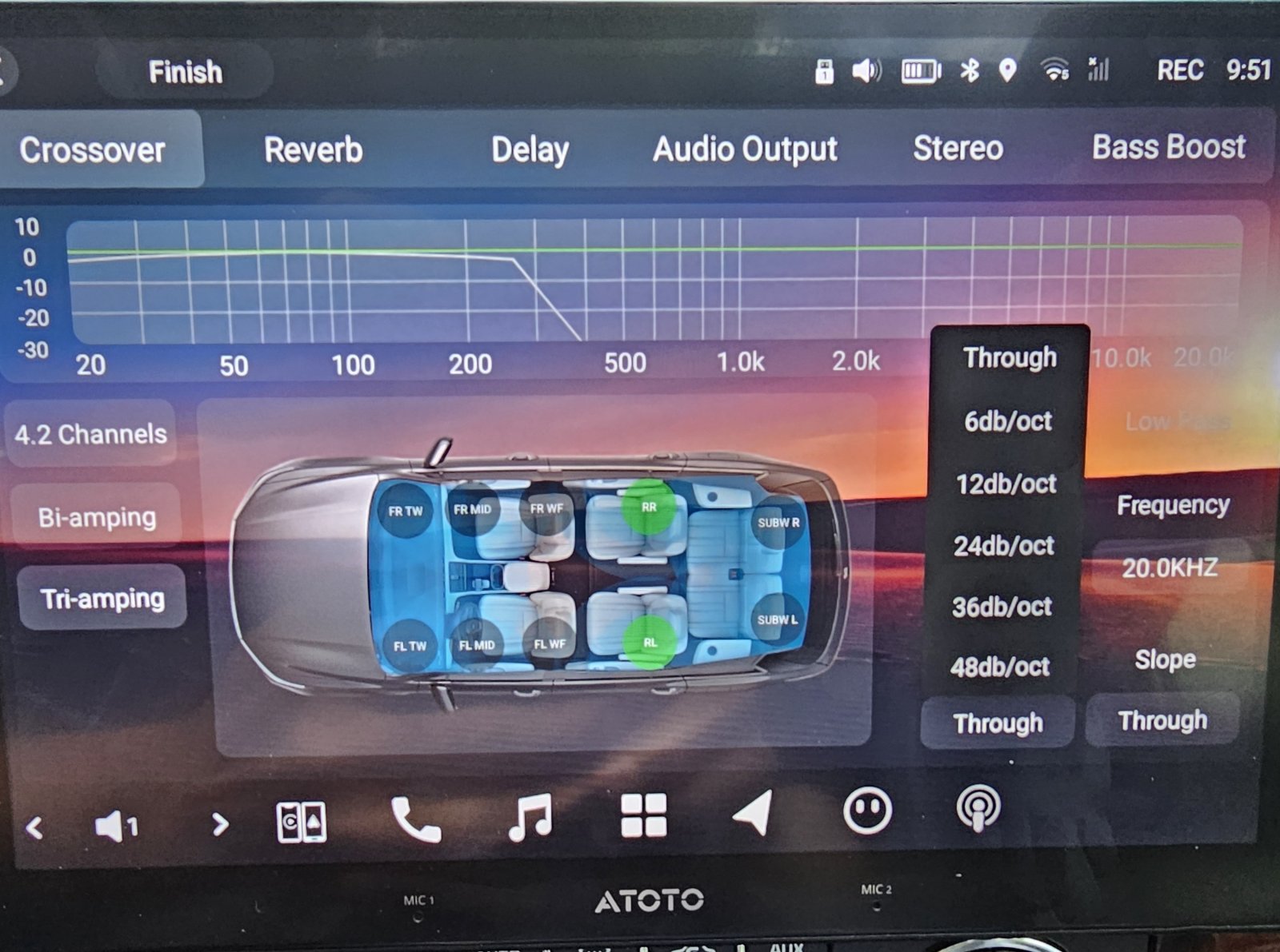

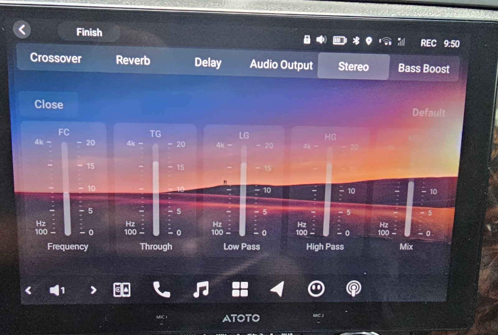

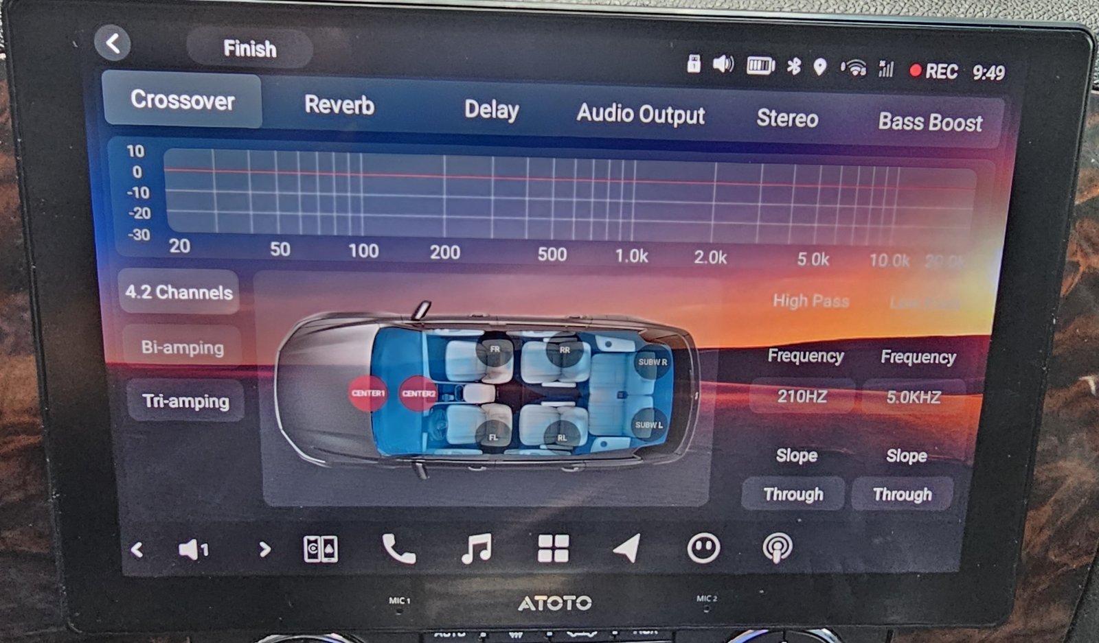

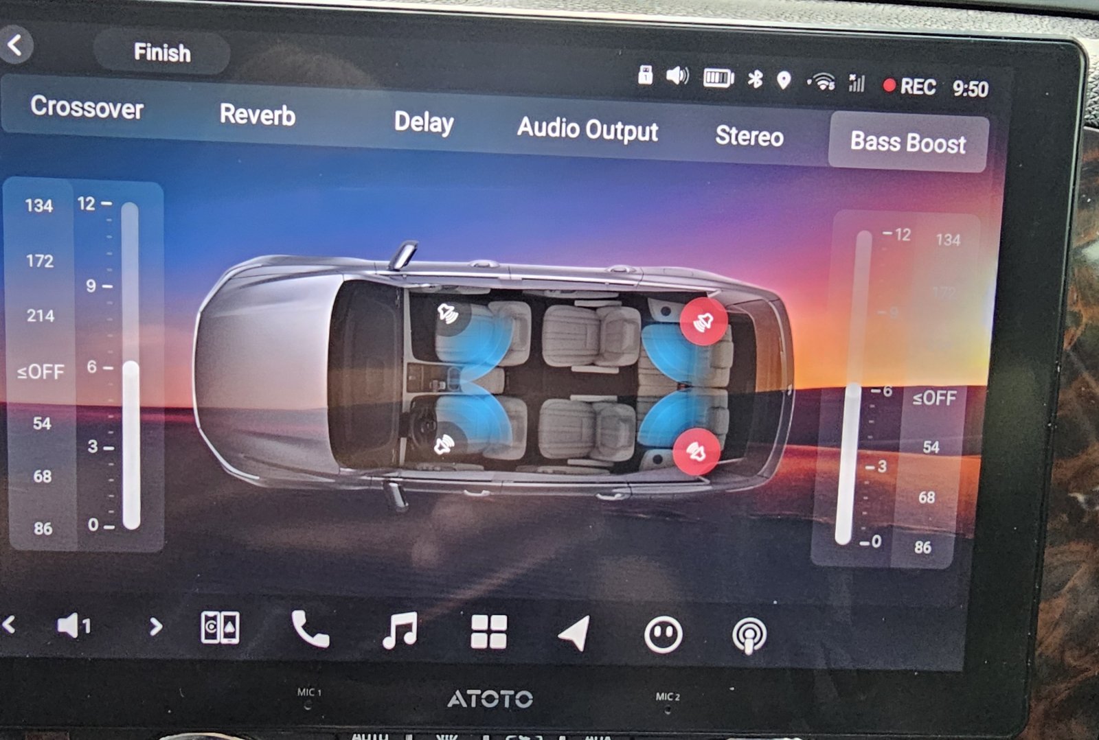

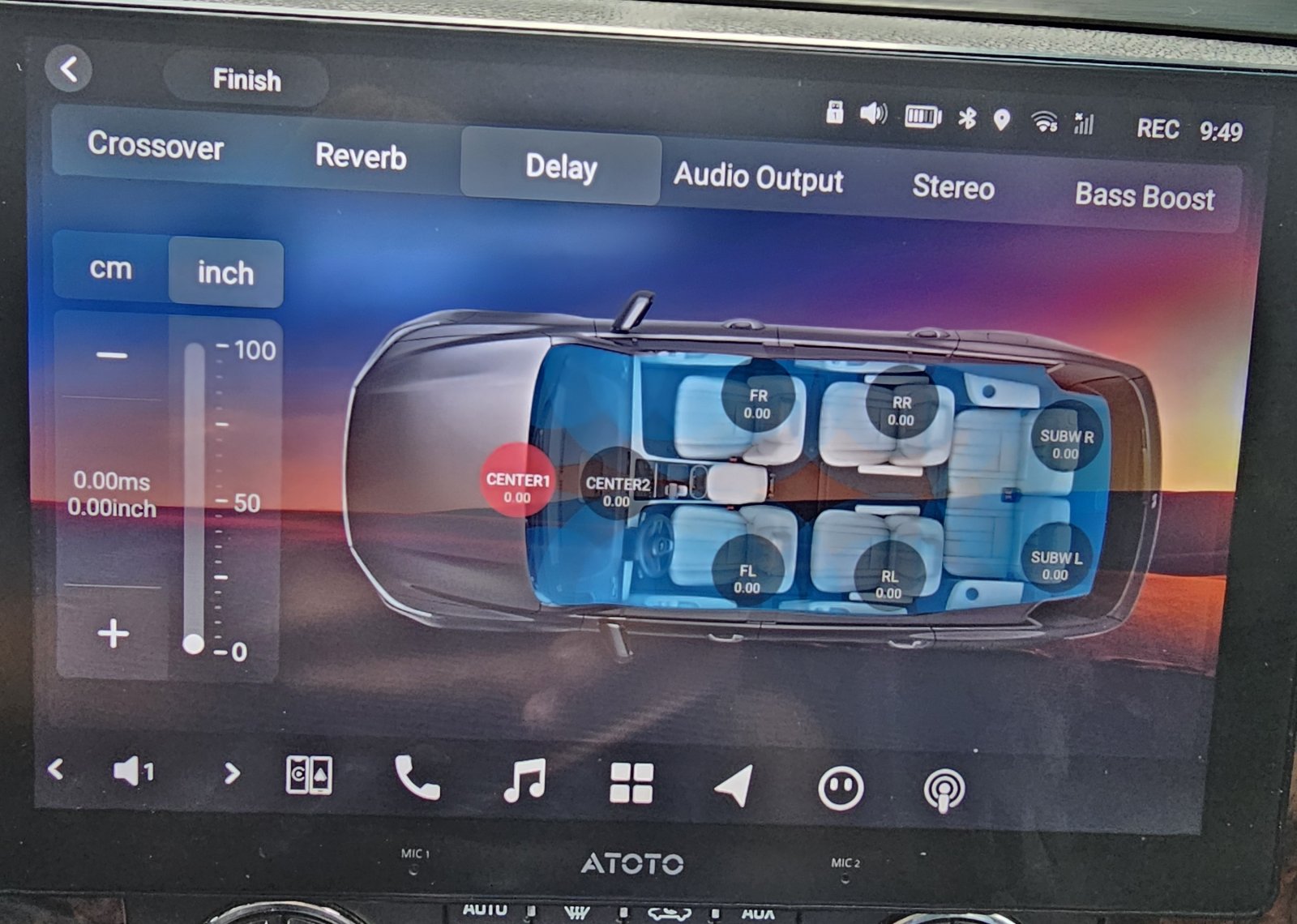

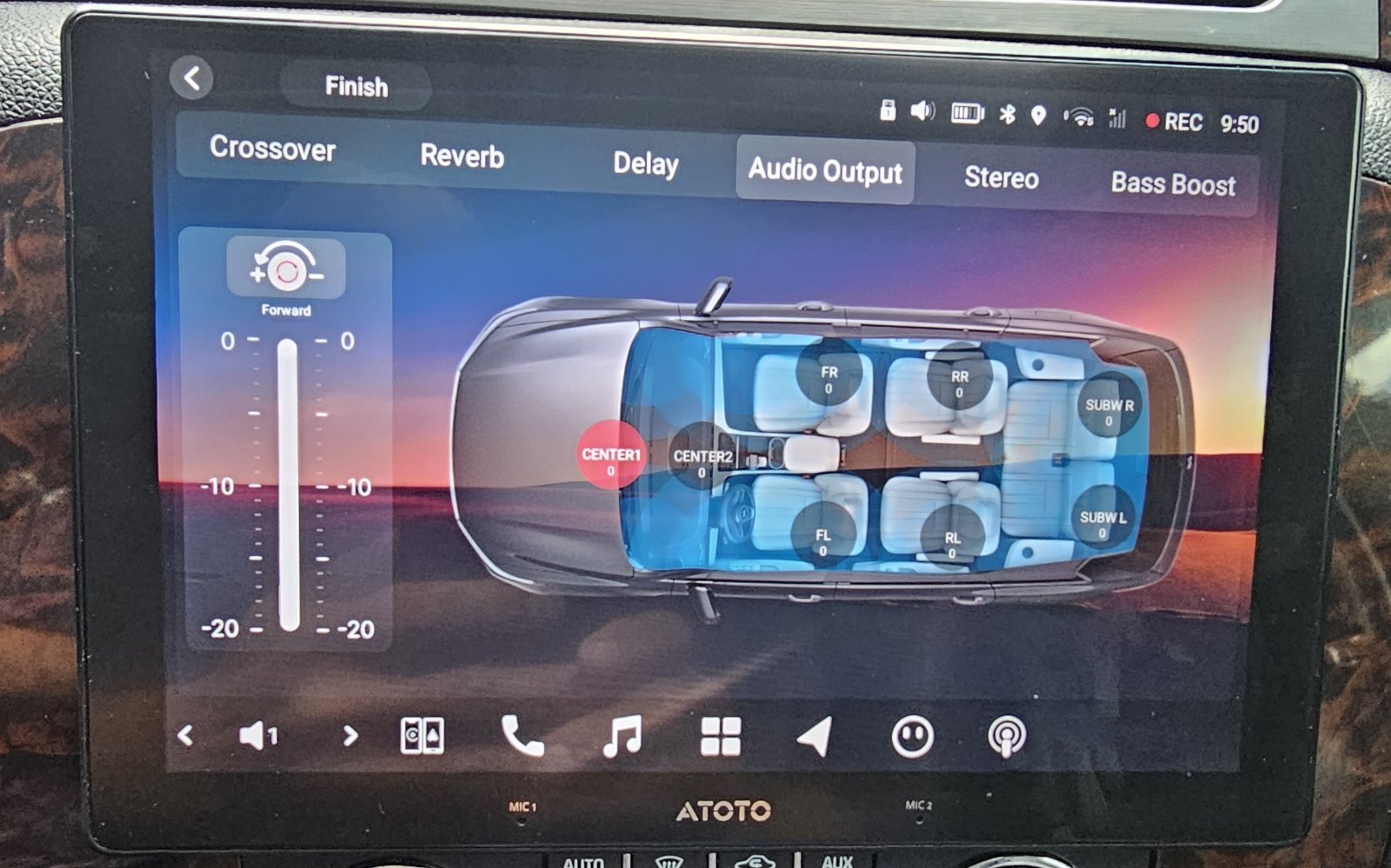

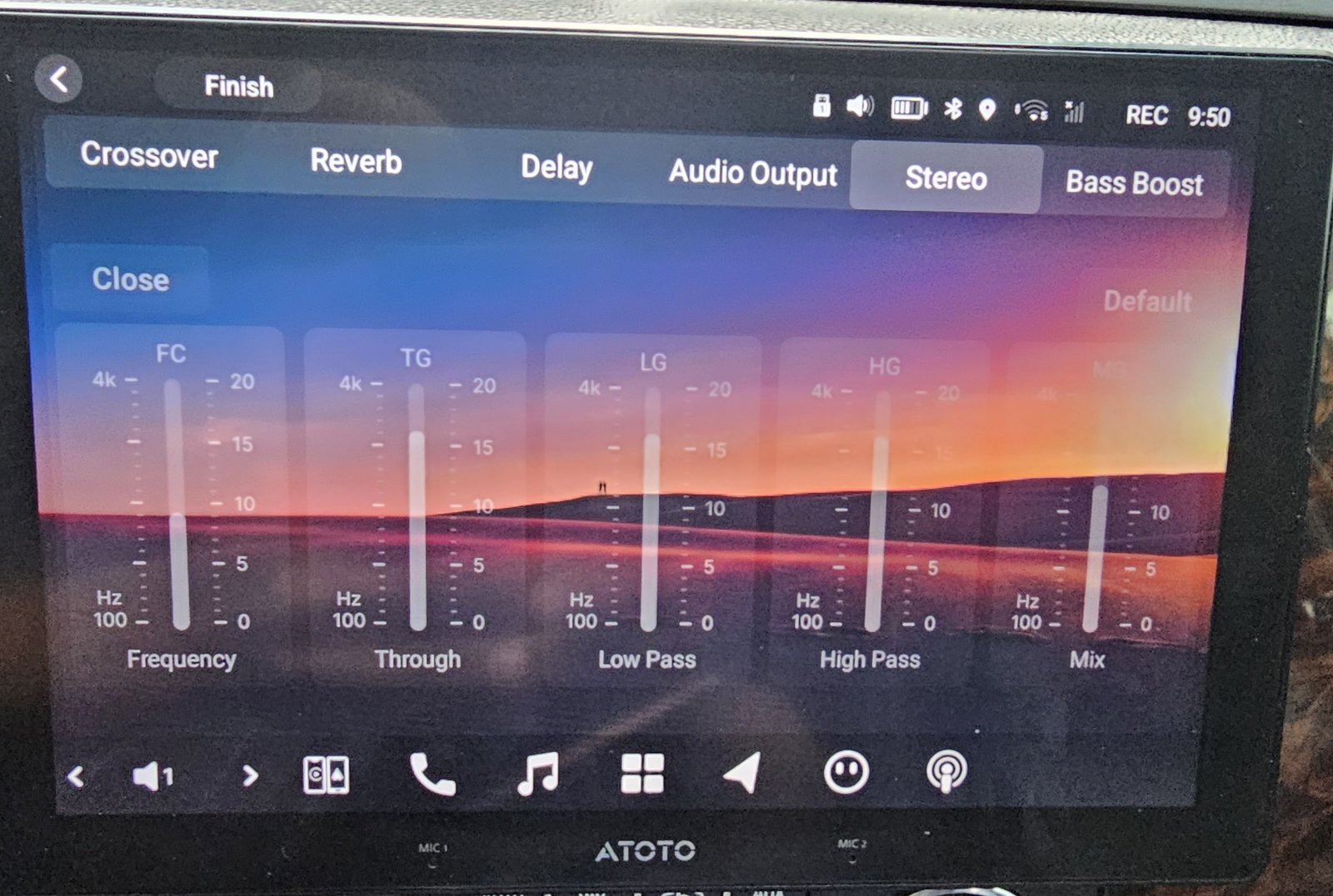

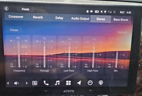

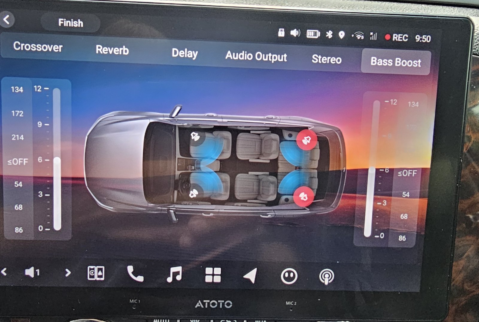

Here are some more pics. Have no idea what it all does.
The stereo itself has normal Pioneer style speaker outputs that im using now. Actually out of the box with no tweaks sounds decent.
It also has RCA outputs for LR Tweeter, LR Mid, LR bass.
Most of this probably will not do a thing hooked to the Bose amp but it does have future upgrades for sure.
20250728_094943.jpg20250728_094958.jpg20250728_095012.jpg20250728_095023.jpg20250728_095037(0).jpg20250728_095119.jpg

View attachment 463593View attachment 463594View attachment 463595View attachment 463596View attachment 463597View attachment 463598
This post reinforces the wisdom of fine-tuning in a slow, patient manner. Making notes might be a good idea.
