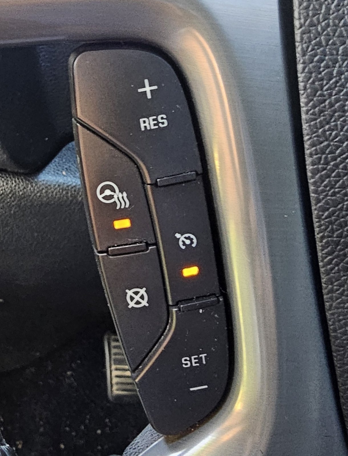

Anyway, got the Power bass speakers in the doors but did not change the tweeters out yet though. Sounds way better than the old stock speakers.
Also got the heated steering wheel hooked up and wired to the factory location. Making progress, slow but sure.

More pictures of the wheel!
I'm curious if the padding is thicker than un-heated...
Feels about the same to me for diameter, but the old wheel feels solid when griping it. The heated wheel feels almost like there is a small amount of padding under the leather.

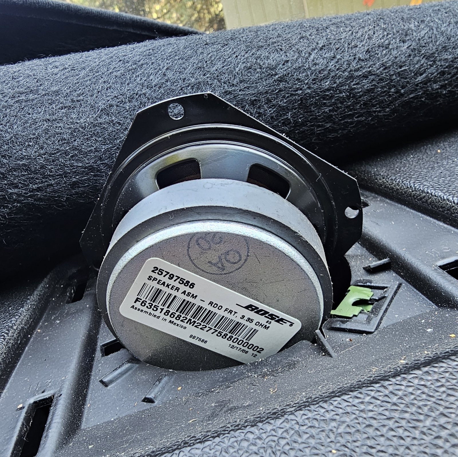

I know the center dash speaker is 3.5in but i can't find any info on the ohm rating. I would imagine after 18 years it's probably shot and want to replace it.
Anyone know the ohm rating of that speaker?

Not gm oem bose systems. I think other manufactures also use weird ohm ratings for the oem systems.
30,701
48,340
that cover comes with off and then it's just 4 screws and you can look on the bottom (sometimes there ink stamped with the ohm's) or just ohm test it with a meter

The center dash speaker is 3.35 ohm.
Trying to decide if it's worth replacing or unhooking it and forgetting about it.
