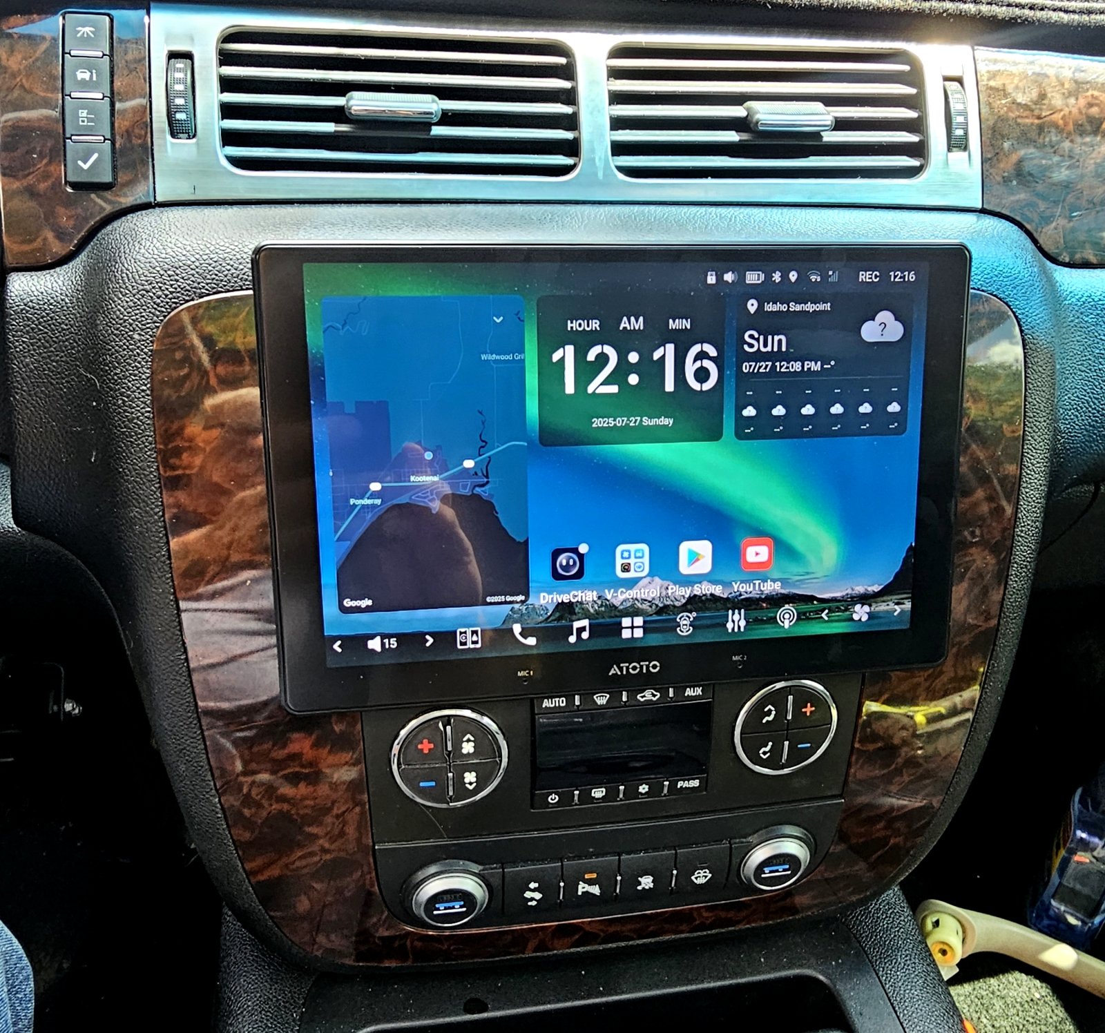

Here it is looking final install, but it's not.
I have to take it back out and turn the Bose amp gain up on the PAC interface. Did not think to check that before i put it in.View attachment 463551
Does the screen on yours slide up and down or is it fixed in place?
My hvac controls are above the radio and this looks like it would interfere unless the screen slides down

Not exactly slide.
The bracket's on each side have several holes to move up and down but i don't know if it would be enough down for your situation.
Atoto sells a single din X10 that i would think could go low enough?
I used the DD install option, i dunno why, but i was able to make it sit almost perfect.

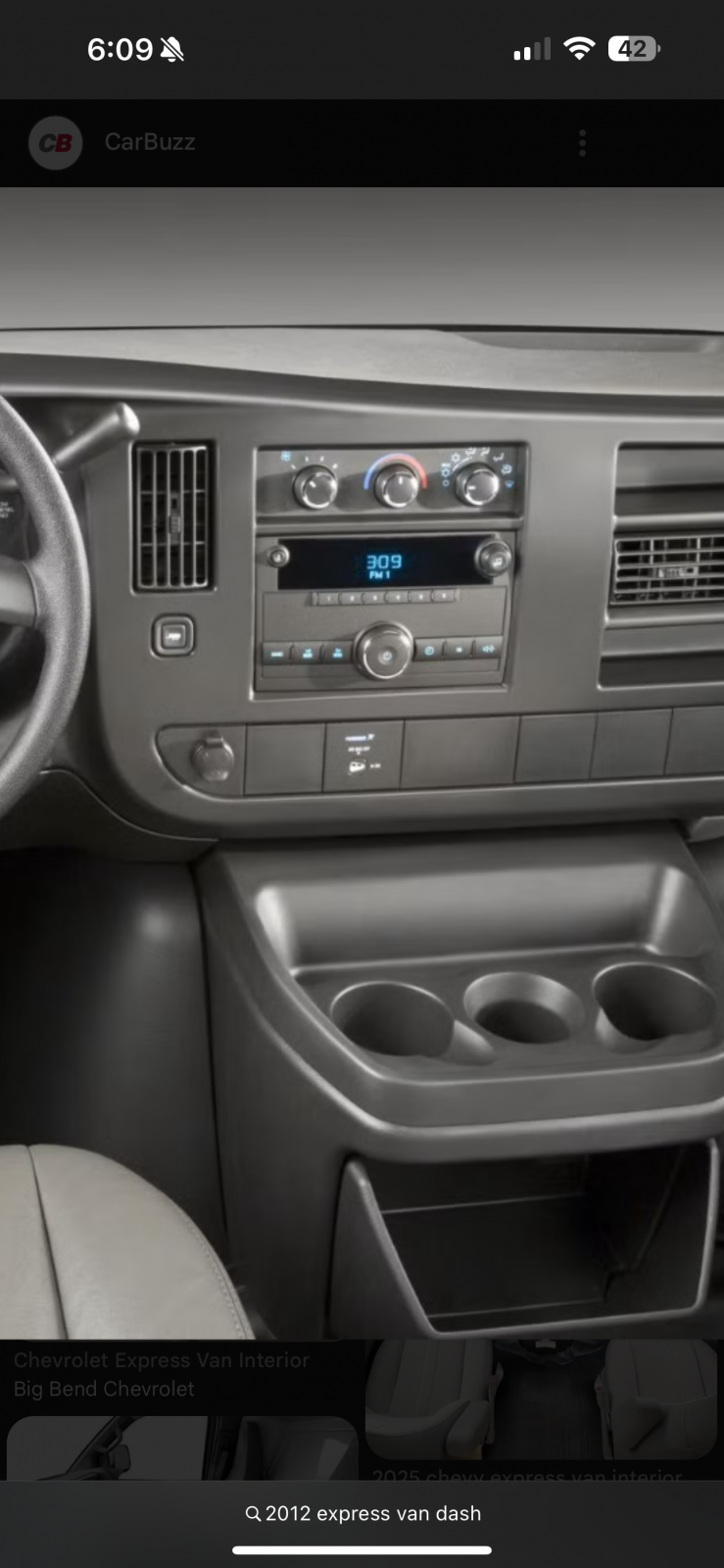

From looking at interior pics of 2015 Yukon's (if your sig is correct) i don't think a 10in screen would work?
Looks like you need a 7in or maybe a 9in version.
Tonyv__
Apr 18, 2018
4,473
10,417
Bucks county PA
Express van lol.
I’m leaning more towards the s8 but they offer it in 9 and 10”

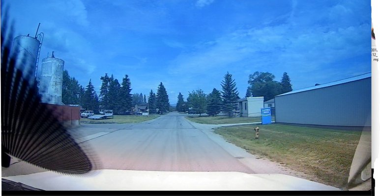

Totally spaced it. I did get the front cam with my X10. Pretty decent picture from all the ones i have seen. I'll try to post a screenshot in a little bit.

It records and if the shock sensor is tripped it locks the video. I am using a 128GB thumb drive.
Maybe ill post a vid so you can see.
The recorded videos are 1 minute at a time and slightly overlaps by a sec or two.
I do need to reposition my mounting point.
