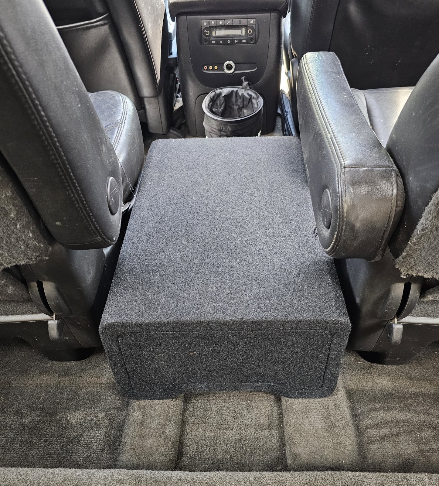

I just wrote this up for a fellow Forum member with the same question. This applies to 2nd row bucket seats, but I don't know if you have them. It may answer some of your questions, though, like where to put the amp.
The speaker wire has a high amperage quick release connector, and I keep a 10' speaker extension wire with matching connectors, so that I can (1) remove the subwoofer completely from the truck if I need that in-between space for something else, and (2) move the subwoofer around inside the truck with the speaker extension wire extension if I need to re-arrange cargo for some reason.
I use a 10" AudioMobile subwoofer, which is 100% American made, and it is designed specifically for small sealed enclosures of 1cu. ft. or less, without using the shallow mount inefficient pancake frame speaker design. This speaker has the same sound quality as the JL Audio W3 subwoofer (though not as much power handling capacity), but 30+% less expensive. I power this subwoofer with a Rockford Fosgate 500 RMS watt amp at 2 Ohms. The amp is located inside the left rear side panel, just forward of the spare tire jack area.
If you need any more information, let me know. Please excuse the white hair all over it, and my 90+ lb. White German Shepherd loves to lie on top of the subwoofer, with his paws on my legs, looking out the front windshield.

It sounds like you are good to go with the assembly of a subwoofer enclosure to fit between the 2nd row seats. If you want dimensions, I can provide you with the dimensions of my subwoofer enclosure.
Unless your current head unit has preamp output jacks for a subwoofer, you will have to splice into a left and right channel of your speaker wires, preferably front speakers. You can do this directly behind the head unit. Then run those wires to where you plan to install your subwoofer amp and connect the wires to the high level input on the amp. You will also have to run a power wire from your battery or main fuse to your amp, and make sure that you have an in-line fuse on that wire.
Looking forward to reading about your progress on this new project.

The reason i went with that one is because the space between the seats is about 14 1/4in and it fits perfectly with just a very tiny gap on each side.
Also, i wanted down firing so it would look like it belonged between the seats. We don't really have a problem with theft around here, but ya never know. Just looking in through the tinted windows you can't really see it clearly.

I have a Kicker 12 in a down firing box in the same location and I also installed the Kappas in the front doors for the same reason, they essentially match the factory ohm load to keep the Bose amp happy, I installed the Infinity Primus PR6500cs in the rear doors for the same reason, they are 3 ohm and factory speakers are 3.6 ohm.
You can check it out here...
