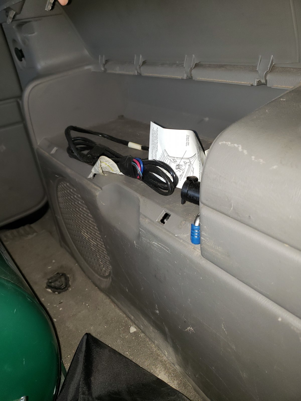

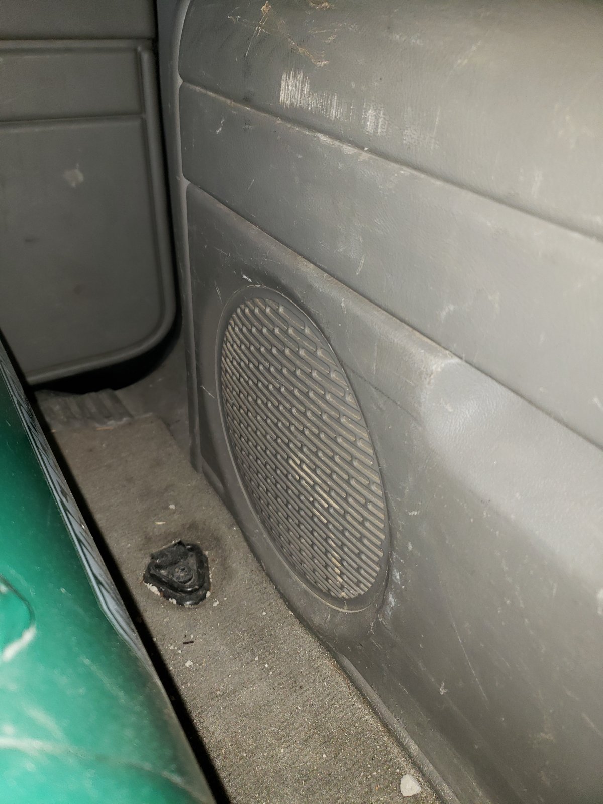

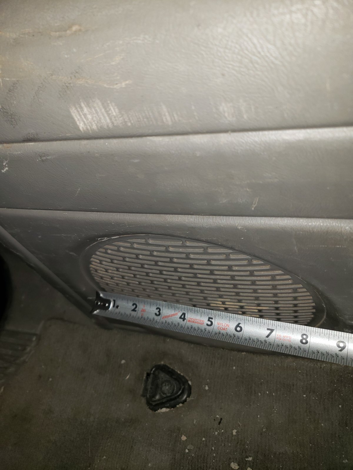

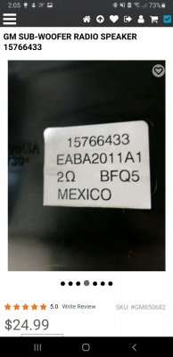

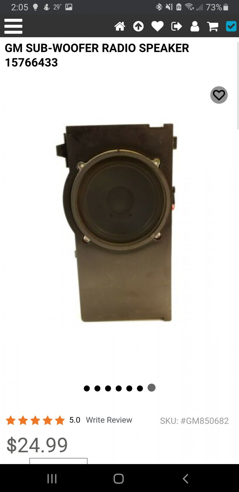

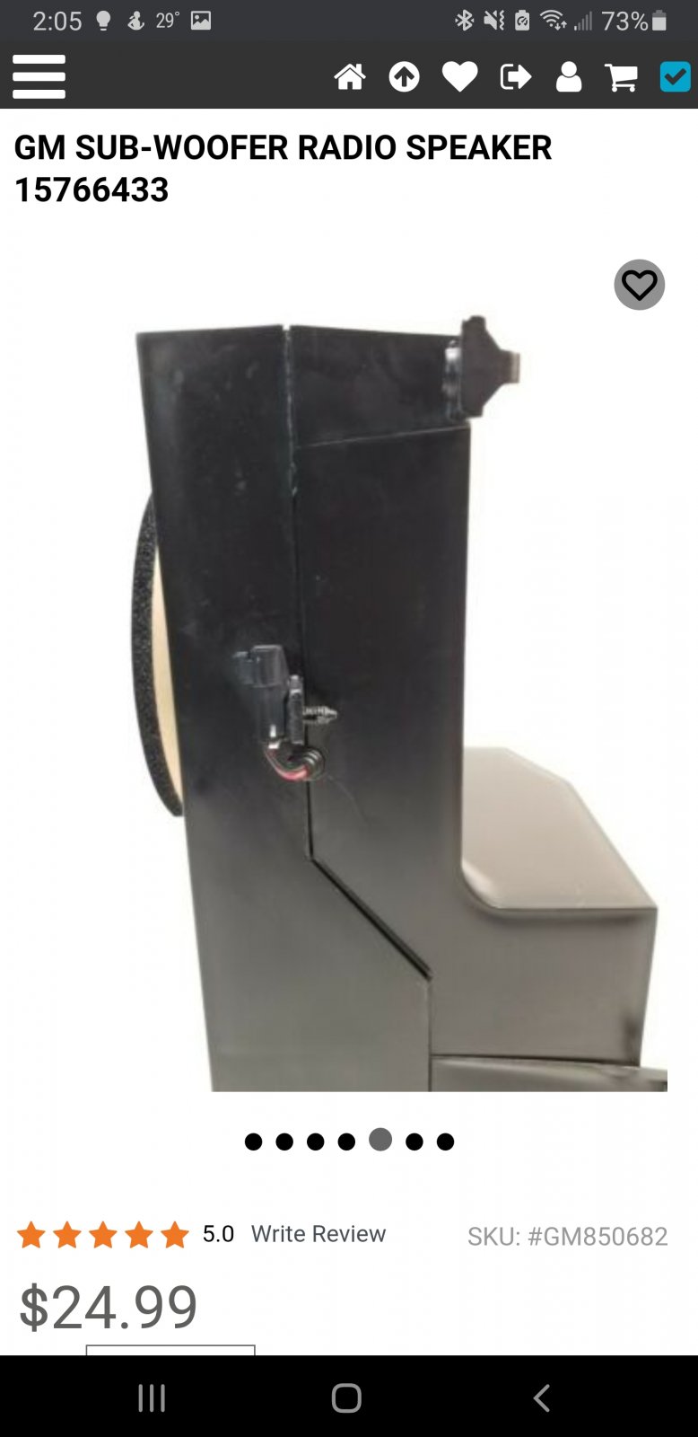

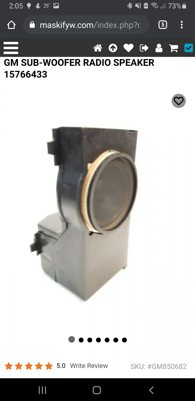

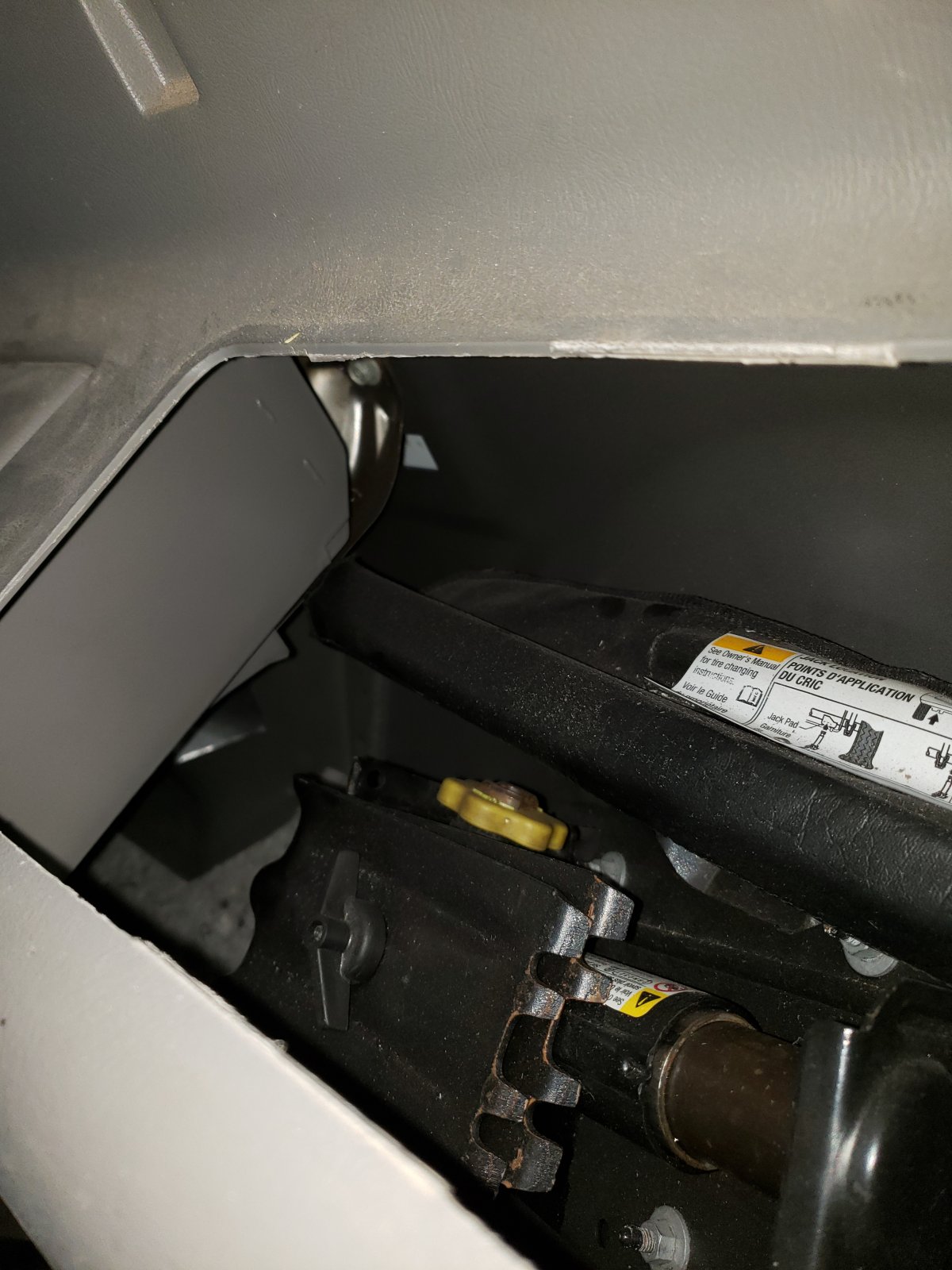

I have a spot in the back of my vehicle where it would appear that the subwoofer would go in the Denali package of the yukon XL, but the enclosure isn't there... After a lot of research and digging, I found two people that sell the enclosure for the 8-in subwoofer, and punching out the cutout would be relatively easy. This is an oem enclosure, so it fits with the clips brackets and screws that are already there, and it's somewhat of a complicated shape so I didn't want to try and make it myself. And all of the behind the seat options weren't all that enticing since all the seats in this vehicle can fold flat so I can get a full sheet of plywood in, and not to mention that there's already space specifically cut out for a subwoofer in the vehicle.
I'm not looking to shatter the windows of every house in my neighborhood, I'm just looking to get back the base that I'm going to lose from turning off the bass boost and maybe a little extra for those days when you really feel like jamming out... Does anybody have the OEM subwoofer and can anybody tell me specs on it? I know it's 2 ohms but that's about all I can find on it.
If I was going to add an amplifier and run the factory subwoofer is it any good? is it not even worth my time and I should just put in an aftermarket sub? if so does anybody have any recommendations on an 8-in subwoofer that fits in that box?
I'll add photos for reference below.

These came stock in the 2000-2002 years, they changed to the center console sub for 2003-2006. Yes they will physically bolt in, but you will need to run your own power and speaker wiring for it, and add your own amp. The stock Bose speakers are usually junk by now so plan on an aftermarket speaker to replace it, there are only a few that fit as it’s a very shallow 8” speaker. Watch the diameter of your speaker you buy to make sure it fits, most are slightly too big to drop in. I did all of this to my Tahoe. The box is very similar but shaped a bit different. I would say if the goal is a bit more bass with a hidden factory type speaker setup then go for it. But if you are wanting real heavy bass just get a typical sub box setup in the back or one that hides under the rear seat. Just my 2 cents.

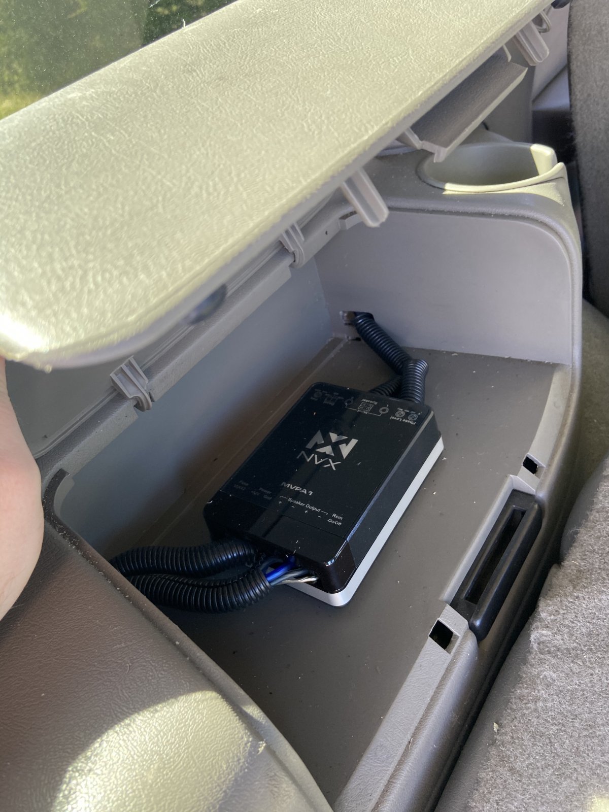

Although mine is not an XL, I got the short wheelbase sub enclosure out of a Tahoe in the junkyard ($15). Put a MB Quart 8” (like $40-def not what they used to be) and a little digital amp ($70) right in the shoe box sized compartment. Sounds pretty good, fills it out for sure. No contests or rattling windows, but not too bad for under $150 total with wiring. Hardest part was using a deemed to cut out each little slot in the fake speaker grille to make it a real grille. I also threw a $20 pyramid (?) in my buddy’s 02 with his factory amp to replace his blown one. If using factory amp, make sure you get the ohms right. It sounds fine, put the oil bass back where his blown was was missing it.
