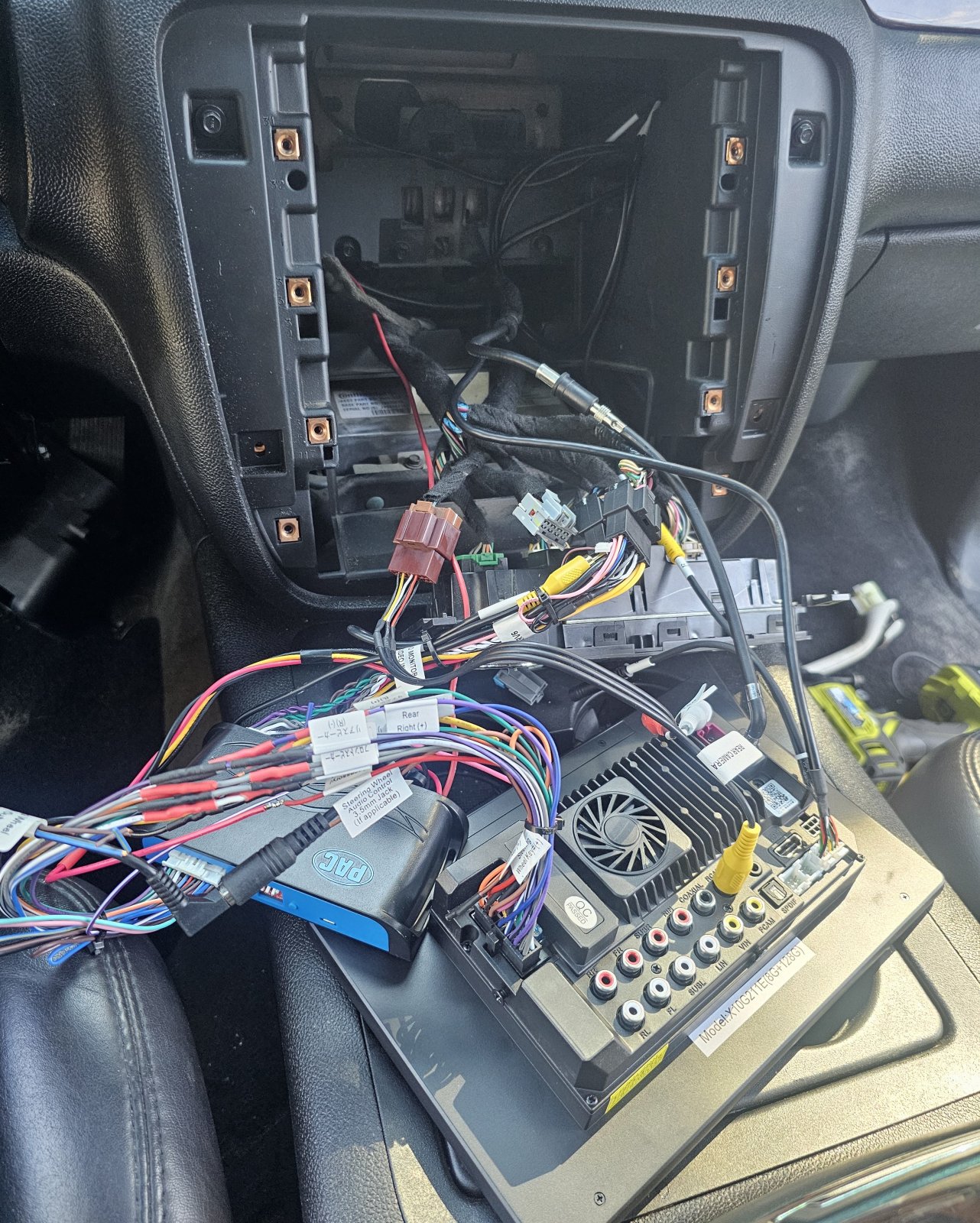

Ok, I have the PAC interface partly wired up enough to test. Seems to be working good. Radio turns on/off and RAP works.
Have not tried the radio/amp function yet or anything for that matter, Just on/off and rap.

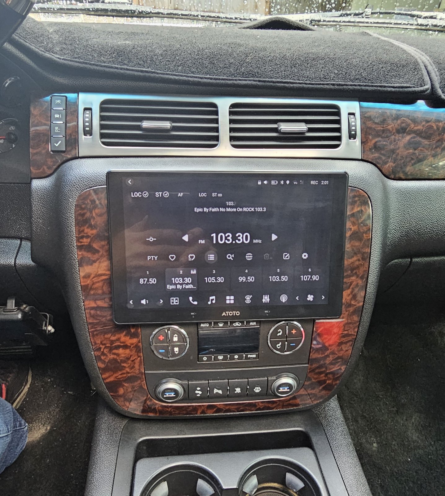

Here it is looking final install, but it's not.
I have to take it back out and turn the Bose amp gain up on the PAC interface. Did not think to check that before i put it in.

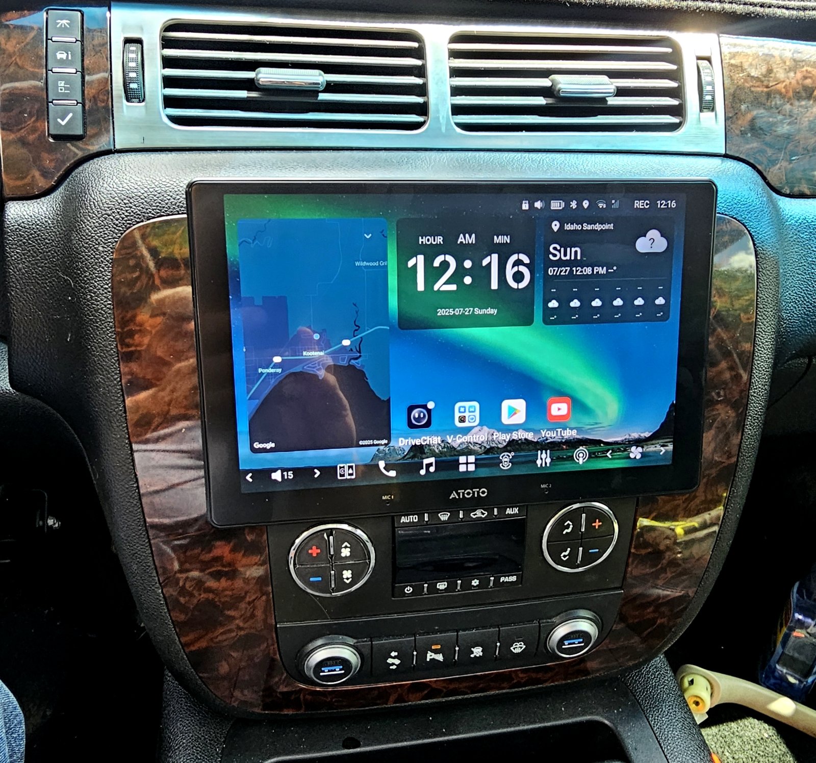

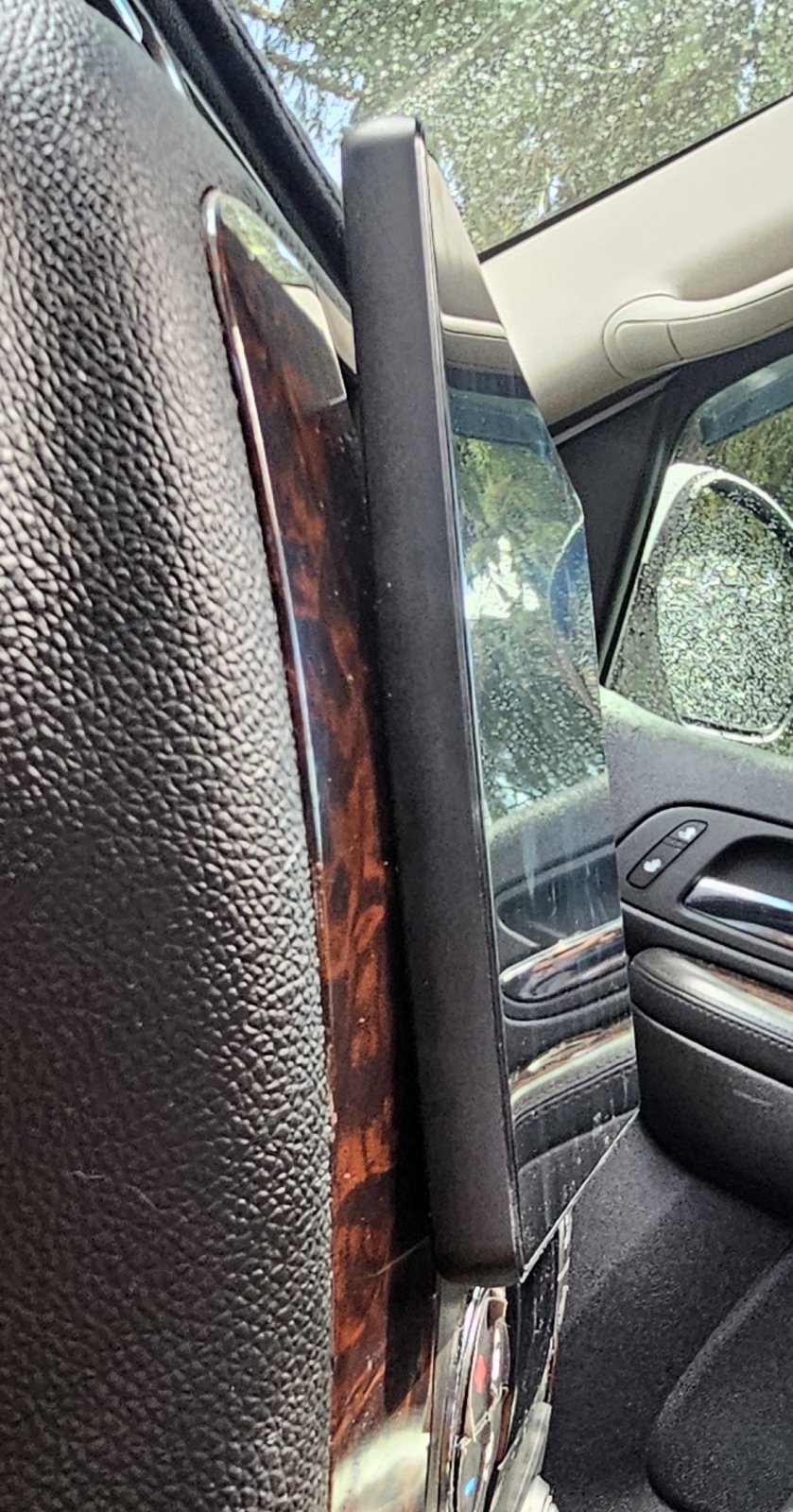

Finished getting it installed. Everything is working as it should that the PAC interface advertised to do.
I did not get to mess with it much today after finishing up, but i can say. It is an improvement over the stock radio.
Fuller or richer i don't know but it is an improvement for sure.
Over the next week or two, i'll be able to learn all the settings and get it dialed in to my liking.
