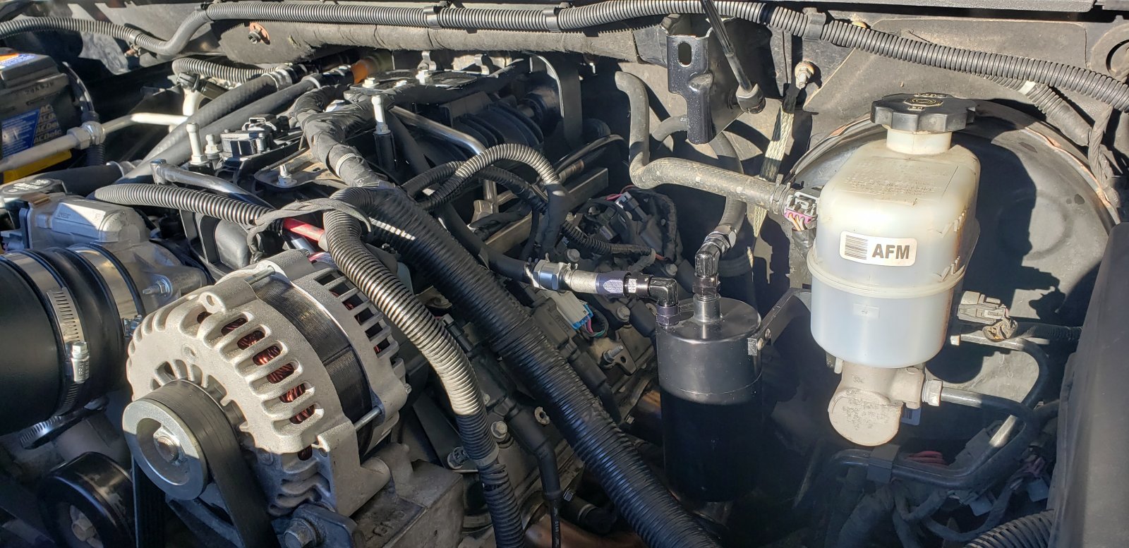

Installed my catch can today. Came out Clean!

I need to get the bung for my wideband burned in. I already have the gauge installed

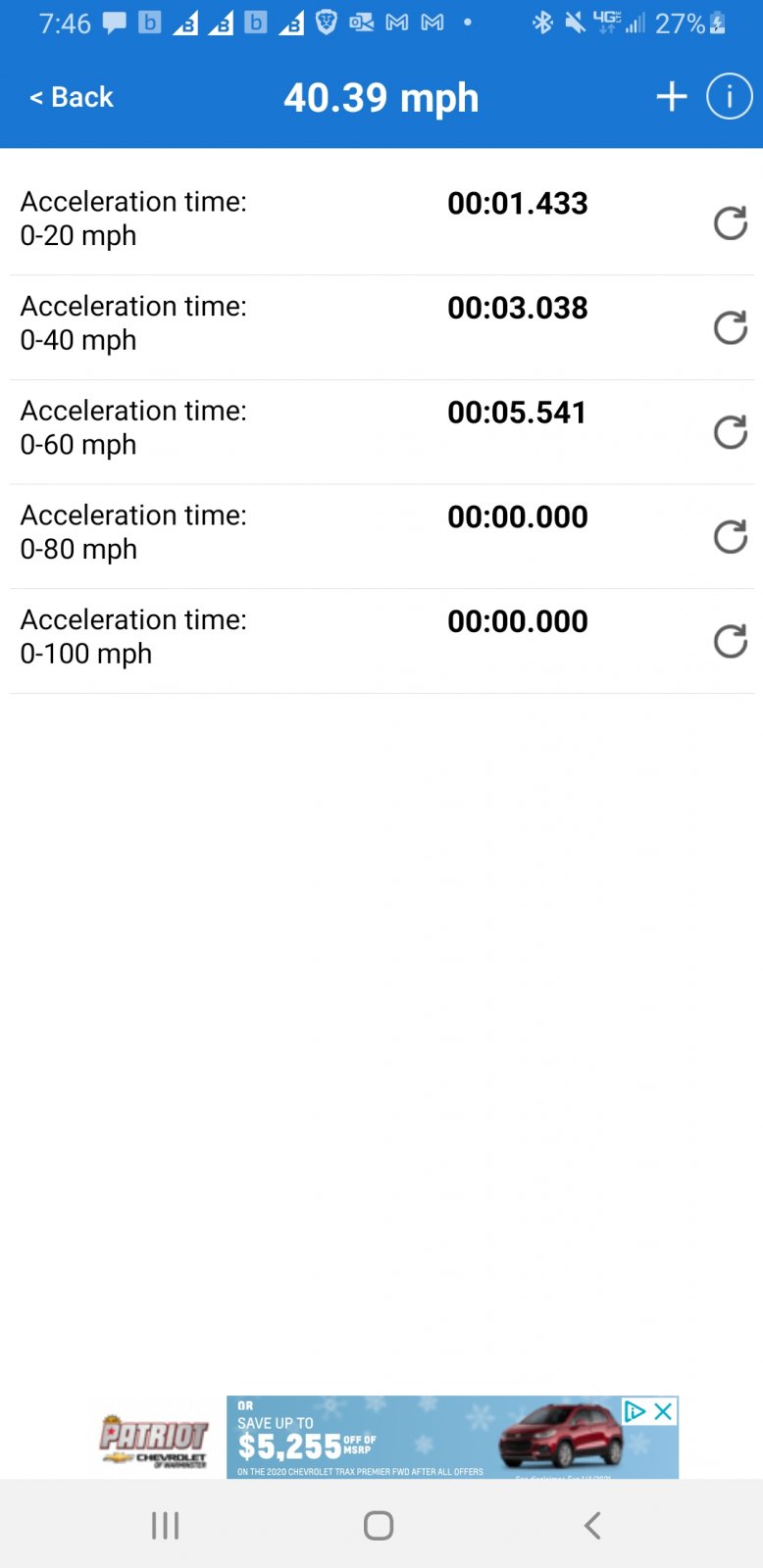

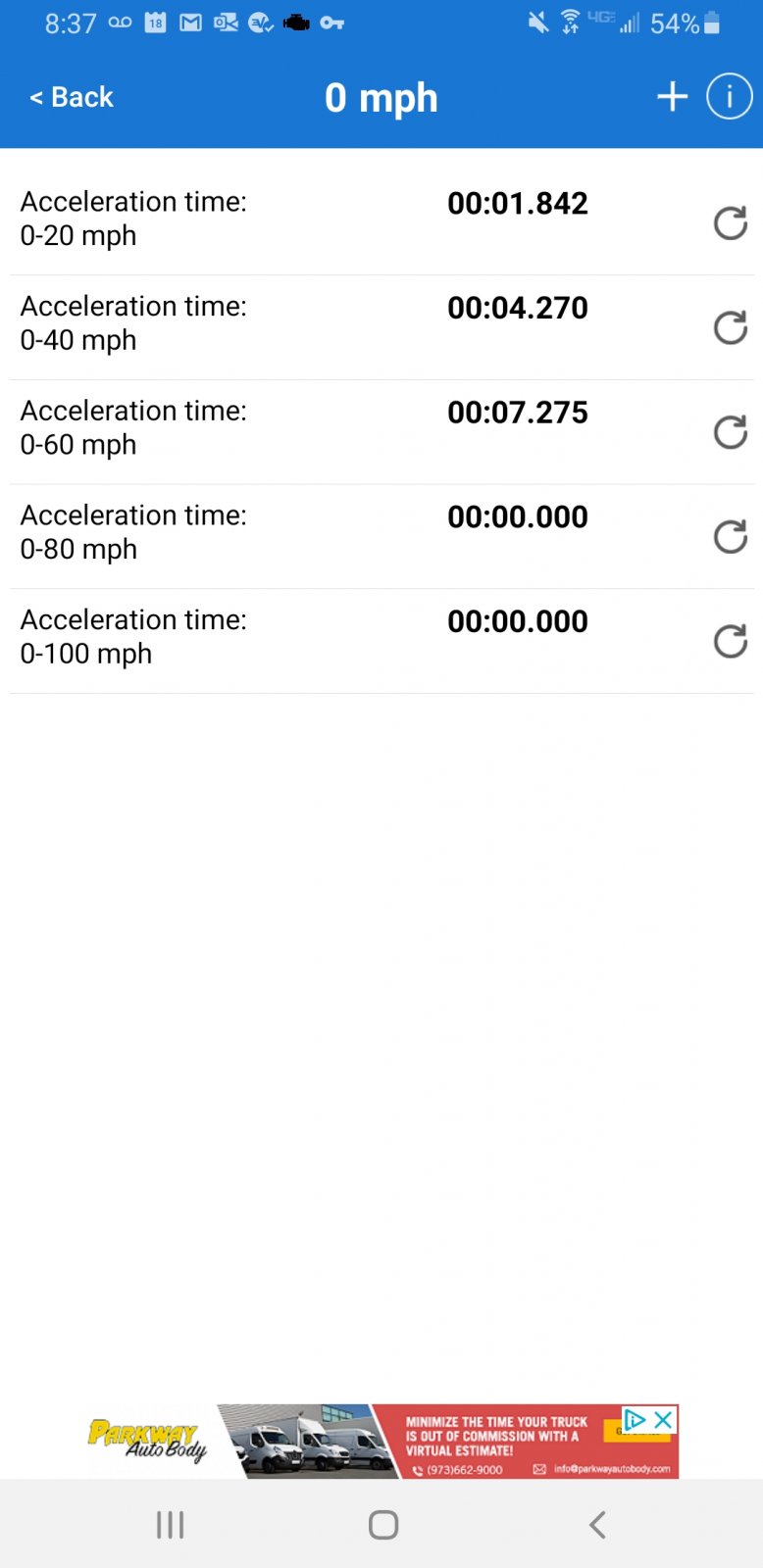

I tried to take a video of 1st->2nd from a roll, starting in manual mode. I hammered 1st and my phone flew out of my hand and flew into the 3rd row seat LOL.
Awesome progress! We still want to see that video! Even better! Lol.
