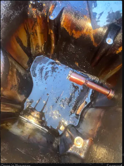

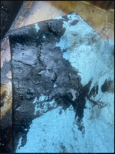

Well well well... This doesn't look very good to me. Pulled the pan off, and yeah the oring has seen better days, it's pretty flat.
BUT, this isn't looking good to me. on the bottom of the pan there is a ton of sludge, with possibly a bunch of metal shavings mixed in. Moving it around my fingers it feels... well sludgy(lol) but also pretty gritty too.
I DO have a magnetic drain plug, could this overtime cause a build up of the metal shavings from regular use wear?
The story that I feel is being told here isn't a good one. First a tick starts. Then half of my oil pressure is gone, and then this sludgy mess on the bottom of the pan...
Here's some pictures and a video.

It is a high mileage engine. It does appear to have had some poor oil change habits resulting in sludge. Sludge in oil pick-up tube filter can also drop the pressure, so hope you cleaned out the pick-up tube filter as well.

I think it’s more than sludge. I took my fingers and rubbed the sludge in between a rag until it soaked in. Then I did see a couple tiny miniscule metal shavings.
Also when looking up at the windage tray it does seem kind of sparkly, not sure if it was just the light hitting the metal of the windage tray or if that’s metal shavings.
However, the pickup screen was totally clean, not one piece of metal or sludge or anything in it.
And finally, I installed the oring today. I had a green one and replaced it with felpro number 72401. I kind of feel like it slid in too easily? Like it didn’t take much of any force at all for it to slide into the oil pump. I’m hoping it’s just because I had it soaked in oil, and not because it’s not going to seal.

What you are seeing is probably within realm of what is normal for a high mileage engine. By no means an example engine, but the bottom end is usually nasty and sludge does end up there, so do metal shavings.
If your oil pressure returns to where it needs to be, you are probably fine.
But I'd want more inputs from the folks here on what color O-ring is used. If i am not mistaken the original O-ring was either a Red or a Blue..... you seeing a green means someone has been in it already (??)

Ok well that’s good to hear, I don’t think the previous owner did many oil changes lol.
And maybe the oring isn’t quite green. Kind of a turquoise color. Definitely hasn’t been opened, pan still had factory rivets.

Well... if the pan has been dropped for the first time ever, what you are seeing is well within norm for 200K miles!!! Unless you changed the oil every 3000 miles you will build non-zero sludge over time. Didn't the valve train look clean ??? In extreme cases you will even see sludge in the valve train. At any rate, you DO NOT have a spring chicken. Love that engine and transmission. Don't try any 0-60s. Use the vehicle to go from point A to point B.. you can probably still get another 150K miles out of it ;)
Just double check on the O-ring color/style. If the inner diameter and outer diameter seem comparable to the old one and in fact the OD is slightly larger since the old one is squished, I'd say you are safe.
