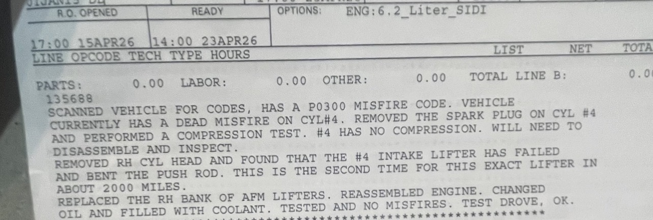

Well I had the lifter tick on on the right side of my 2015 Yukon Denali. Code: knock sensor. 131,459 miles. Took it into Chevy Dealer. They diagnosed it. Evap leak, bent push rod. New Oil Cooler lines. New Transmission cooler lines. Replaced both banks of afm lifters, new spark plugs, and oil change. $7,166 out the door. GM knows these fail but they won’t recall this year. It’s B.S. There needs to be a lawsuit. I could’ve only done the right side where the tick was, but since it was tore down I just had them do both sides. Anyone else replace these, and is the price about the same or do people just get rid of them. I love this truck, and will probably drive it into the ground, but I had an 07 Tahoe that went 209,000 with no major repairs, and ran fine. These newer ones are junk. Maybe GM shouldn’t have closed down the Janesville Wi plant and they would be better quality vehicles. New ones are $100,000 and are piss poor quality.

Hey guess what. This has been at the dealer three different times now for new lifter and push rod for the third time since last January. Same #4. At least the oil gets changed.

It has been at the dealer 3 times since last November for the same lifter failing. You think I would make that up? I spent $7100 the first time and GM warranty the last two times. It’s probably going to go out again.

Oh pretty quiet now aren’t you after seeing my repair orders. It’s back now for misfire on #5 just days after I picked it up last week. I’ll keep you updated Troll!!!!!
