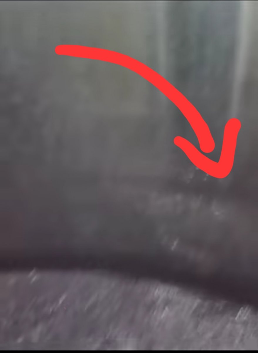

so far i have done a compression test with all plugs out,
and one in the suspected area is reading lower. / 131 psi / 9 bar
the rest were reading 174 psi / 12 bars
with camera there is also signs of some scratches on cylinder wall, that can explain the lower compression, but does not explain the sound.
i am also heading for a bottom end / rod bearing issue here... maybe i should just drop the pan before deciding what to do next...

Could be a cracked flywheel like Rockola said. In your first post you said it made a noise when trying to start it. What kind of noise?
Could be a rod knock.
What caught my eye was the HORIZONTAL mark in the cylinder.
That looks like the mark a ring makes when an overheating engine is shut off and rings seize until the engine cools. Have you ever overheated it?
It has not been overheated as far as i know, but i am 6th owner of this one, so i cannot speak for what has happened earlier
For me, the noise at startup was like a kickback in 450cc dirtbike. I suspect an leaky injector to be the culprit to that, but it seems odd to me the knock develops after this. It was just starting when it stalled with some sounds, hard to describe. I just restarted it like normal, and there was knock that never went away
I disabled the suspect cylinder, unplugged coil and injector, and the noise got better so i could move it to my garage. I will have to source a new engine, but i will pull the pan first. Will let you guys know what i find.
Before i went to work, i used this car and a trailer to bring an X5 home. Approx 460 miles / 740km both ways, without a fault. Used the car for some small errands after this, parked for 14 days, boom knock.
If it’s got a leaking injector and leaked enough it could’ve hydrolocked one of the cylinders. If it had already fired on another cylinder before the piston in the cylinder with a leaky injector came up then it would definitely be enough to force the crank around resulting in a bent rod. Seen it happen on engines with a bad head gasket that allowed coolant into a cylinder. Can’t compress a liquid
Yep. OP definitely got some things to check out. I would drop the pan at this point and spin engine over and thoroughly inspect the bottom end rotating assembly.
