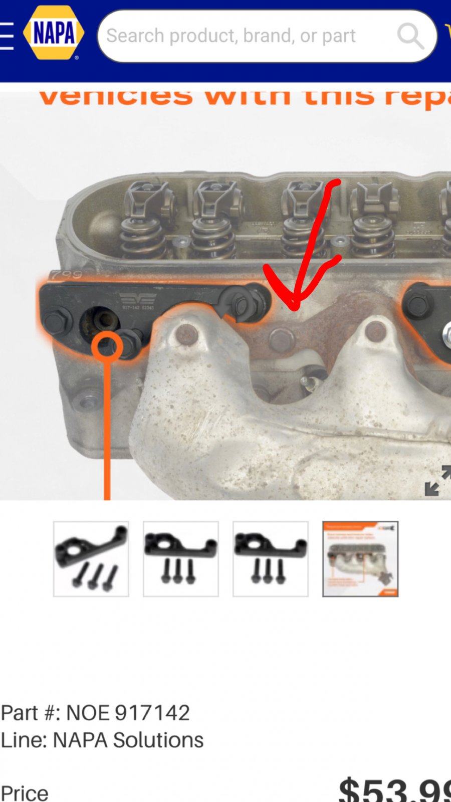

Also I failed to mention, I tried using a clamp for the broken manifold bolt. The bolt that’s broken is the second to last bolt on the passenger side(toward firewall, one away from the back one). I used Dorman 917-142. However it’s clearly not the right clamp that I need. It seems this clamp is only for the last bolt and not the second to last one on the passenger side. Not sure if they even make one for the second to last bolt.
In the picture attached, you can see the arrow I drew. That’s the bolt that’s broken on my rear passenger side. Obviously that clamp won’t work to clamp that, I’m stupid for not looking at this before I bought it. Just wondering if there’s a clamp that will?

Do you know if they make an exhaust manifold clamp for the 2nd to back passenger bolt though? I can only find ones for the farthest back bolt to the firewall, center and front.
I don't think so, if your lucky you could drill it and use a easy out
is it flush with the manifold? or broken off deeper?

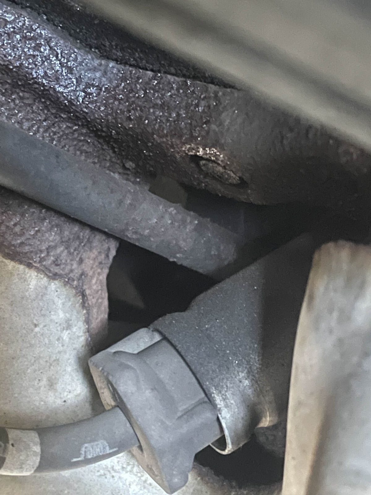

Ah that sucks. And it seems to be pretty flush with the manifold. Heres a picture of it.
if you can get a drill in that spot you might get lucky, drill it and then wait until you get a pretty chilly morning at 4:30am and use a ratchet and extractor
if you spray it with a compressed air can real good first that will help make it cold as well. cold shrinks the metal.

yeah would probably need a right hand drill no chance I fit a normal one in there.
But also I’m starting to think it’s a lifter not an exhaust leak. The tick almost sounds like it’s coming from farther up on that bank not from that exhaust bolt missing.
