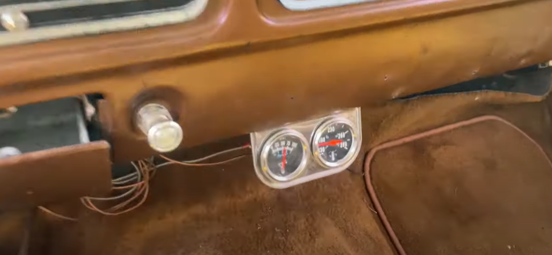

Where did you put the mechanical gauge in the truck? Just trying to figure out the best mounting spot.
I don't have one in these newer trucks. On my old trucks I mount them somewhere under the dash... pic below shows oil and coolant temp gauges.
Thank you!
Unfortunately the gmt800 dashes don’t have a flat edge on the bottom of the dash and have the center console in the way, did still find a good mounting spot.
I’m going to put it on the front removable panel(the one below the steering wheel you’d take off to service the steering column area). Should fit nicely there and I can probably hide the copper line and wiring for the light pretty easily.

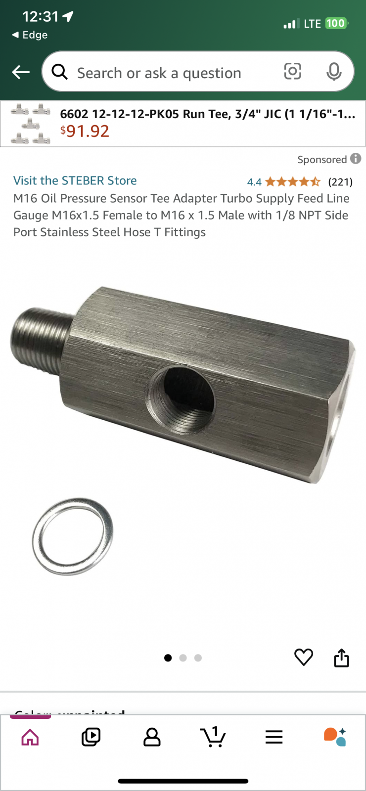

For installing mechanical oil pressure gauge think this would fit? So it’s a tee that I’d screw in where the stock sending unit goes, with a port for a mechanical gauge, then up top there’s threads for the stock sender.
I’m scared with the stock sender attached up top it’ll hit the intake and be too tall.
A tee like that is a good idea if that will fit. That is how it was done on the older trucks where an oil pressure switch was required as well to control power to the early electric fuel pumps (early dinosaur computer technology!)
I highly doubt it’ll fit though. Barely enough room even for just the sender. Think I’m going to try my hardest to get it in that plug on the block where I tested the pressure from
Also have no clue how I’d tighten the compression fitting down there, no room. Would be almost impossible.
