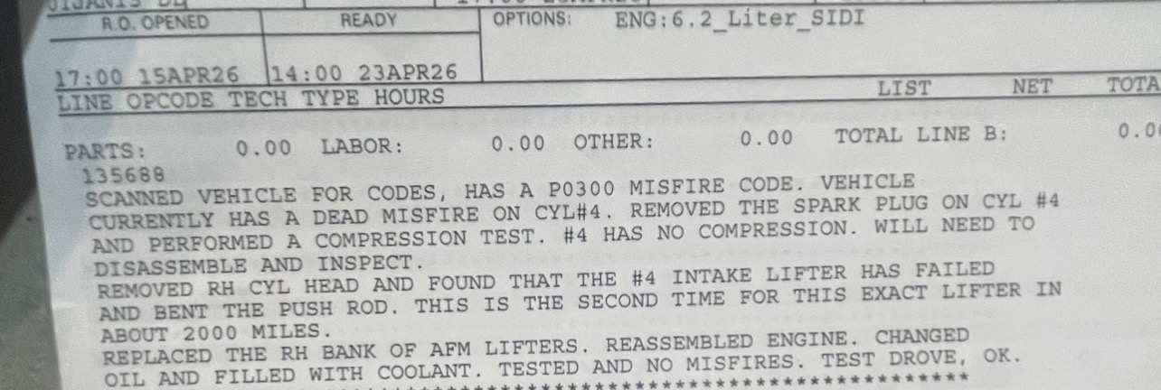

Im not a mechanic, and the dealer is the only one who has a warranty for two years where a private mechanic can’t warranty the fix so what else am I supposed to do? It’s failed four times now since last November. If these guys were so good they would be master mechanics. I don’t value their opinions. It’s already paid for.

They did replace the VLOM last week it’s around $230 out of pocket. I don’t have the R.0. It’s in my center console.

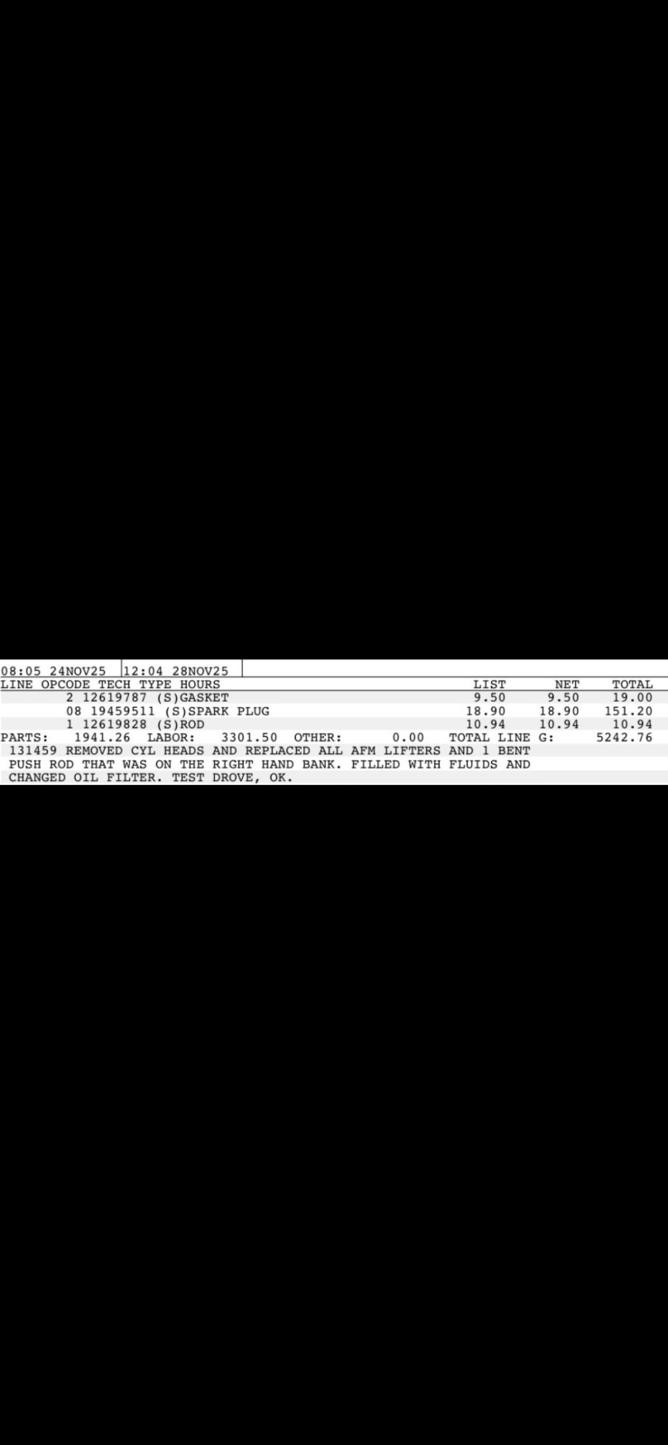

I feel this "dealer issue" myself. Or atleast for the company I work for. We have 3 delivery trucks. 2 that are 23s and one is a 24. One of the 23s has 69,000 miles and started missing. They took it to the dealer and 8 hrs of labor just to take the valve cover off and get into the head. They called today and said bent valve and bad lifter. O and piston damage. I drove it there and it ran like it was brand new. They said 10 grand to fix or 12 grand for a new motor! At 69,000 miles!! 9 grand out of warranty! I used to work for a couple of dealers but crap, they suck!!!
