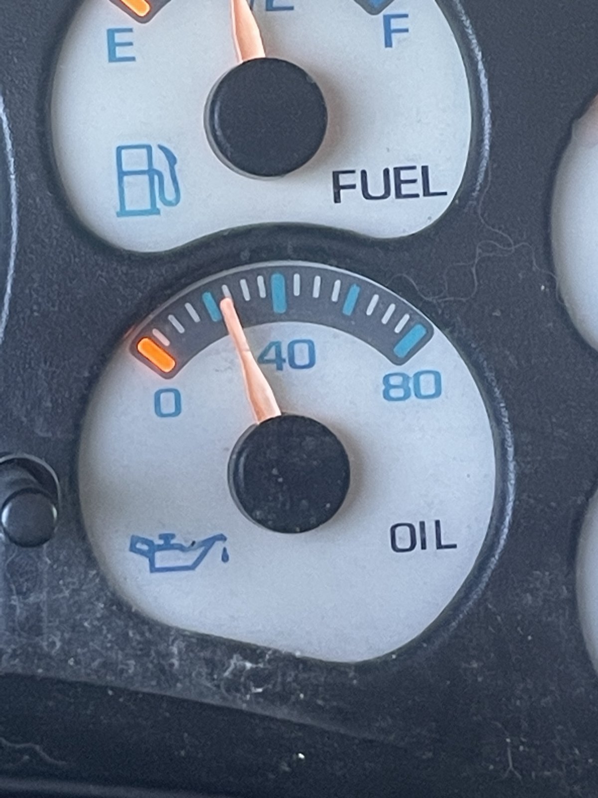

If it is a lifter tick could my current oil pressure cause this?
I know 40psi idle is like the norm for these trucks. My truck on cold start idle has around 45-50psi. When warm idling it has around 35psi. When I am cruising at 1500 rpm warm it has around 45psi. And finally at around 4000rpm it has like 60psi.
Would this be too low? I feel like it’s not but just looking for a second opinion.

Your oil pressure numbers are fine. General rule of thumb is 10psi for every 1000 rpm. We of course get much more than that at idle. Lack of oil changes (dirty oil) can cause crap buildup in your oil passages and in your lifter bodies which can cause them to stick. That crap in your oil will also eventually end up embedded into your cam, rod and main bearings if the problem is severe enough.

Something I forgot to note here. My oil pressure gauge does have an issue where it jumps all over the place. I don't think its a real problem with oil pressure, but a problem with the stepper motor for the gauge itself. What's your guys opinion, think it could be fluctuating due to something mechanical?(like pickup tube oring) and causing the tick or just a bad stepper? Debating if it's worth throwing a manual gauge on it.
Heres the video for this.

Don't know what's going on with the gauge... but definitely not worth installing a manual gauge with what I see there...... The gauge is responding to RPM, so you are good (and btw I am not hearing any knocking in the background.)

yeah the knocking cannot be heard while normal driving. Only hear it while outside near the engine or revving it while totally still in my driveway. AND in the drive thru with echoes of the walls. Was at o'l Mickey D's today and I could hear the think clicking and clacking off the wall of the drive thru lol. honestly may be an exhaust leak.

Valve cover gaskets are in no problem. First day back to driving it, and I’ve lost 10psi of oil pressure today. Was 35-40psi at idle before and now I’m lucky to see 30psi.
I have a feeling the pickup tube oring is going bad.

Also to be noted, it seems to gain like 5-10psi when I have the front of the truck nosedived down.

That is plenty of oil pressure in my opinion. When you rev it are you over 50PSI ?
Didn't you say your engine has 200K miles ? If so you are in good shape for the miles.
When I rev im nowhere near 50psi. At 2k rpm I have 35psi, and 4k rpm I have like 40-50psi.
No where near where I think it should. I had an 05 tahoe with 160k at 4k rpm it had like 70-75psi of pressure, at idle 45psi and 2k rpm around 50-60psi.

And also Im very concerned because, the pressure literally dropped 15psi today from what is has been at. So somethings wrong.

I would suspect the gauge as well on such a drastic drop.... what you have there I'm sure is no perfect gauge... on all my old trucks I have a mechanical oil pressure gauge installed.
If you are worried about that o-ring, by all means drop that pan and change it. No big deal.

Alright folks I’ve made up my mind, I do not feel like busting my ass if I don’t need to. So I’m going to put a mechanical gauge on it. Will probably put it near the oil pump, there should be a plug there

Oil pressure test kit I ordered with the right M16 x 1.5 adapter doesn't come till tomorrow but I did get the sending unit off today, and boy it was BAD.
Thing was oil soaked and has been leaking all down the rear of the engine. Really does look like a rear main leak from below... lol.
Hoping the sending unit is the problem! Hoping that all the oil destroyed it, but I guess I'll find out tomorrow with a mechanical gauge!
Forgot to look, but I dont think 02s have the screen for the sending unit, right?
