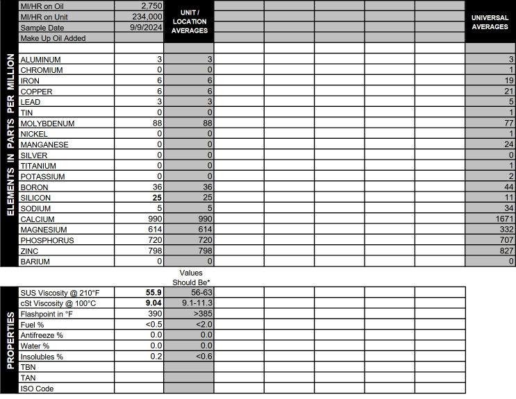

Power has been lacking.. not necessarily sluggish, but she has seemed more tired lately. Could be smoother, I've been chasing down some high fuel trims and I think my intake manifold has a vacuum leak. Waiting on metal carrier gaskets to swap out. Changed out transmission mount while back and just finished the engine mounts recently. Engine movement is minimal. CV joints are... there? lol how would I check those? When removed from the truck they move freely and quietly with no sticking or binding. I've changed out the valley pan gasket and the cam lobes did exhibit some wear. Though interestingly, my last UOA came back showing very little engine wear. Though silicon was a little elevated.
