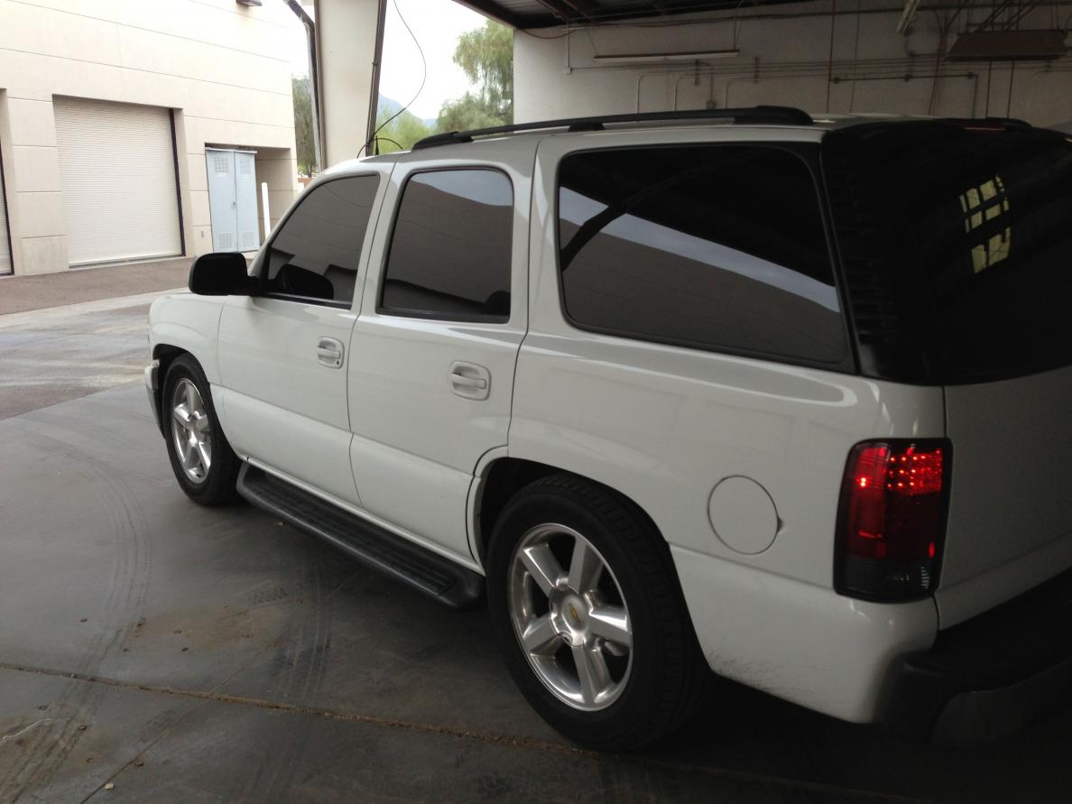

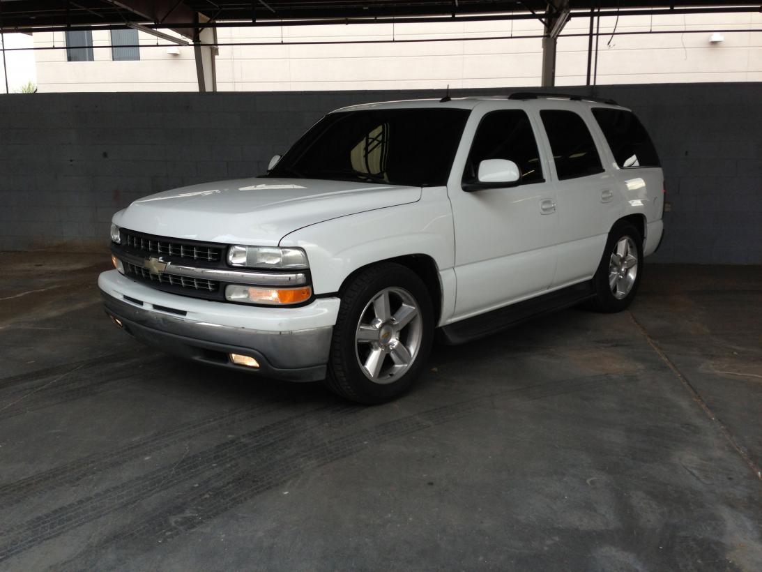

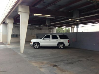

Got me another Tahoe a couple months ago. Managed to pick up an 03 2wd with 145k for $4500 with no major problems. Got an HD Hood first day I had it. It was rollin stock 16's painted black so I got some LTZ 20's then ordered a 3/6 drop with Belltech SP shocks from Tony. Installed everything a couple weeks ago. Gotta say I love this drop. Rides awesome. Almost stock like. Takes dips and potholes very well. Also got the Panhard bar. I am sitting at about 33" all the way around on 275/55/20. Also did the helper bags at the same time. Haven't towed anything yet, but got a camping/fishing trip soon. Heres a few pics. I think the rear has settled a little bit so its lil lower than pics show. I did not use the 1" spacer.

Lovin the stance, great start with the mods.

right on im glad your happy with the drop!!! the 6" springs are DA BOMB!!

Your windshields tinted ain't it? Looks hella dark..
yep. 35% with a limo visor strip. front windows are limo with 35% and the rest is limo over factory tinted glass.
i was just out driving it. love the way it rides. i take back what i said about riding almost like stock. cuz even stock kind of sucks. its better than stock. very smooth ride for such a big suv.

sittin pretty. love the stance and the subtle mods that only a Tahoe or Yukon owner would recognize!
