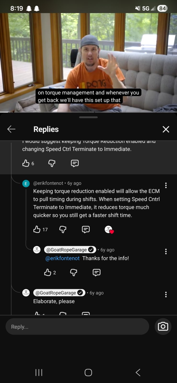

Also idk its authenticity but I saw this on a tuners video

The video absolutely looks that way but im hoping its a Snapchat issue vs reality. Im trying not to wail on it but I am curious lol. Ive definitely been learning a lot myself, and if there is a delay id be clueless on where to look at this point unless its ecm tm related(i think spark torque/spark reduction) are the only ecm related tm left, or its adaptives
I changed mine to immediate per Silversurfer77 video's
Whoever brought it up on here i did as well, just thought the comment below and silversurfers response was interesting and or like he didnt know what that function did

Siu does do a good job explaining what function does what, and the testing results. He does break down what actually makes a difference vs others.
As far as making small changes every time apparently I just over commit to them and send it
There were 3 i disabled (top right) that im spacing on. It was something CT downshift etc. That did make a huge difference "rolling" and standing on it,especially from a 50mph hit
I did find something helpful last night scrolling the hpt forum about speed cntrl function
Immediate is preferred for faster, firmer shifts, where "Torque Ramp" is designed for a smoother, slower torque re-application. Heavy vehicle, towing, daily or where longevity is key is where I would use torque ramp vs immediate, more performance biased where shift quality is needed i would use immediate

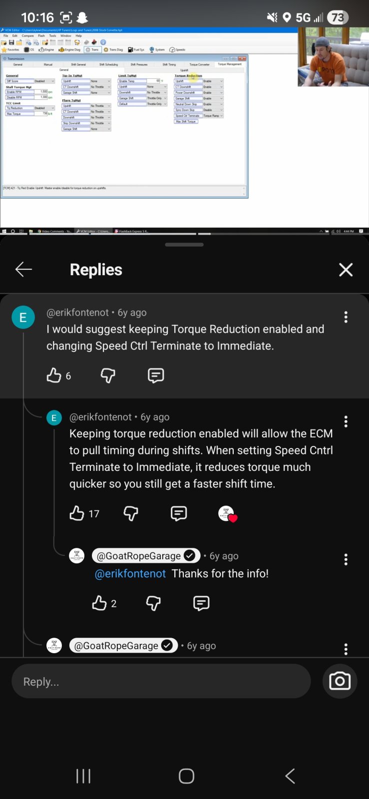

Good to know! In that case, I am fine with it on torque ramp..
At least im not the only one that does that. Ill add the screenshot the one guy posted on goatbuilts video, it actually makes sense and I may try that before making the change back to ramp.
Yeah, I'm changing mine back to Torque Ramp.
I have one more change to make, and if im not content thats where ill be stopping
