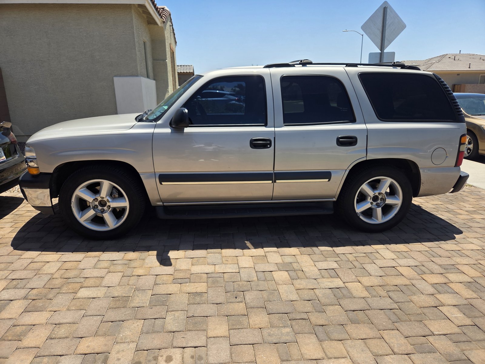

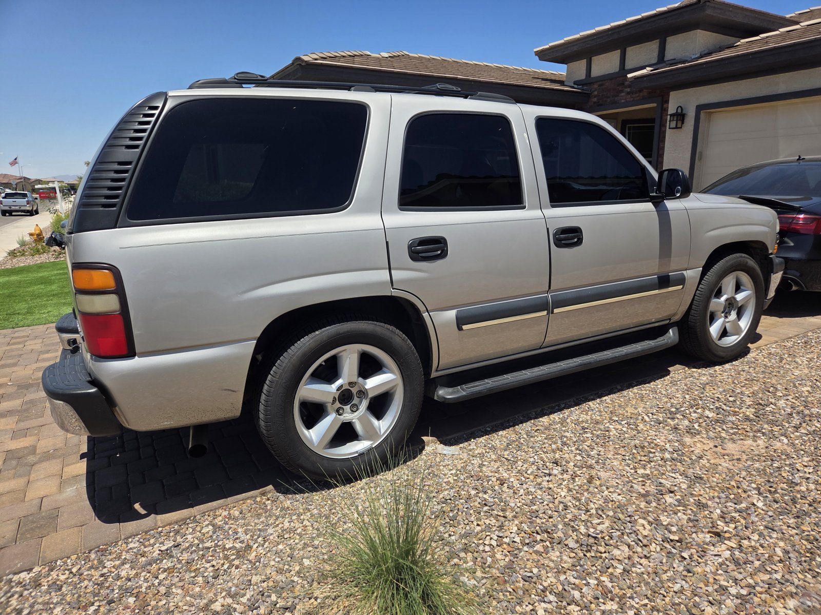

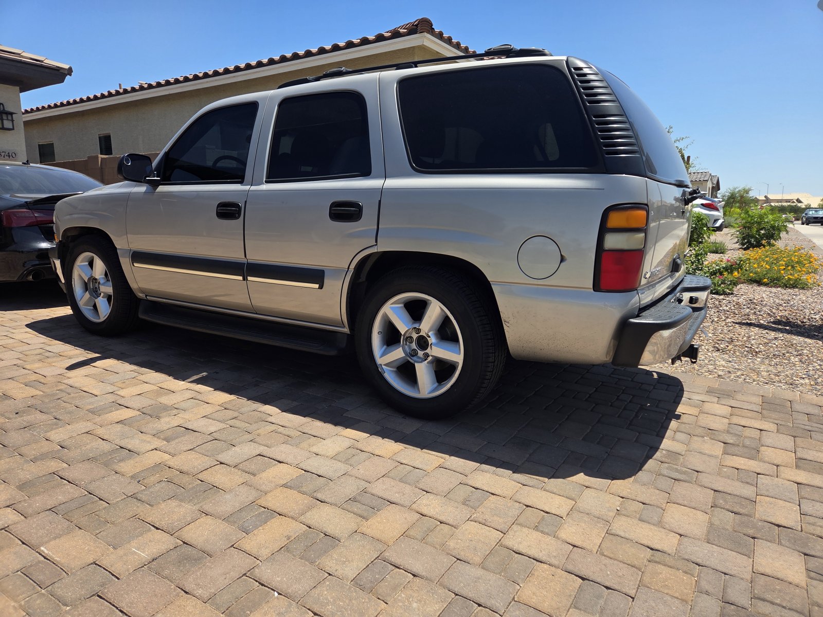

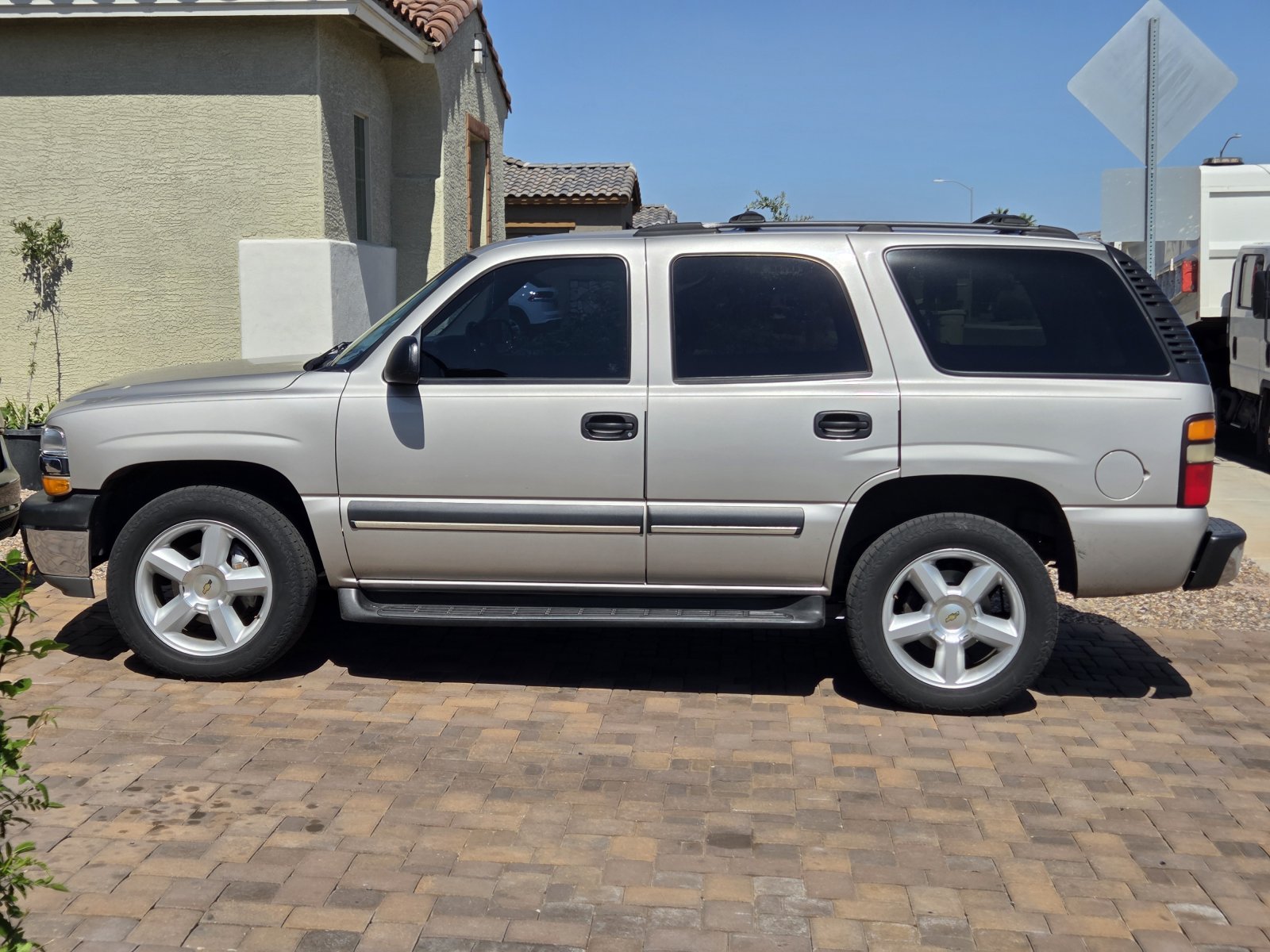

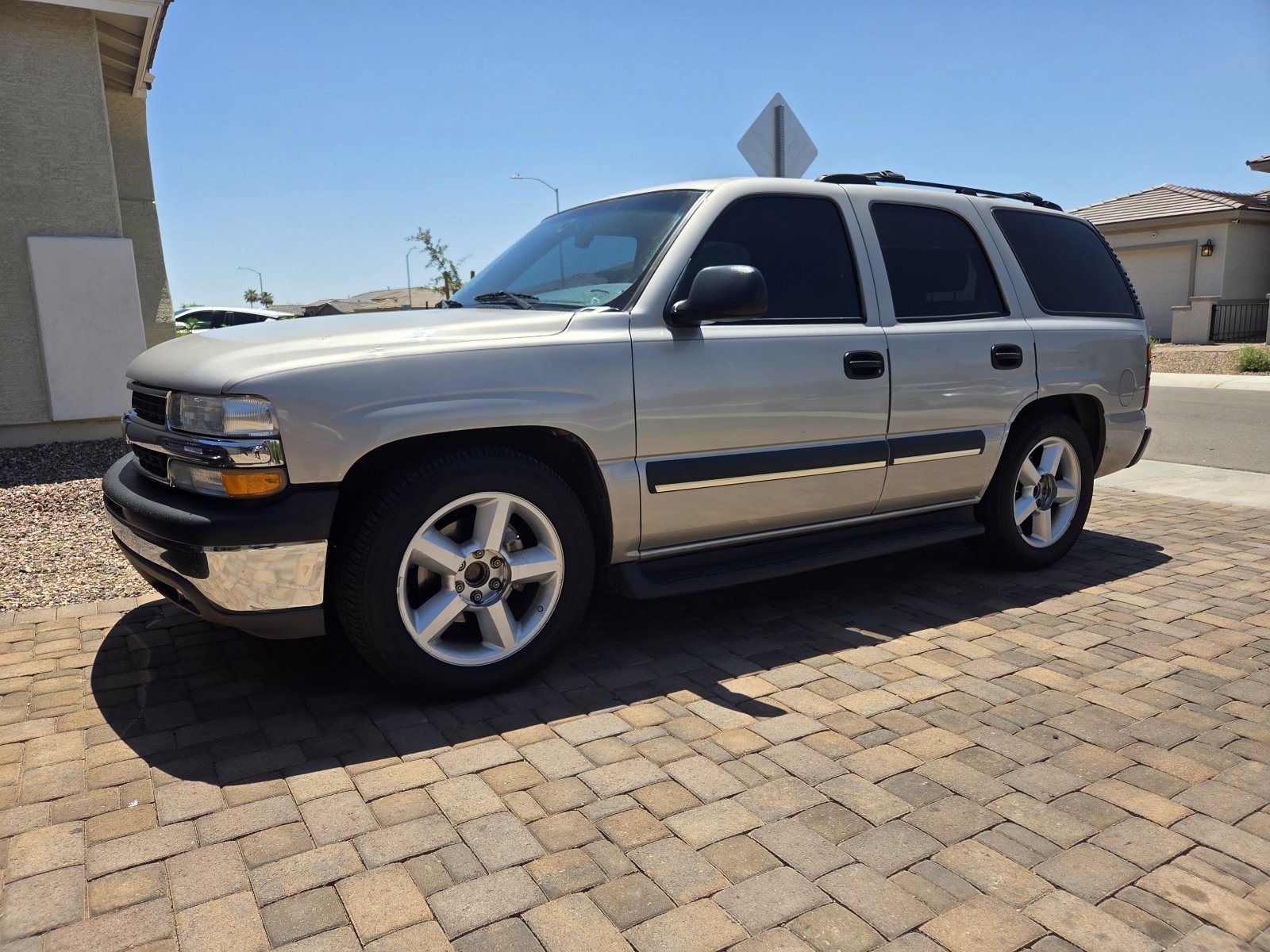

Here's the before and after. I think it's sitting pretty well now and I like where it's at.
