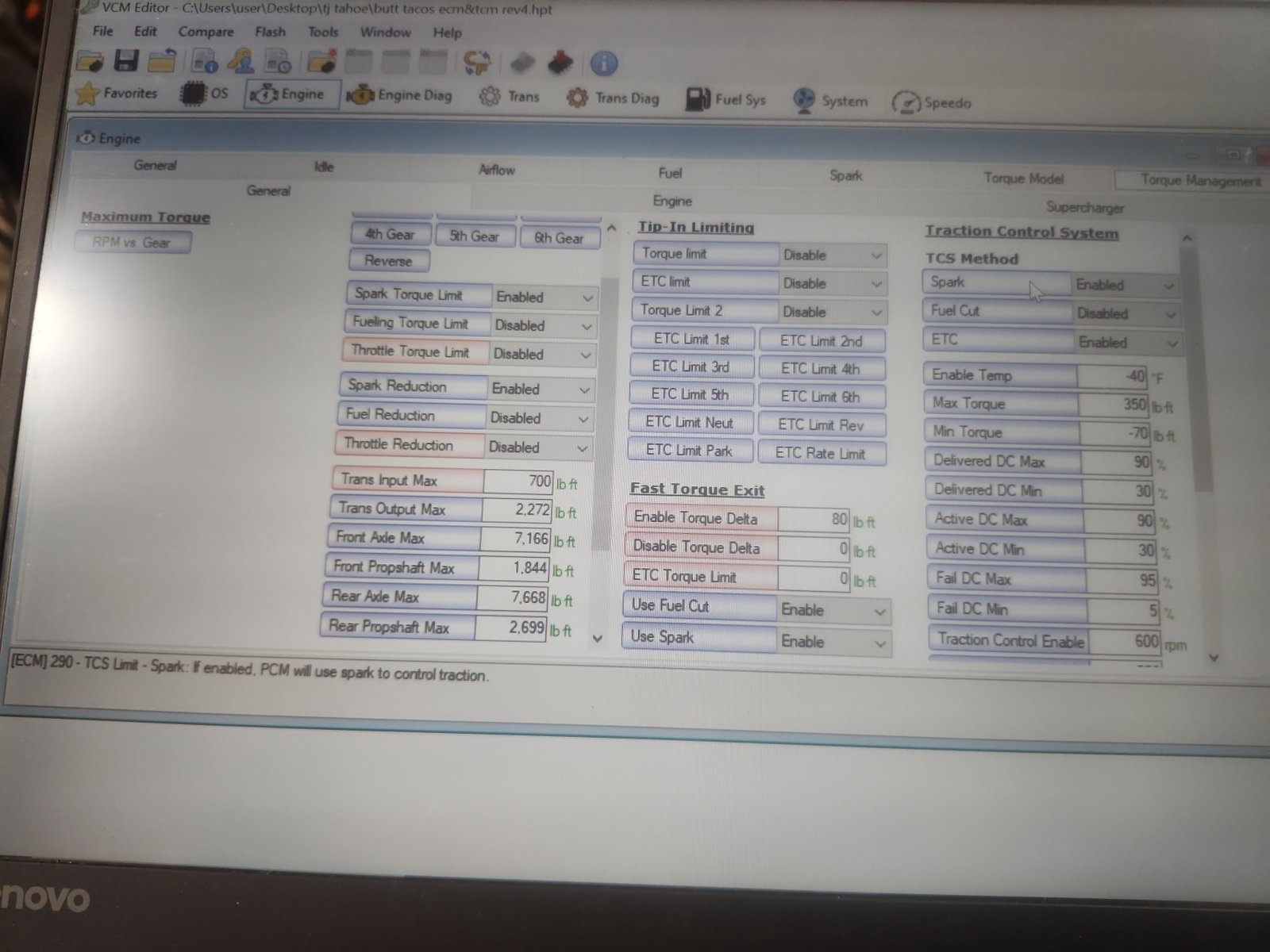

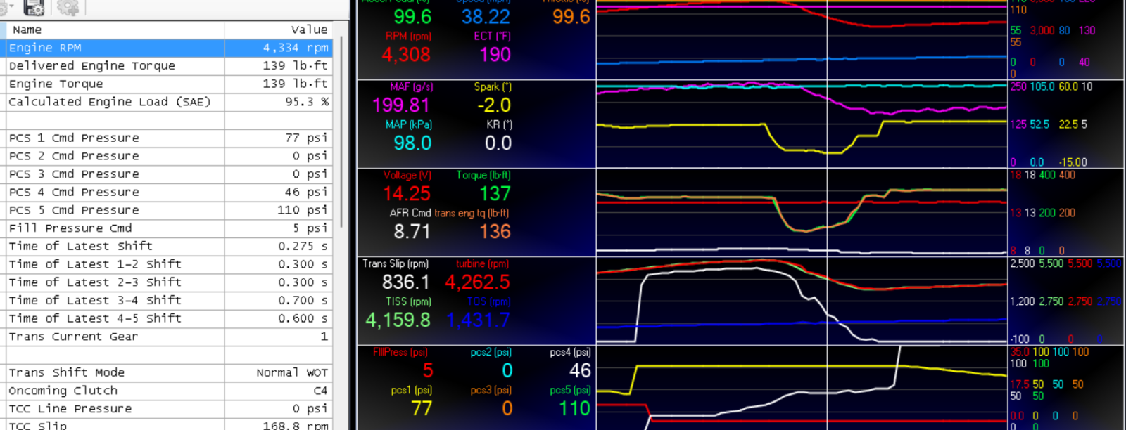

In case it helps anyone else out i had hours into tonight's setup
First starting off with torque reduction upshift being turned back on to enabled. I made this change, even with 20%tm removed, it shifted identical to stock.
I made so many changes its unreal.
Ct downshift, upshift and power downshift remain disabled, speed cntrl terminate is still immediate(found another video of a tuner doing 85%tm, immediate and enabled top 3 that I've taken out
Now I have 40% total taken out from transition time between gears. 1-2,2-3,3-4 shift times are to .20 at wot(last 6 figures), and due to the last tune being so aggressive at part throttle I did the first 6 rows at .40, bottom 6 at .20 then interpolate to blend everything out and went to 90%tm. I also fully disabled any spark reduction timing engine wise.
Truthfully I think for my truck this is probably going to be my last revision trans wise. Maybe its my lack of knowledge the torque management actually seems to help coordinate the shift from what ive gathered
Part throttle is crisp, quick and firm, wot is a good snap (not violent)and still barks the tires on the shift. Now from .27 at my max to .20 on 2-3 the inconsistent row boat shift is gone. Granted adaptives are fresh but this seems to be off to a good start, ill post a video tomorrow
For what its worth, im unsure if the tach in the videos is having issues or whether I have a delay. Ive realized my shift points are 300rpm above stock and ive yet to see the needle above 5500

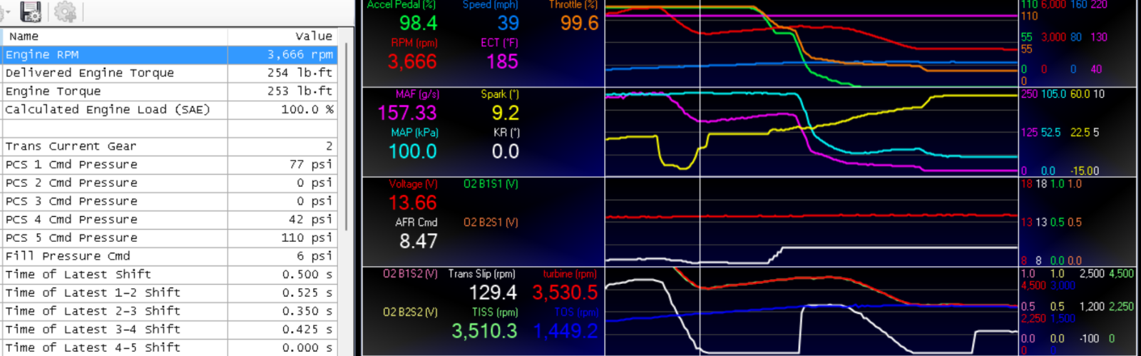

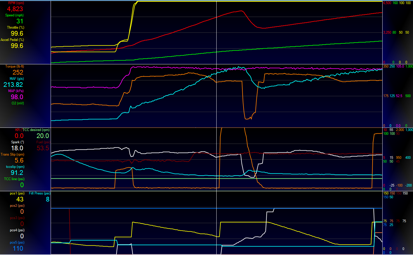

I have hit a wall on my WOT shifts. Spark will hold at 9degrees on the rebound, always at 260lb/ft torque, about .45-.50 seconds in, extending my shift time to .600-.825 seconds. Typically .775-.825, the last log I bumped oncoming pressure 20% so that is how I got down to .60-.70 seconds..
Guessing @LSxBakakos has a fresher transmission. I'm still at 100% torque management, and I don't think it's any kind of limiter, though it pauses right at 260lb/ft torque everytime..
Only thing I can guess, is the trans is expecting slip to be less than the 200-300 rpms that is there at that moment..
At least it feels OK driving around, but I wonder how much further this 240k trans will go..
mikez71
Mar 9, 2023
3,465
4,318
The yellow graph, spark timing dip shows the shift time exactly.
stock torque adders, stock oncoming pressure, initial shift time .50, transition at 170-200rpms, TM plateau another .30s. Total .72 - .80 seconds.
2018 torque adders, 1.2x oncoming pressure, initial shift time .35s, transition at 220-280rpms, TM plateau ~.30s. Total .60 - .70 seconds.
stock torque adders, 1.3x oncoming pressure, initial shift time .50s, transition 130-160rpms, TM ramp .10s. Total .60 seconds.
Guess I'm slipping, and bumping torque adders can speed up initial phase, but that also leaves more rpm slip for TM phase to make up.
Bumping pressure seems to help both shift and TM phases, although I see no pressure difference in the logs (PCS 4 looks to be engaging for second gear).

Latest revision, can see differences in 1-2 2-3, where all of my focus has been. Then how sluggish the 3-4 is which ill clean up

Im very curious, where is engine tm set to? If you turn off spark reduction to disabled in both tables and log again if that time changes?
So far, my torque management is on 100%.. Figure I'd try speed increases without messing with TM.. but not really getting anywhere.
I think minimum final spark torque management.. can reduce the timing pull to 0.. (I haven't done it yet)
All the other settings look like they are part of axle torque limit, anti clunk, fast torque exit.. shouldn't affect anything normally..?
Here's something I just spotted, engine torque dipping well before the shift..
Engine torque dips and stays flat from 4800rpms to 5500rpms. I thought it may have been some pre shift limiter or TM, but when intake temps were cooler @66degF, the plateau is 285lb/ft, and when inake temp @124degF, its 255lb/ft..
and some added line pressure im sure shell go for a while! Honestly with how mooshy they are stock any slip youre taking out between gear changes id imagine youll be extending clutch life
Agreed, that's one of the reasons I've held off on torque management changes, but plan to test it still..
All the pressure changes I've made so far, I can't see any change in my logs.
Like the SIU videos, he bumps a lot of pressure settings, but there's no change.
Oncoming pressure seems to affect shift times a little, yet I bump it more and my times slow down again..
I'm wondering if a .05 or even .1 sec difference is just other ocurring variables..
And I may need to let it adapt, in one log the first two shifts were .675 seconds, next two .650, last one .625...
Regarding torque adders being only a portion of the shift time..
When I speed it up, the torque management(I think) holds off on finishing the shift a little longer to smooth it out..
I'm actually getting faster shift times NOT reducing my torque adders at WOT.... (with torque management)
Currently thinking about the discrete shift torque mode (factory enabled for 1-2 and 2-3)
Disabling it, or bumping the high torque setting.. (Although the stock setting of 442.5lb/ft is already at it's stated input torque capacity)
And finally test and log torque management reduction..
mikez71
Mar 9, 2023
3,465
4,318

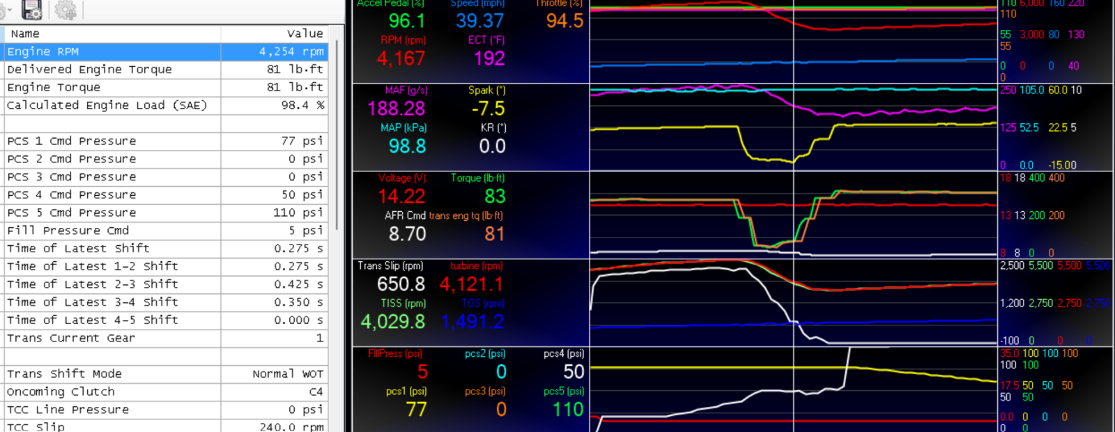

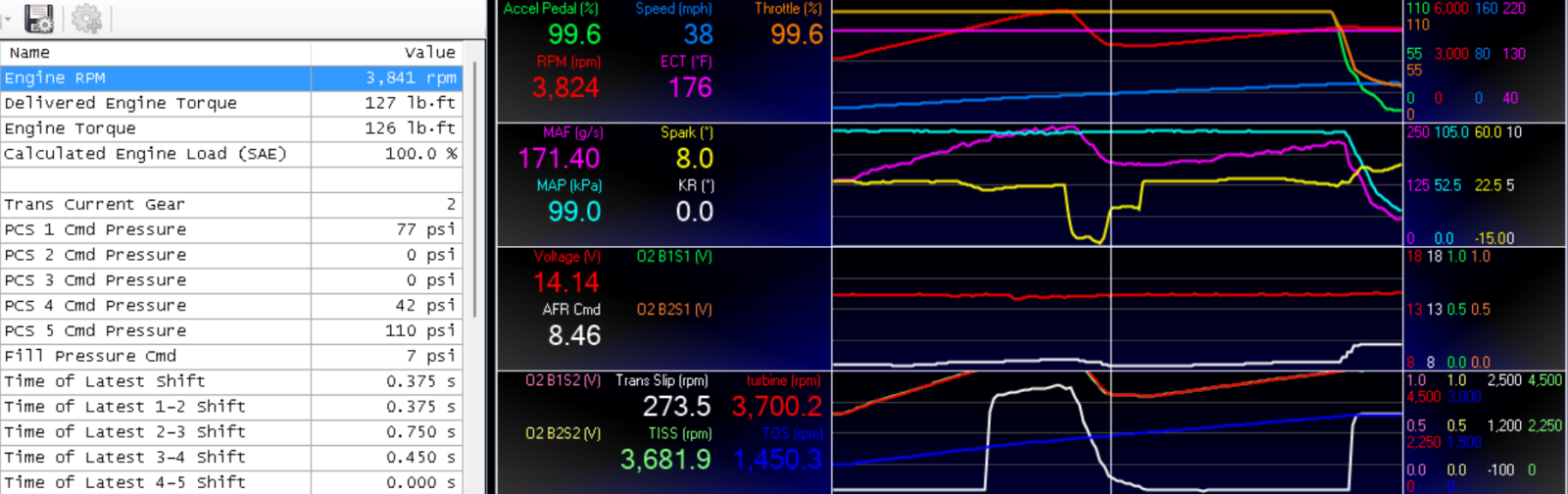

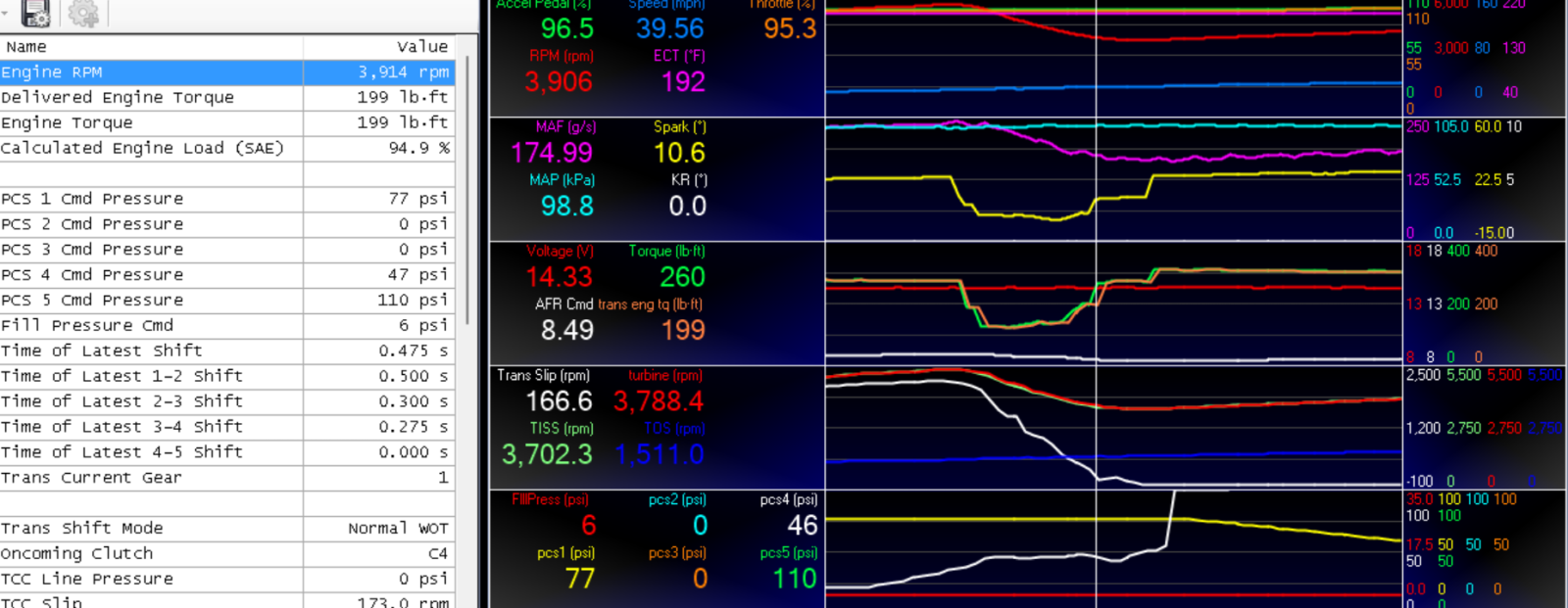

Did a couple Torque Management logs set to 0.7.
First, stock torque adders (.47s)
Timing only drops to -2.0 degrees! (vs -7.5 degrees) Total shift time .550 seconds.
Next, '18 torque adders (.37s)
BUT timing still drops to -7.5 degrees! Total shift time .450 seconds!
Reverted tune to the first one, verified timing only drops to -2 degrees.
The shift time upto that last timing step, is pretty much the torque adder setting exactly..
Aand the last timing step is almost always .10 seconds.. Perhaps the upshift torque reduction @LSxBakakos was mentioning? Or clunk reduction or tip in setting?
EXCEPT when I raised oncoming pressures a bit more, that last timing step is .20 seconds!
Timing dropped to -2 degrees. Total shift time was .650 seconds.
This one back to stock .47s torque adder, .475s shift time upto the cursor..(Previous graphs have cursor at minimum spark timing)
Of these tunes, I prefer the first one. The second one, while faster, feels like it pauses slightly, then drops into second gear. Like the abruptness of the torque graph.
I will be going back to stock pressures (Was running slightly upped settings from a 2018 tune). Also testing axle and clunk reduction settings before trying upshift torque reduction!
So far I'm pleased with .7 torque management. I don't notice any harshness at all. How low can you go before it's noticeable?

It just popped into my head now regarding your comment and the .70 tm
Last week before I switched back to upshift enabled I did try 70% as you did, and under part throttle it felt exactly as if it was stock. There was no bump/positive lurch during a gear change, so that was when I changed it back.
I hate to be a part of another forum however Im debating on joining hpt just for terminology and a definitive answer on trans functions

I didnt want to post a reply until I had figured out whats going on
First things first, ive been using adder modifier for my torque management ramp. So far -.55 off idle to the third to last column, then -.60(40%tm remaining for the last two columns which I think are 5000 and 6300?)
After scanning hpt forums theres an aussie guy called tre-cool that seems like an absolute wealth of knowledge. During some evidence on 6l80e shifting he mentioned shift times or "torque adder" aka shift time will help, but wont clean things up in full, that interia and oncoming all need to work together. He mentioned going into the oncoming pressure presets in the adaptives and while his values for heavy cars/trucks was 0:250kpa 1:550kpa 2:1200kpa where as other cars were a little heavier maxing out at 1700. I did 20% oncoming and offgoing or multiply 1.20 across the board 2-3,3-4 are super quick and decently firm, the 1-2 has been the laziest shift to which ive been sneaking up on. So im not going much further on the trans side. I feel like shift speed wise this has been the biggest change
As far as inertia theres one guy that posted his g8 tune and I realized mine somehow only changed up top at section 9 rather than the whole table. 0 should be left at zero, g8 was .250 1-8 stock then he changed #9 to .20. I realized this wasnt enough for my liking and its been blended from .20 down to .12 @9
Shift timing on mine has seemed to work best from .50 in the negatives, .44 at the 0/far left and bottom right (wot/high rpm) 6 tables set to .20 and interpolate between
Shift pressures ive brought down to 140 psi in max pressure and made sure the taper off in line pressure stayed constant/didnt fall off
Ive also realized until adaptives have been learning for 100mi wot is violent on the 2-3 so ive been avoiding doing so lol but I do hope this helps others out
