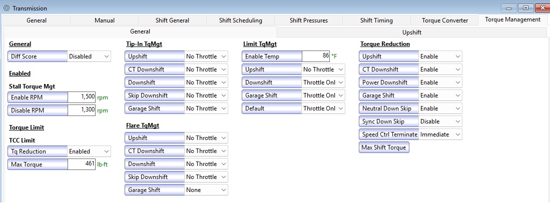

HPT: Trans > Torque Mangmt > Upshift > Torque Factor
The stock setting is 1.000
Dont know for sure, but just so youre included, from what I gathered it seems the table below factor is what adjusts torque management percentile

Got a few miles today. About 15 ish.
Anyway, Trans is shifting great. Town driving you feel the shifts but not even close to hard or too fast.
Floored is a lot faster shifts and as soon as the shift is done its back on the power. I really like how it is shifting now.
Im sure there are a few more little tweaks to make but going to give it some a few days before deciding.
Before i reset the adaptive the changes i had been making we're giving me small changes and i thought would improve as the trans learned the new programming.
Resetting the adaptive made all the difference. Guess i should have paid more attention to some videos.

I think what would make that faster is TM-General-TR- Speed Ctrl Terminate, changed to Immediate.
It was much more noticeable after i did the adaptive relearn.

All solid to hear!! Also what year is yours? On my 14 I cant find the speed cntrl anywhere

07. That might be an HP tuners version difference. I'm using the latest version.
