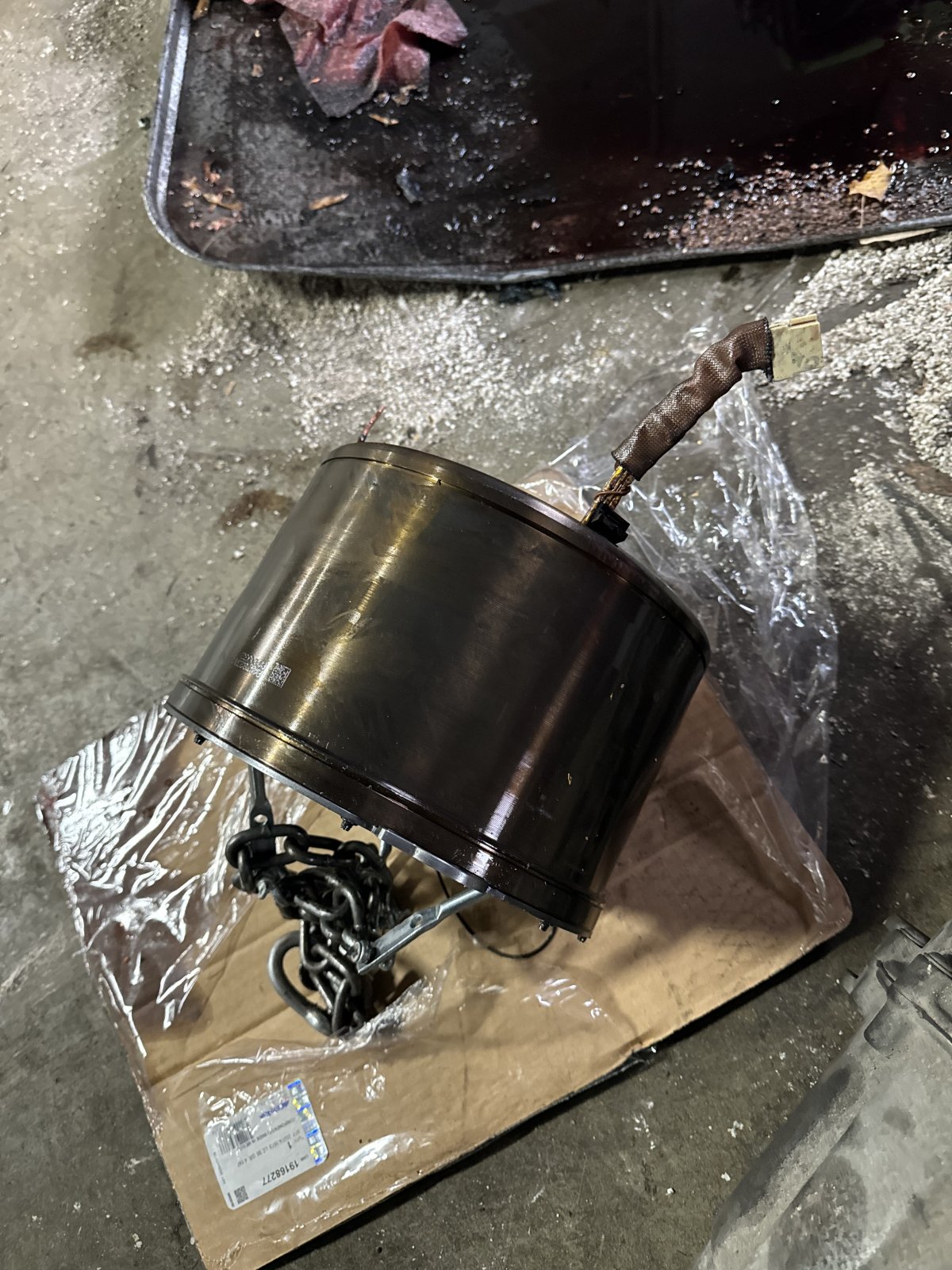

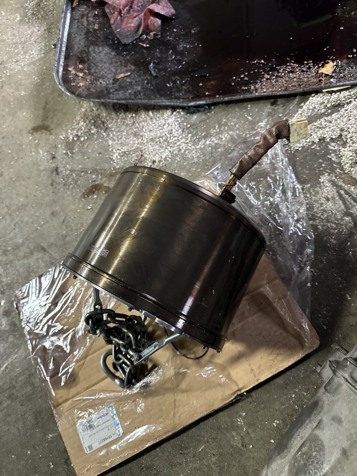

It’s just a hoop with three hooks and a place to put a chain. Got some hooks and connectors to make the same thing with a chain. Ended up having to wedge the casing under a lift arm to hold it down while using a cherry picker to add tension, while tapping the casing with a rubber mallet where it connects to the bell housing. Got her out though.

View attachment 417292It’s just a hoop with three hooks and a place to put a chain. Got some hooks and connectors to make the same thing with a chain. Ended up having to wedge the casing under a lift arm to hold it down while using a cherry picker to add tension, while tapping the casing with a rubber mallet where it connects to the bell housing. Got her out though.
A baby is born...

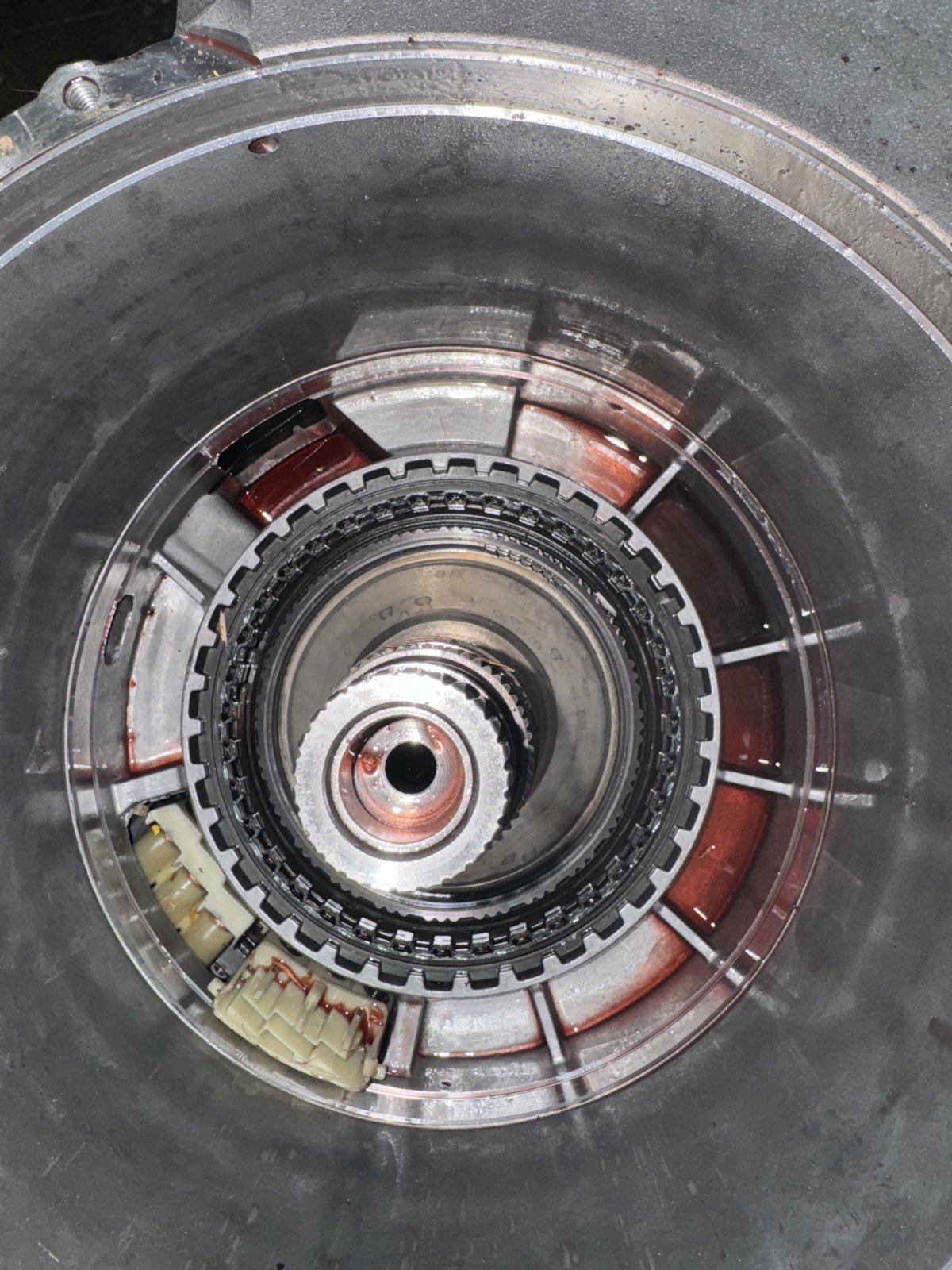

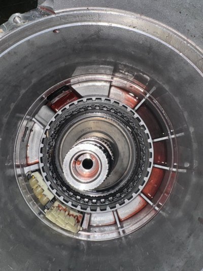

Clutch discs were fried, also the sun gear planetary system pins were torn up and fell right out as well as the the locking spacers. They are hard to find, a used transmission shop here in Portland had a 2ML70 used in the warehouse, they are pulling the assembly for me to see if I can rebuild from that. Otherwise it’s 550 at SMC performance for a new unit. After that I should be able to finish and seal the transmission and get her back in.

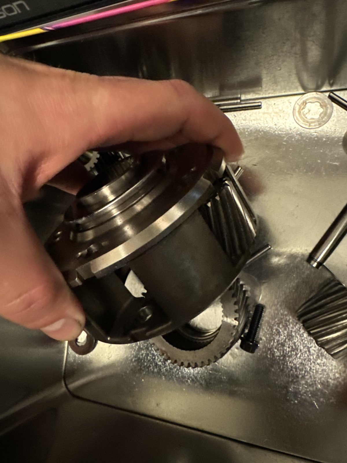

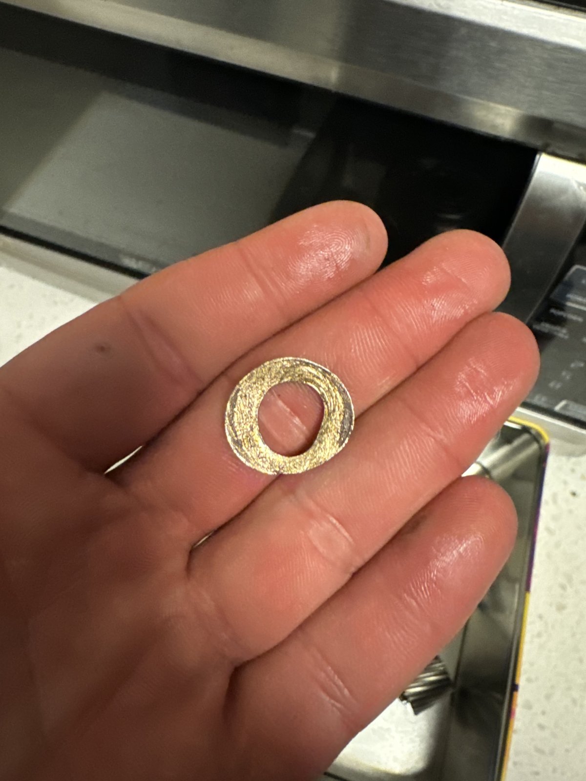

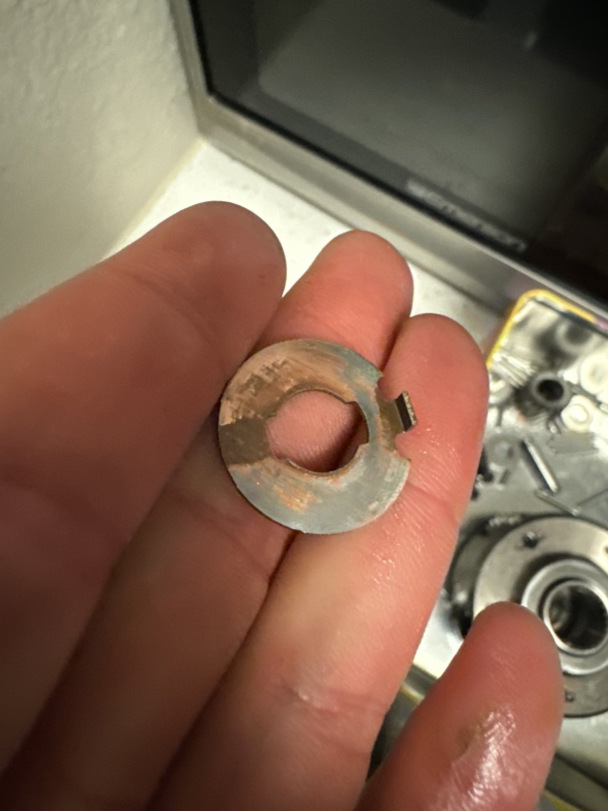

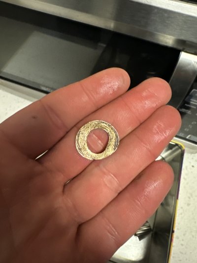

First picture is what the retaining washer is supposed to look like, second one is worn. Sonnax is a parts company that has a sister company in Portland (Transtar) who had the 2ML70 washers on their website. Sonnax also said they had them, but differed me to transtar.
They didn’t have them and after taking measurements, they are close to the same first position planetary assembly in the 2L60e but slightly longer. Conveniently next door was a used transmission shop that also partners with transtar. They happened to get a 2ML70 a couple weeks back and pulled the whole assembly for me. It is also worn pretty bad in spots, but does appear that I will be able to refurbish something out of both sets.

The one he had that fell apart was the second assembly, mine looked used but not falling apart the washers all have the retaining tabs in place
