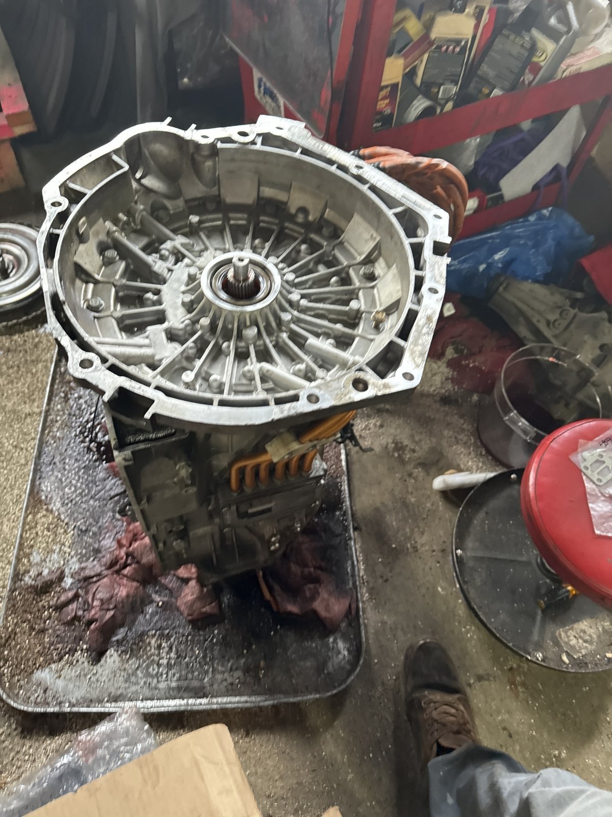

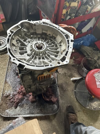

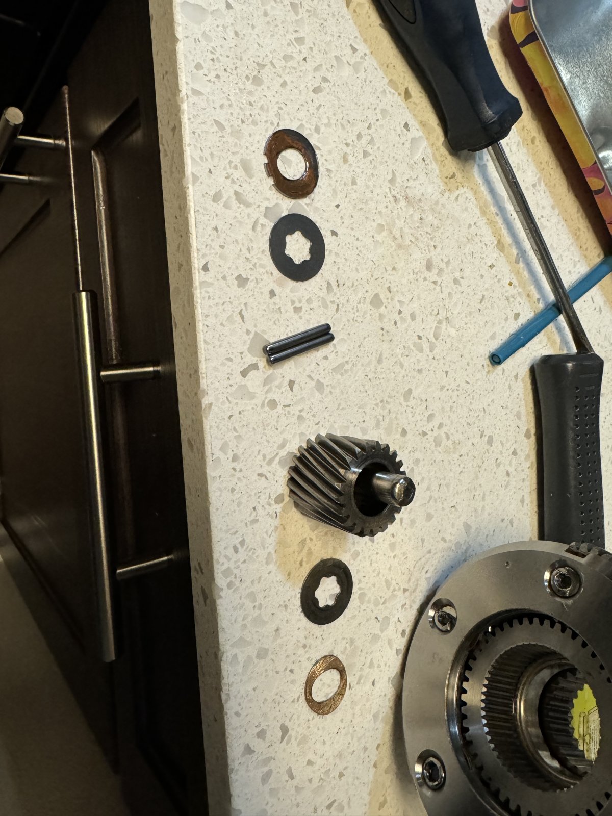

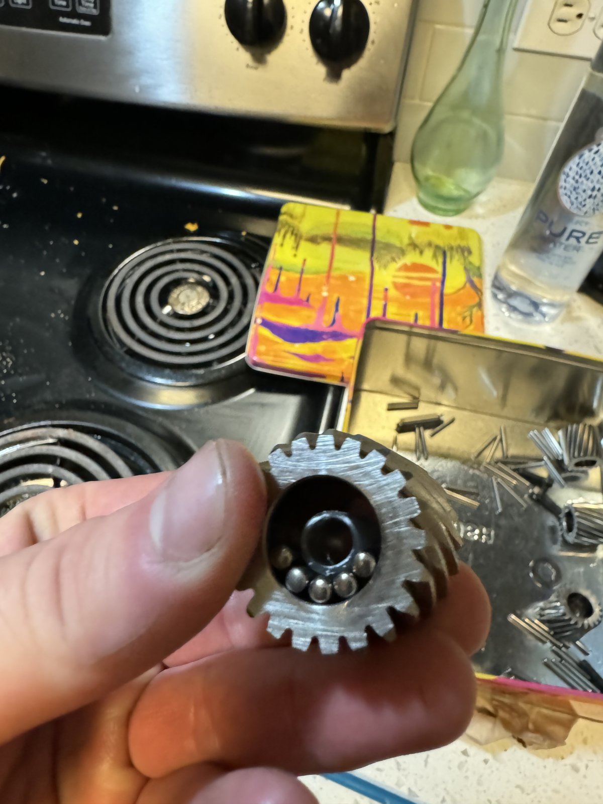

First picture is what the retaining washer is supposed to look like, second one is worn. Sonnax is a parts company that has a sister company in Portland (Transtar) who had the 2ML70 washers on their website. Sonnax also said they had them, but differed me to transtar.
They didn’t have them and after taking measurements, they are close to the same first position planetary assembly in the 2L60e but slightly longer. Conveniently next door was a used transmission shop that also partners with transtar. They happened to get a 2ML70 a couple weeks back and pulled the whole assembly for me. It is also worn pretty bad in spots, but does appear that I will be able to refurbish something out of both sets.
ahh I see. yeah that's definitely pretty hurt looking. I'm in no way a tranny guy, just rebuild lots of manuals in the past. do you think the hard part wear had anything to do with the clutchs going out or just a side effect? like would this worn spacers cause the gears to get eat up at some point?

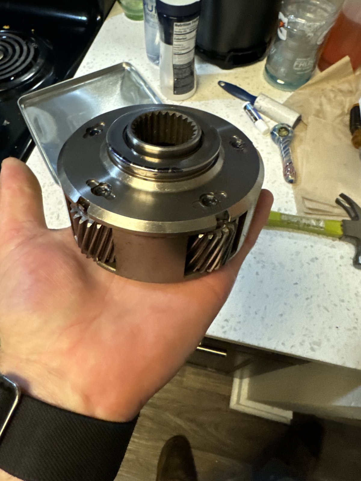

Update: I was able to refurbish the front/first planetary assembly with the one pulled from another used 2ML70. Sonnax makes steel single tab retaining washers for another system, I wasn’t able to find any in stock on the west coast and they are a week delivery from order date. I ordered some to measure and see if they are a viable replacement, but I had to get the Tahoe back on the road sooner than that so stuck with the used copper ones. Also cannot find copper new at all, you would havebto buy a used or new full assembly otherwise to my knowledge. Second photo shows the needles going back into planetary gear, they have to be arranged along the inside of the gear, and as it turns out the pinion that Secures everything through the middle of the pins is roughly the diameter of Bic pen. I cut a small piece of the pen off and used it to arrange the pins around with the thrush and retaining washers on top and bottom of the gear and slid it into the assembly housing. It was then very easy to keep everything aligned before pushing the pinion through and moving the piece of pen out. The third photo shows the order top to bottom of how they gears slide into the assembly before being secured with the pinion. (orgive me the lack of spare copper washers have them shown as the worn ones that were left over. I will be finishing the reassembly and sealing the transmission tomorrow. Unfortunately there are no bell housing to case gaskets to be found anywhere I can see, so I’m using the permatec transmission gasket DIY seal. It will take 24 hours to dry the seal, and I will reinstall the earliest I can get a lift after that.
Here is the link to the steel thrust washers, you’ll have to track them down from a vendor of theirs

View attachment 417867 Update: I was able to refurbish the front/first planetary assembly with the one pulled from another used 2ML70. Sonnax makes steel single tab retaining washers for another system, I wasn’t able to find any in stock on the west coast and they are a week delivery from order date. I ordered some to measure and see if they are a viable replacement, but I had to get the Tahoe back on the road sooner than that so stuck with the used copper ones. Also cannot find copper new at all, you would havebto buy a used or new full assembly otherwise to my knowledge. Second photo shows the needles going back into planetary gear, they have to be arranged along the inside of the gear, and as it turns out the pinion that Secures everything through the middle of the pins is roughly the diameter of Bic pen. I cut a small piece of the pen off and used it to arrange the pins around with the thrush and retaining washers on top and bottom of the gear and slid it into the assembly housing. It was then very easy to keep everything aligned before pushing the pinion through and moving the piece of pen out. The third photo shows the order top to bottom of how they gears slide into the assembly before being secured with the pinion. (orgive me the lack of spare copper washers have them shown as the worn ones that were left over. I will be finishing the reassembly and sealing the transmission tomorrow. Unfortunately there are no bell housing to case gaskets to be found anywhere I can see, so I’m using the permatec transmission gasket DIY seal. It will take 24 hours to dry the seal, and I will reinstall the earliest I can get a lift after that.
such good info and pics.. I hope you can get that front motor back in. being a big magnetic does sound like a nightmare.

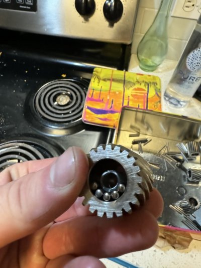

Took a little finesse with the trusty rubber mallet but everything is back where it belongs. Can’t get a lift until Monday and Tuesday to install back in the truck.

that's cool. I don't think it's much of a stretch to say you're one of the only if not the only one to diy rebuild one of these. I'm pretty sure you've done what a tranny shop couldn't or won't do these days. sourcing the parts didn't seem very easy.
looking forward to you getting it in the truck and what you think.

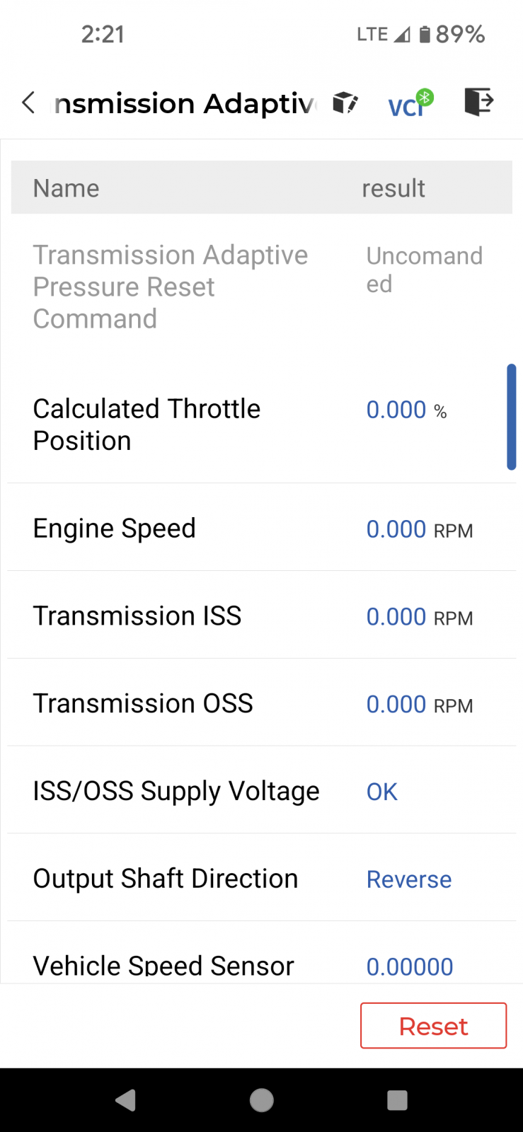

if he means the trans daps reset, or whatever it's called. I have seen them on my clone tech 2. (there's always a map on this board of guys with a tech 2 that if you happen to be close are willing to hook up real quick and help each other out. possibly you're near one? I'm was down south.
I also have a cheaper Bluetooth dongle that very well might have the option. I'll check tonight. it's has a tons of the 2 way tests and stuff. like 65$ off Amazon.
if he means like reflash the module with an updated gm software or something. yeah, dealer for a one time charge might be the quickest and easiest. there's a 100 page thread around here about doing it with the clone gm software and it seems difficult.

It doesn’t need to be flashed with new software, just needs to go through a relearn adapts process to know where the clutches are and purge all the air from the system. No sensors or control units were changed so nothing needs to be flashed.

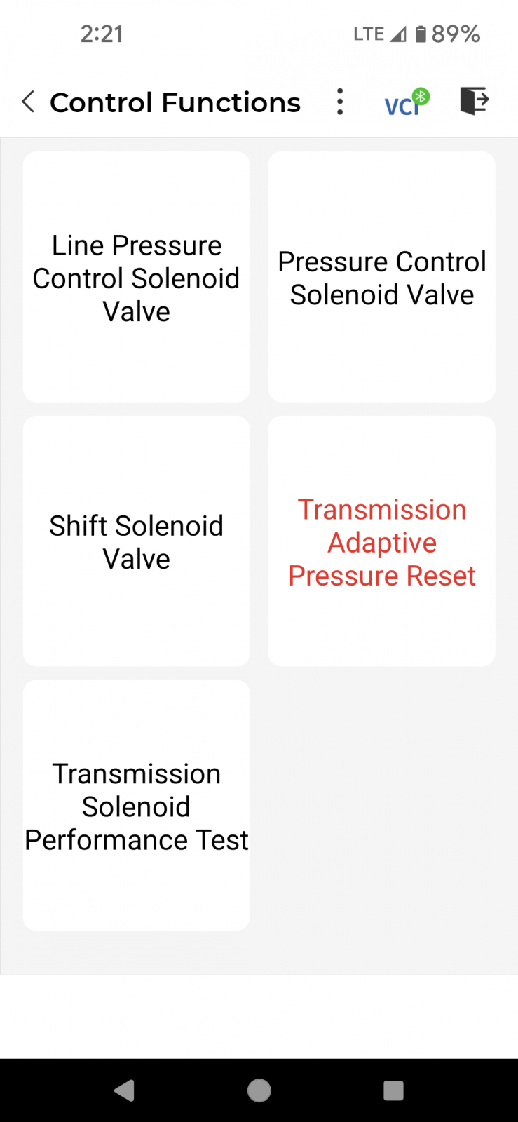

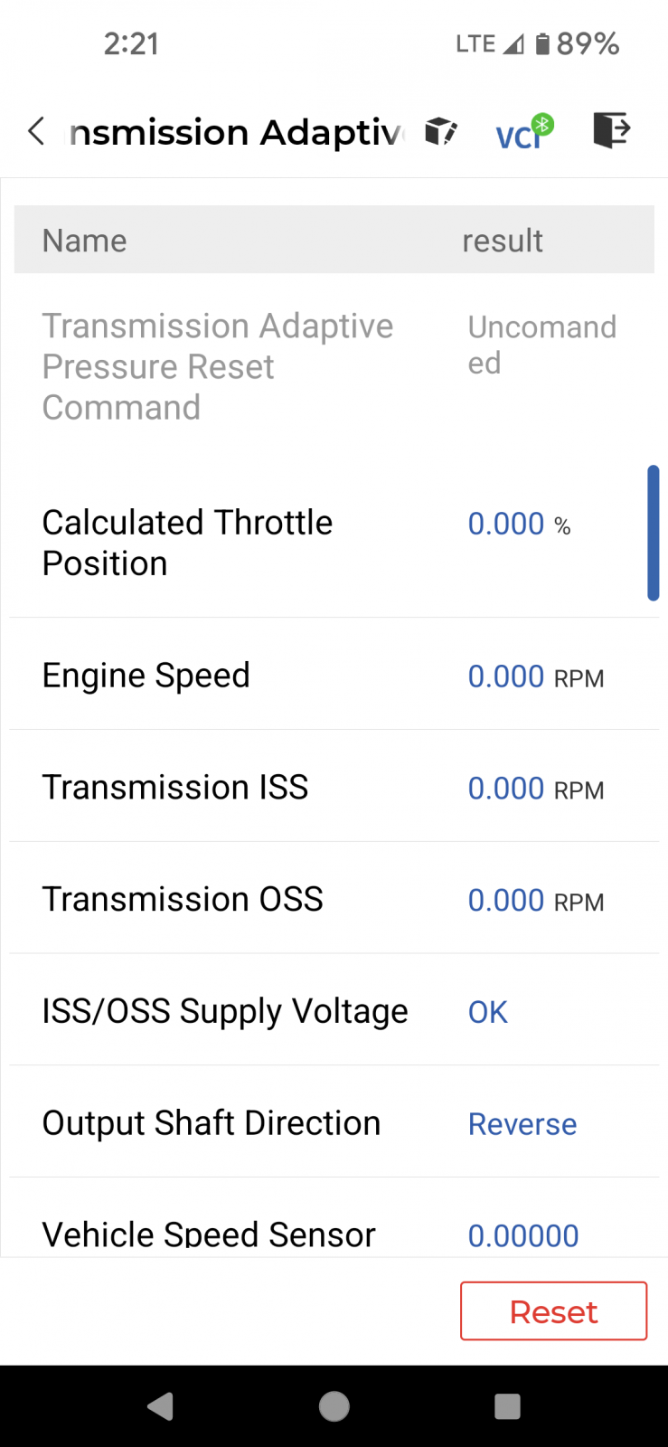

I don't have my yukon with me but I just checked my 2014 volt with the little topdon blue tooth dongle and it shows trans adapts reset option on it. I won't t be able to check the yukon till late tonight to make sure on that if you want me to, but if it has a volt. I'd bet it does, it had a 20$ off coupon when I got it. don't know if it still does and only shows up once, but one day shipping if you need it. does all the hybrid stuff too. seems handy enough to me to keep even thou I have a tech 2 as well.
just a thought if you're in a hurry for cheap and can't borrow one.

Amazing! I’m buying it right now. That is awesome, the manual says thart the car let the transmission warm up then cycle through every gear selection for 3 seconds each 3 times starting from the bottom to clear air bubbles from the clutches, then reset transmission adapt. Then I should be good to go since it supposedly measures clutch sizes and all. It claims it will tell me if something is installed incorrectly…. We’ll see I guess

man, I gotta apologize. I looked all over just now, and nothing about reseting the trans adapts. I thought forsure if it had it for one obscure hybrid, if would have it for this one too.
hopefully you can cancel your order, or just easily return it. that's a shame, I hate giving bad info.
you may try emailing them and asking if one of their wired scanners have it.
