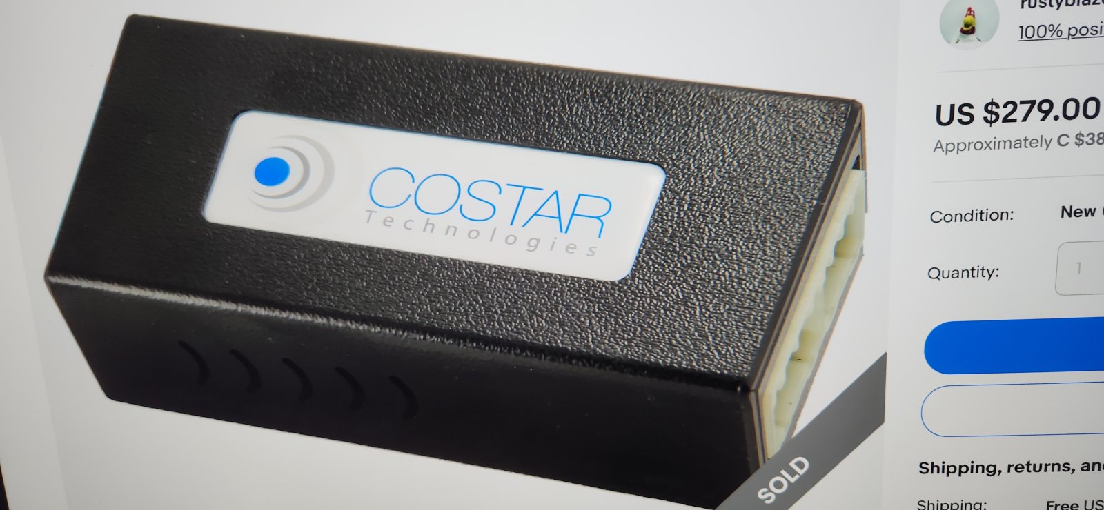

I was about to start searching for a Bluestar module, lol. Anyone have a picture of one in case I run across one in the junkyard?
I have the very last module…. ( I spoke with the company… They said they had one left. ...I got lucky )..
The OnStar box is behind the glove box. All’s I had to do was unplug the OnStar box and plug in the BlueStar II.
Plug -n—play. It uses the OnStar system, ( steering wheel buttons, Mirror LEDs & buttons and the factory radio into a bluetooth to your phone . I only had to pair my phone to the radio…. That’s it !!
If someone is lucky enough to find one, let me know….. I have the instruction manual that came in the box. ( You can probably find the manual online also )
