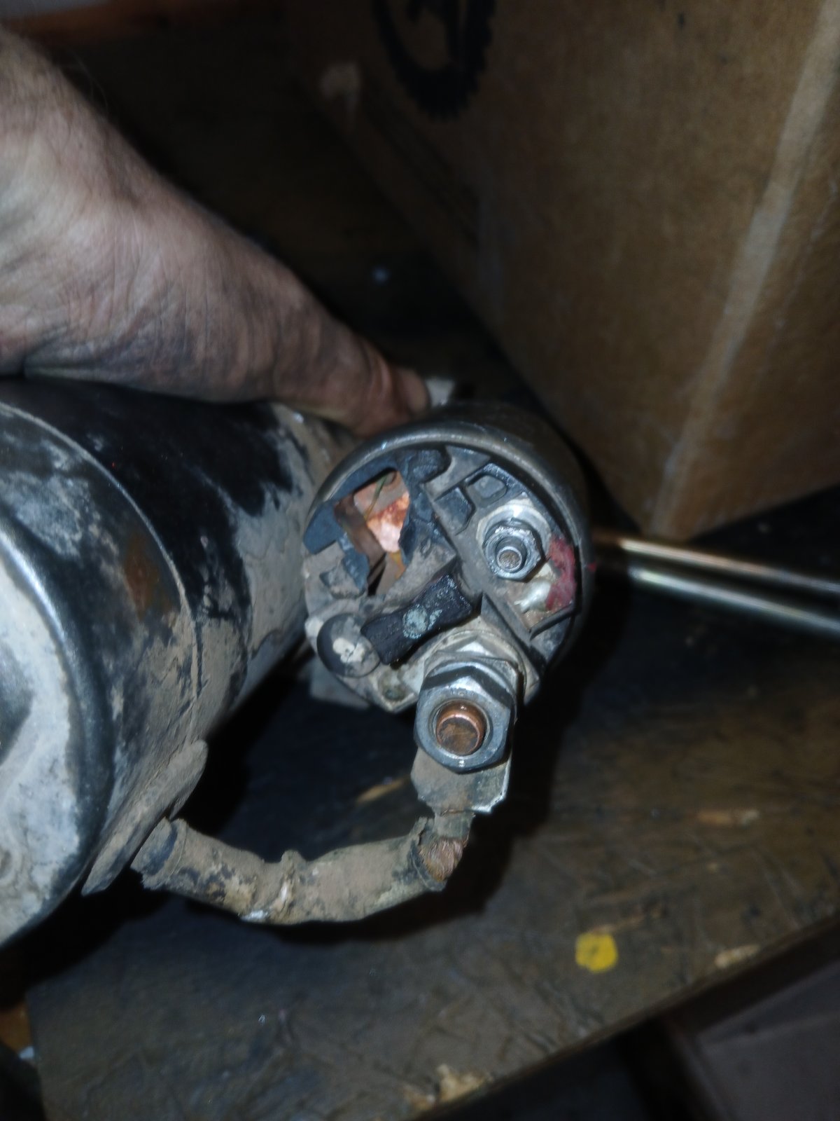

I blew my transmission. I'm slowly removing everything so I can drop it out and rebuild it. In the process is damage the starter *ug* I've tore this little guy down before but never replaced the solenoid. Now I have to the solenoid broke trying to remove it.
Busted solinoid

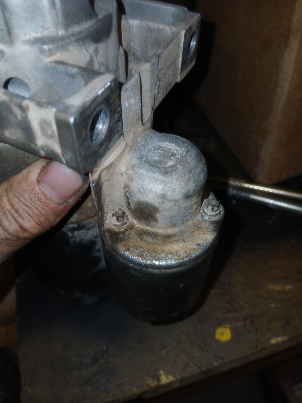

Issue is I have no clue what size this socket is. I have down to an E6 and it's smaller. Additionally, there's little if any room to fit a socket. Anybody know how to get these pesky little fasteners off?
What size is that fastener??? I'm going to need to buy a tool for that...

The socket would be a female torx and likely like an E 5.5 or E5. The ends of the existing ones look screwed up. Whatever you put on there is just going to slip off when torque it.

An E5 socket fit my TYC solenoid bolts..

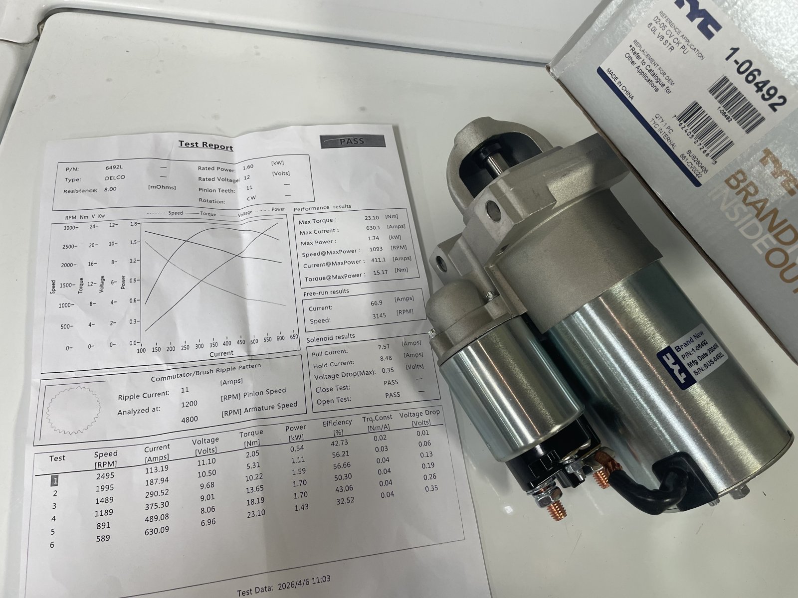

I just bought the 1.7kW TYC starter for $85 (looks to be the same as wai global or terrepower at $80)
I did purchase a Delco Gold starter for my gmt900 before... (Not sure if a 2.0kW or 1.7kW)
But it looked like any other generic starter, not like the photo on RA, and 2x the price...

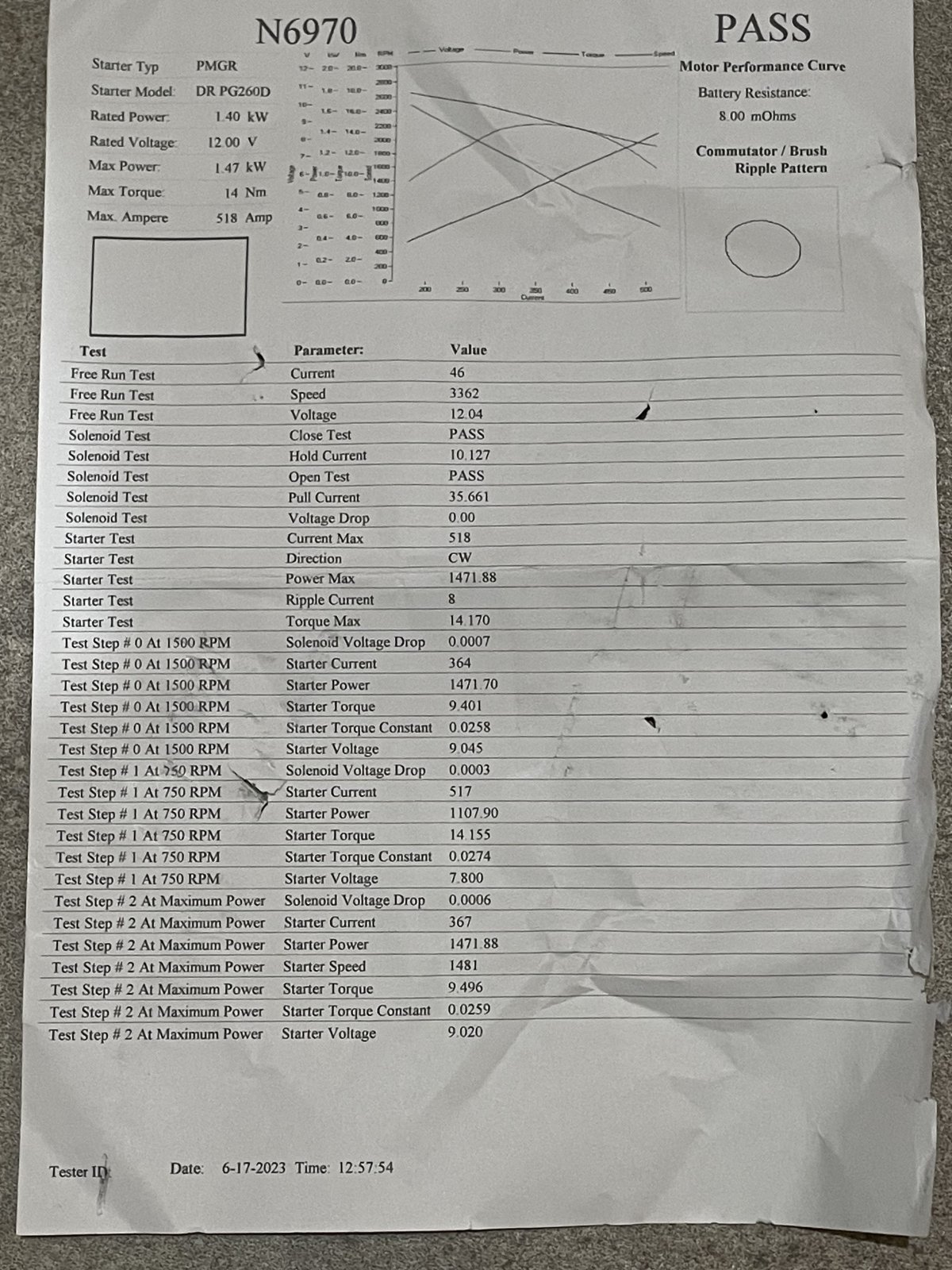

I'm not sure if my brush/ripple pattern is good?
I thought a Remy starter I bought before had a smooth circle...
But the Remy starter would not bolt in because the spacing was off a tiny bit..
Remy 1.4kW starter I returned... (for 5.3 gmt900)

@mikez71 awesome thanks, an E5 socket.
