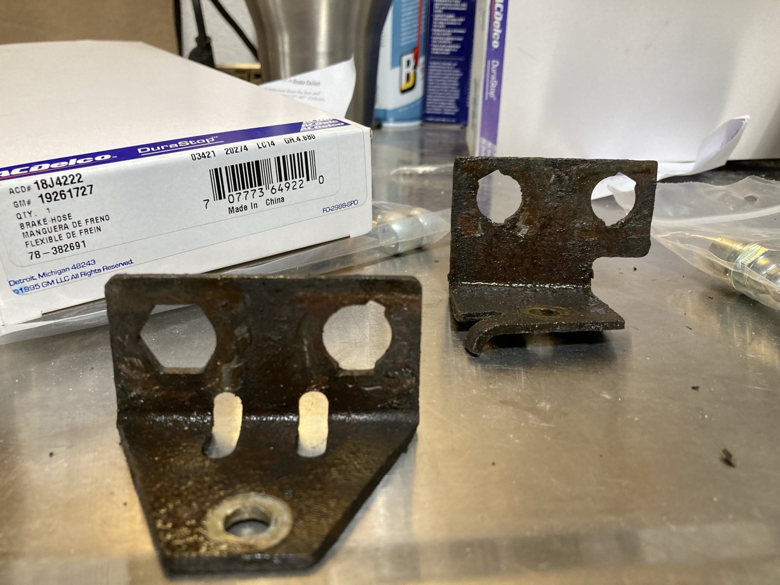

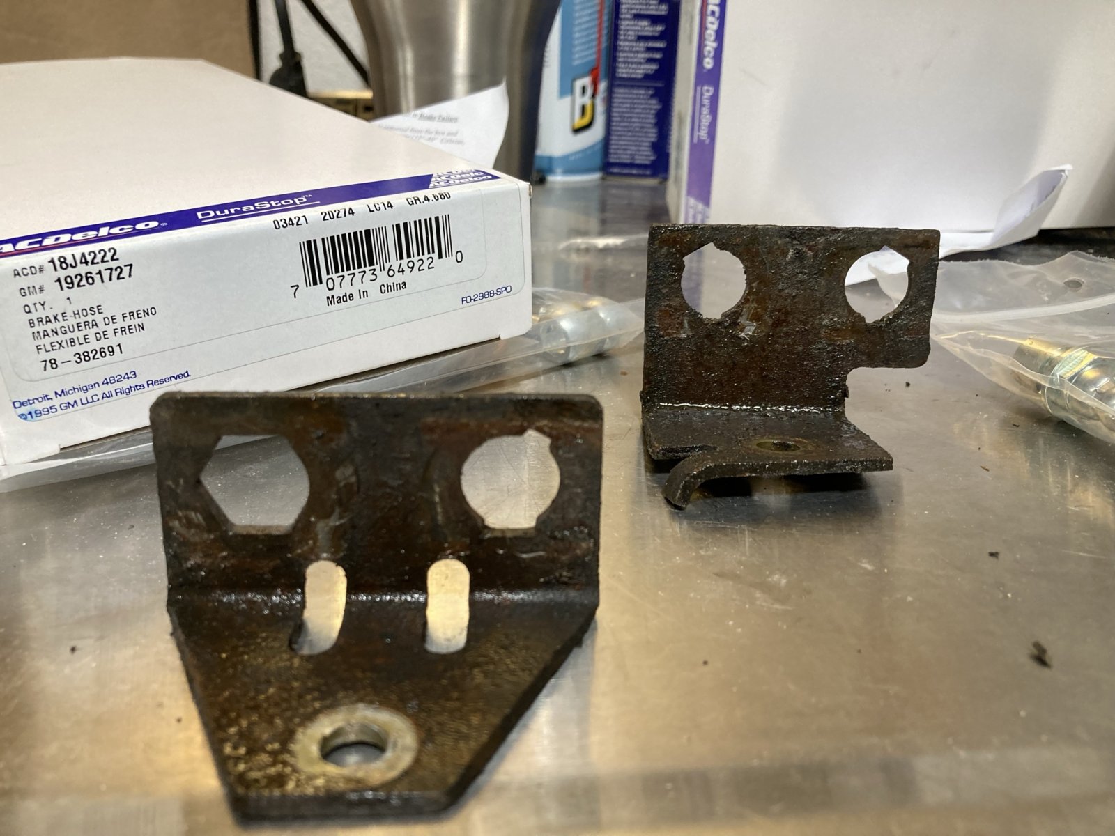

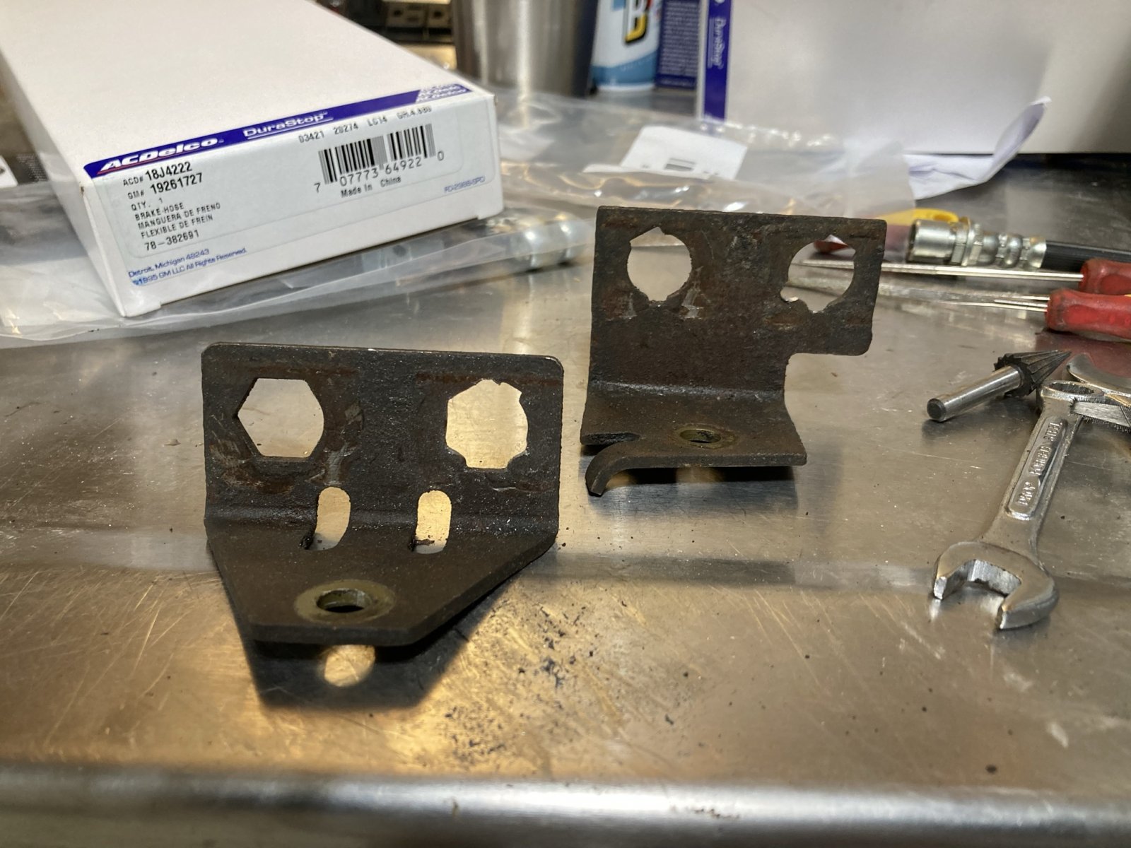

Speaking of fun with center rear lines, I finally replaced mine. I’d ordered stop tech SS lines before I’d heard of he goodridge line fix. Didn’t put them on the same time as my fronts because the bleeders on the rear calipers snapped off, so I got new calipers all the way around now too. On the center rear lines I figured I’d just put on new ac delco lines. Rock auto only lists one line from ac delco, for active brake control / stabilitrac. Most other brands also only list one line, so I ordered 2 ac delco 18J4222 lines
Here’s the mounting brackets…
…so the locating slots are different for the center right vs center left. The 18J4222 is a center left, and rockauto doesn’t list a ac delco center right, and I don’t know if they even make one. It looks like centric is the only manufacturer of rubber lines rock auto lists with 2 different part numbers, calling it 15” and 15 1/2”, looks like 15066404 is their center left, and 15066358 is their center right. The stop tech lines I installed at the 4 corners don’t use the locating slots, and I’m guessing other SS lines might avoid this issue at the center lines as well.
So I went to orilleys, figured I could get the right line for $10-15 there…. They had a similar listing as well, only one center line for stabilitrac. They also listed a gm 2 line assembly with brackets for $154 plus shipping plus tax, and in 2 days they could hear back how long it would take to get…
So I went back home and started grinding…
that’s all it takes to use 2 center left lines. I guess gm didn’t want anyone to accidentally cross the lines. If you do end up grinding yours, be mindful of the orientation so that the line isn’t twisted, the lower end I thought was just a hex at first glance, but it’s not.
anyway… finally driving on SS lines at all 4 corners, and new rubber center lines. The brake pedal is now almost weirdly high and firm, but I figure that’s a good thing.

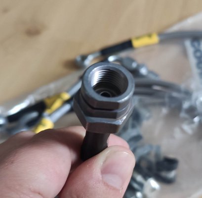

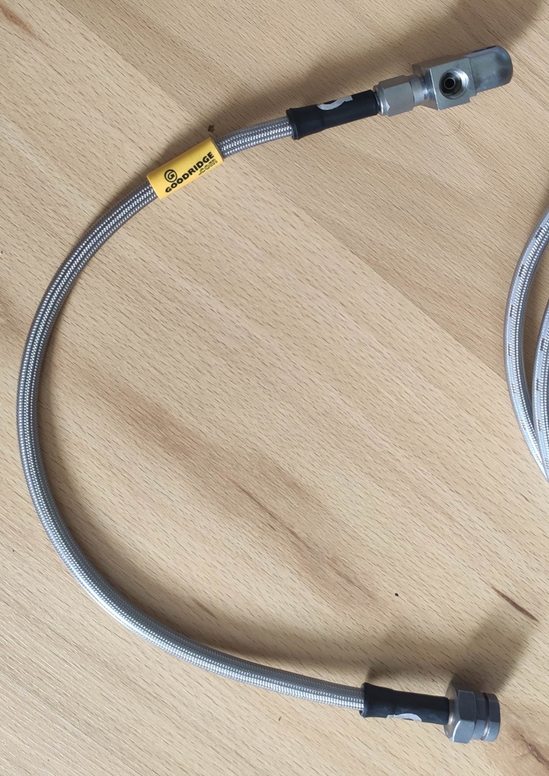

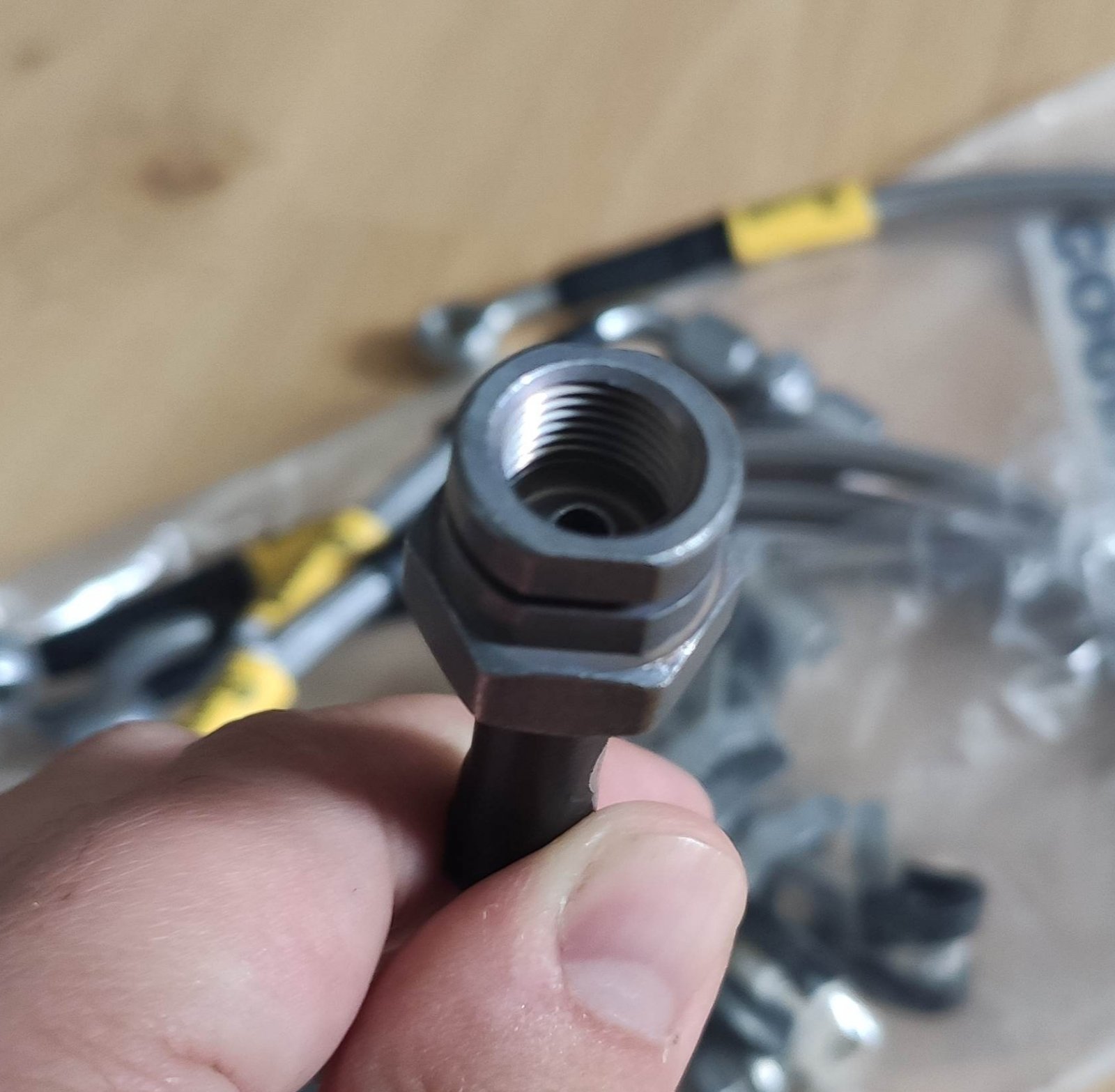

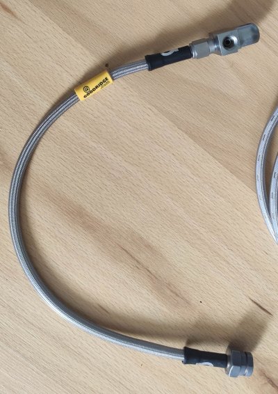

Anybody knows when Goodridge started to make fixed rear center line?
Here is photo of mine set(bought 2years ago).
Did I have the old one?

I don’t know what thread it was in, but doesn’t sound like they changed the lines. They have little conical washers they include now, and sounded like someone contacted them and they’ll send them out to you if yours didn’t include them
treehan77
TYF Fiend
Feb 1, 2015
1,446
1,216
Crestview, FL
It was me, just a month or two ago. Yes, they send you a tiny little washer with no instructions. It still leaked for me, PITA to try and get the washer to stay in there and pray it lines up etc. I ended going back to oem for all my brake lines. The center SS still leaked, because the threads themselves were boogered up. I hated the janky way to mount the front SS that is included. Highly recommend you remove the front brackets from your old lines and make them fit the SS lines- that isn’t exactly easy though. The 4 non center lines were fine, really. I just got tired of messing with it.

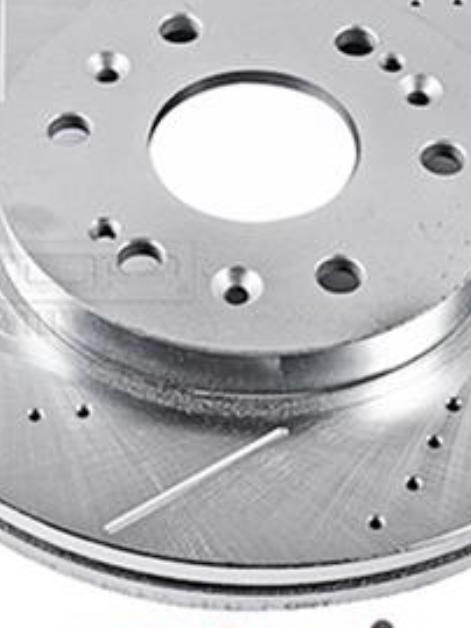

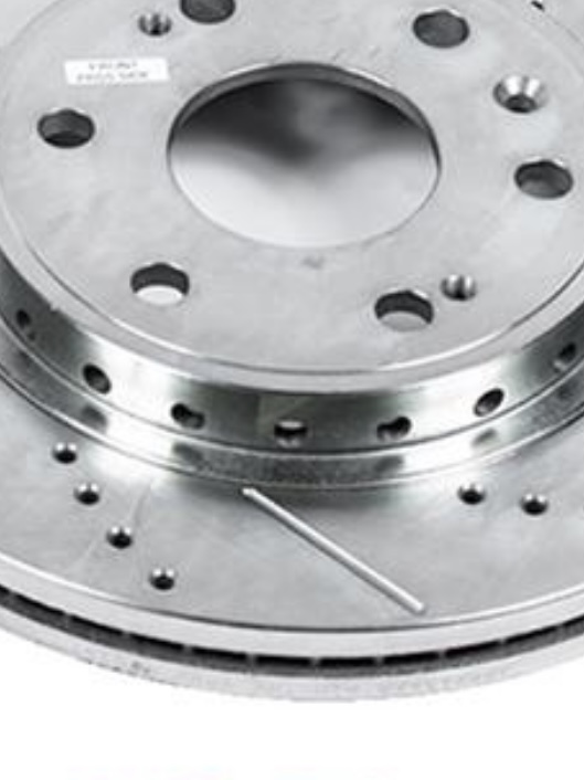

Can anyone tell me the difference between the front brake kit by PowerStop KC2069 and KC5519? 5519 is the Police version and $50 more for the kit but the pics on PowerStop look the same.
ks03
Fool Excess Member
May 3, 2019
307
299
2069 regular rotors
5519 cop rotors w/speed holes
