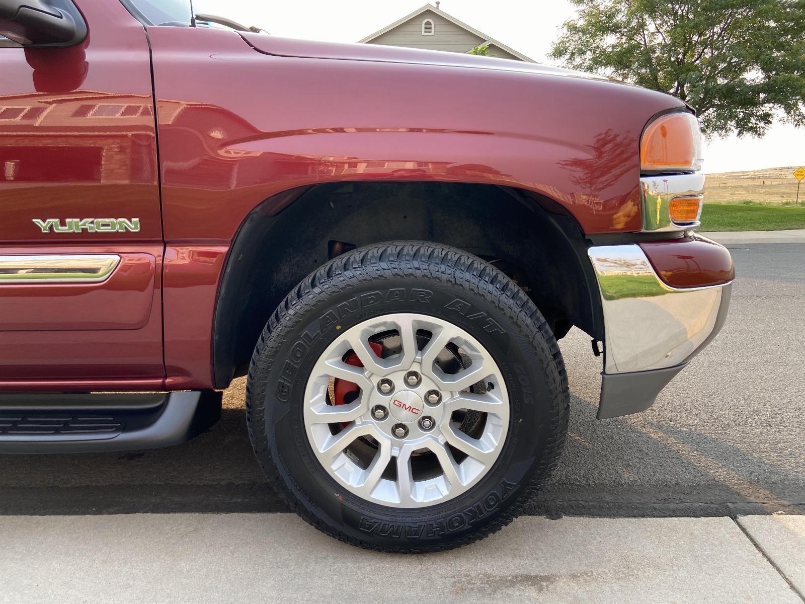

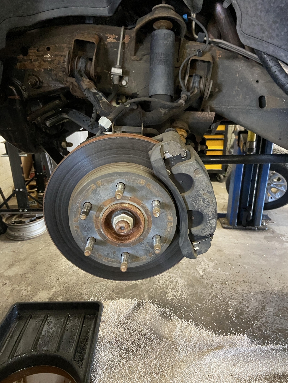

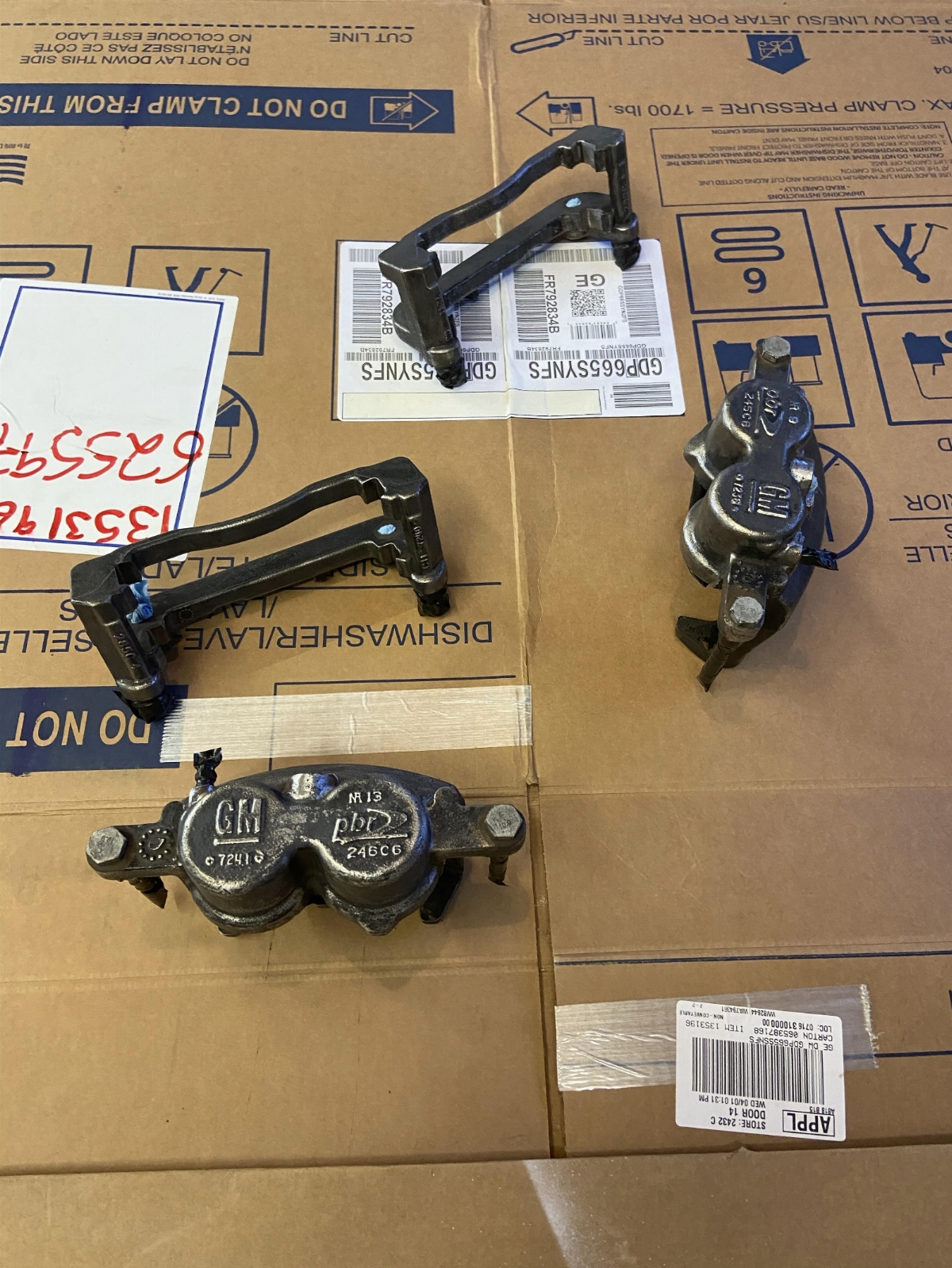

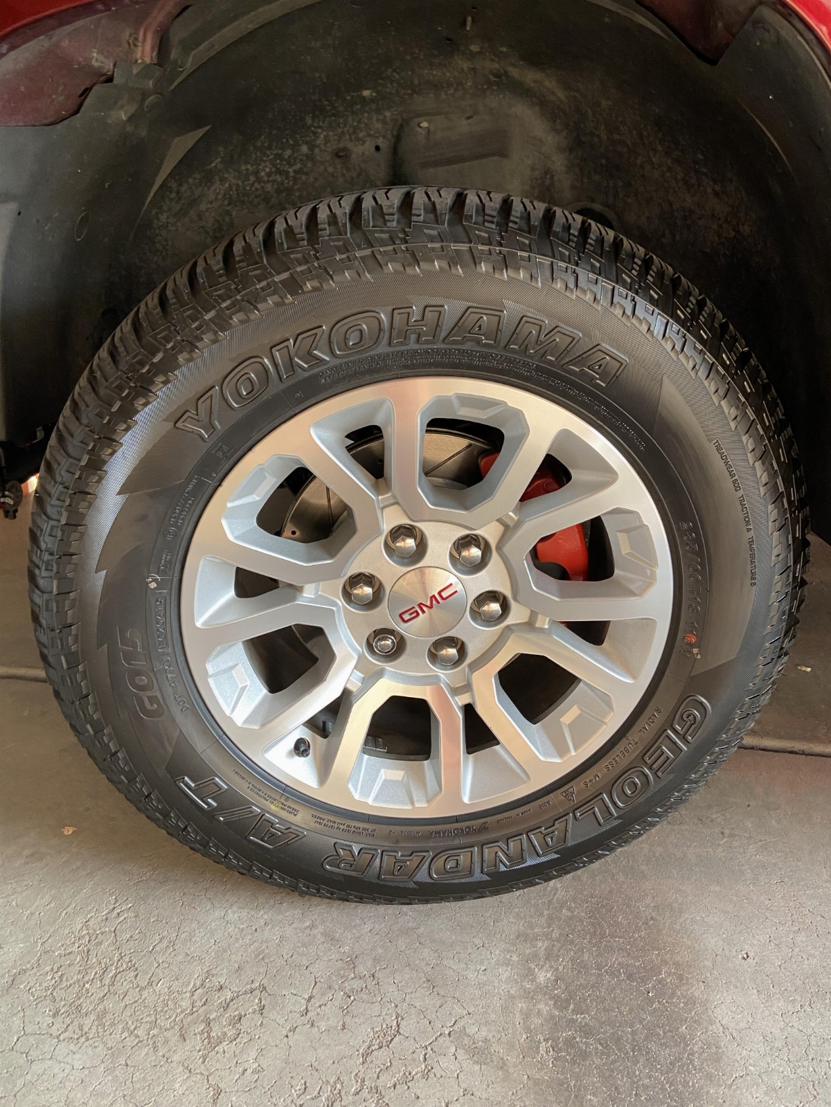

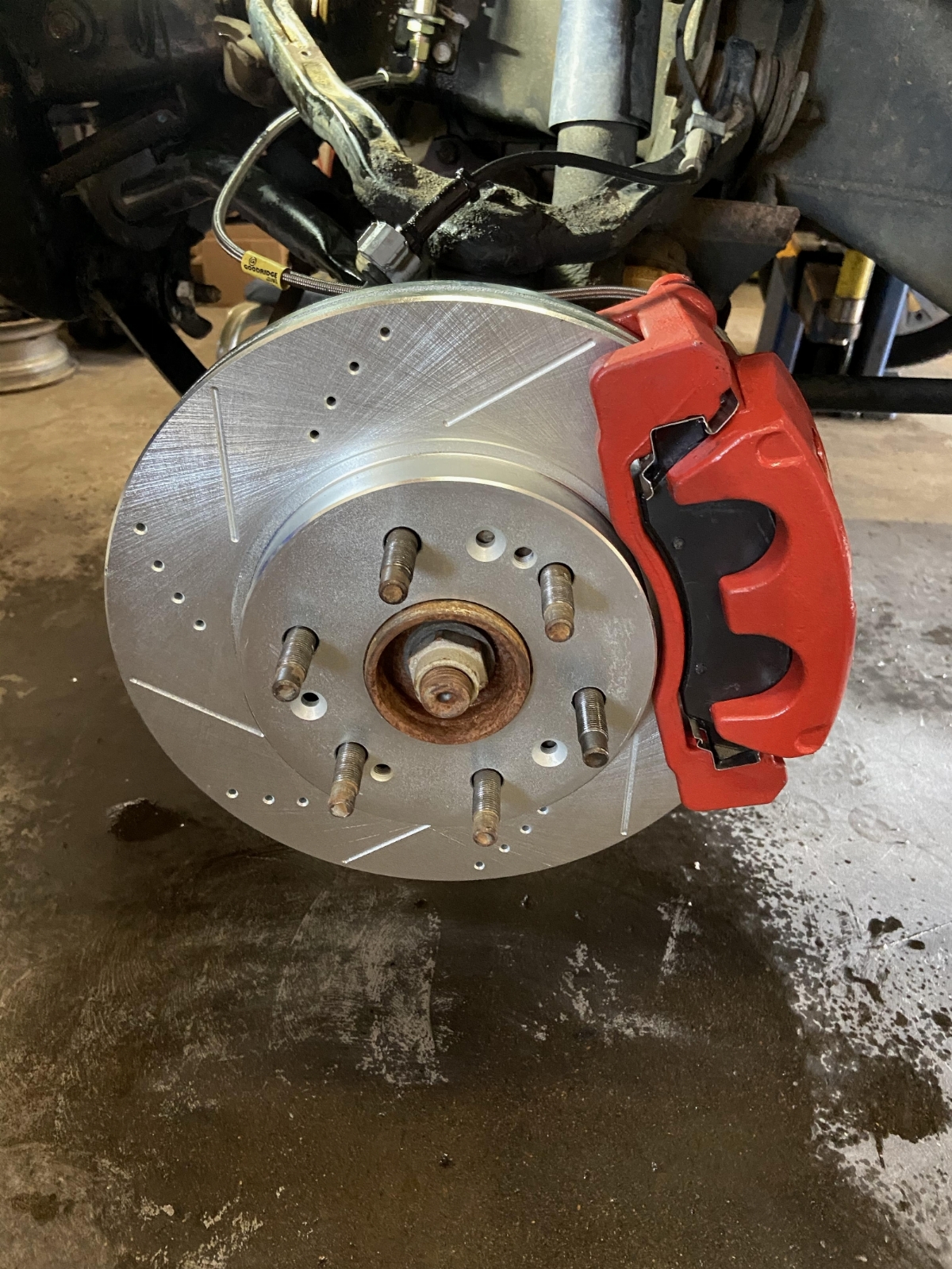

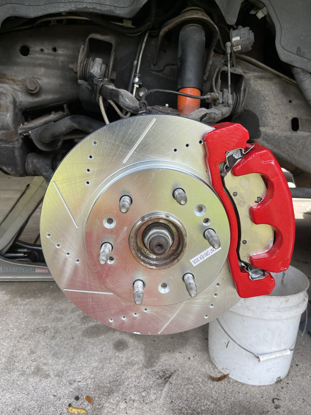

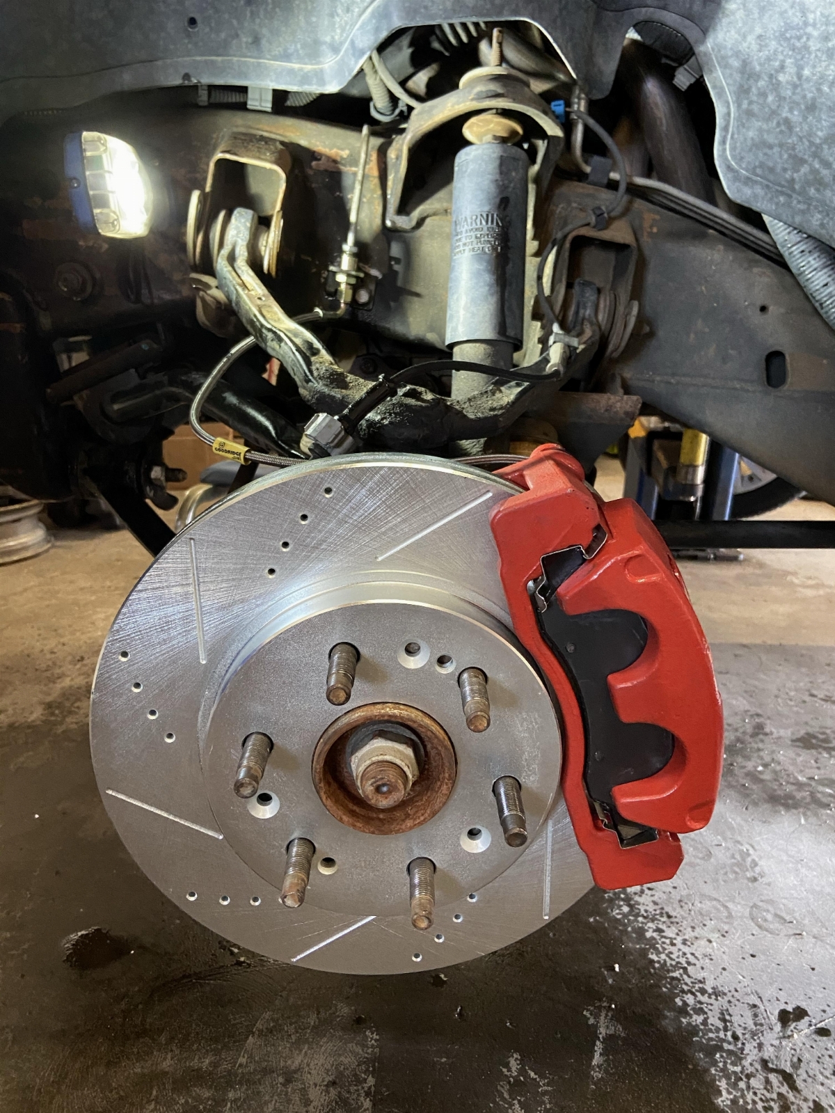

Weird was a screen shot of the website and the kit. Must have stripped it, I have successfully installed the Power Stop PWR-KC2067-36 kit for an 2007 on my 2005 Denali. The SS lines from Russel was fun, very stiff but was cold out so didn't help. But wish they had the same brackets as original and a little longer so could route them like the original lines. Here couple pics, to note i do have swapped rims and they are 20s, so no problem with clearance but don't think would be an issue with the oem rims.
View attachment 267803 View attachment 267804 View attachment 267805
I just removed the rubber hose from the brackets and used them on the braided lines (used a piece of vacuum hose around it in the bracket). Worked great.

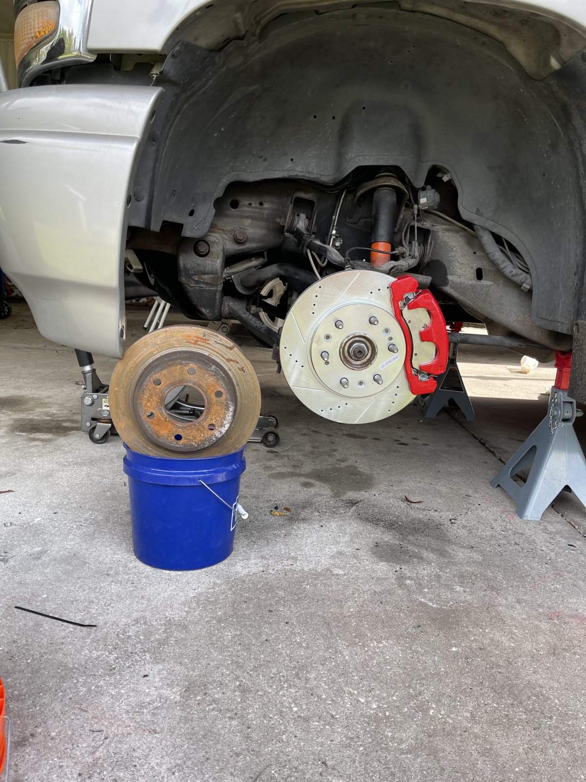

Just want to add: I’ve had my NNBS upgrade on now for a couple months, and it’s absolutely worth it. Braking is MUCH better! Definitely a worthwhile upgrade, and I also recommend going with a set of stainless braided lines.
And the install:
