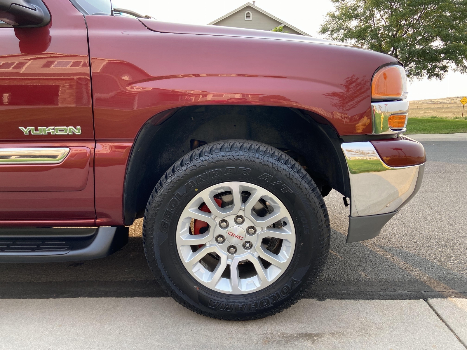

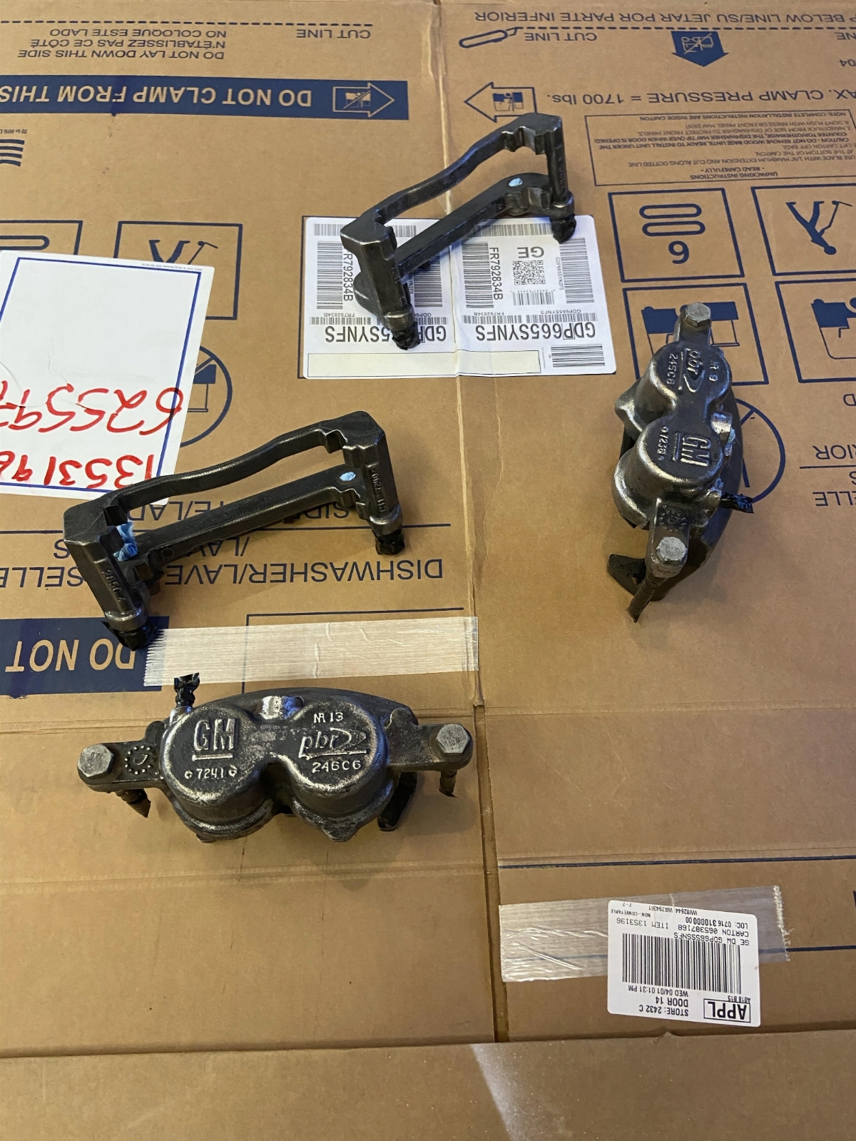

I purchased the Powerstop brake kit CRK 2067 for a 2007 GMC Yukon from Rockauto and I got the calipers and brackets off a 2007 Denali from the local salvage yard for cheap. Also, I replace the rear setup with Powerstop rotors and Gm Delco pads for a 2005 Denali as well. Overall I would say the stoping power is considerably noticeable and now I can actually come to a screeching halt as before I could not. So to me it was worth it.

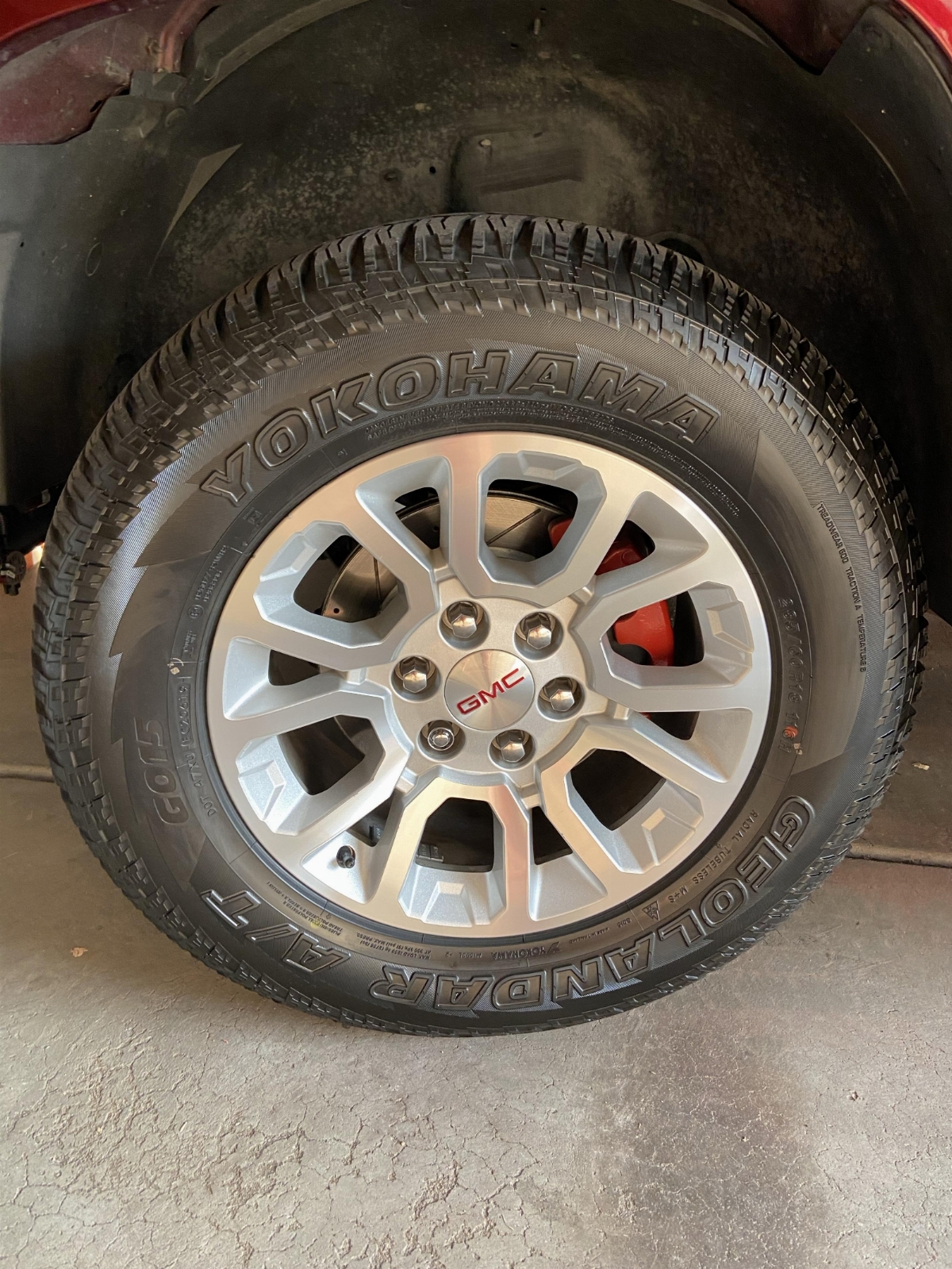

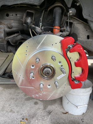

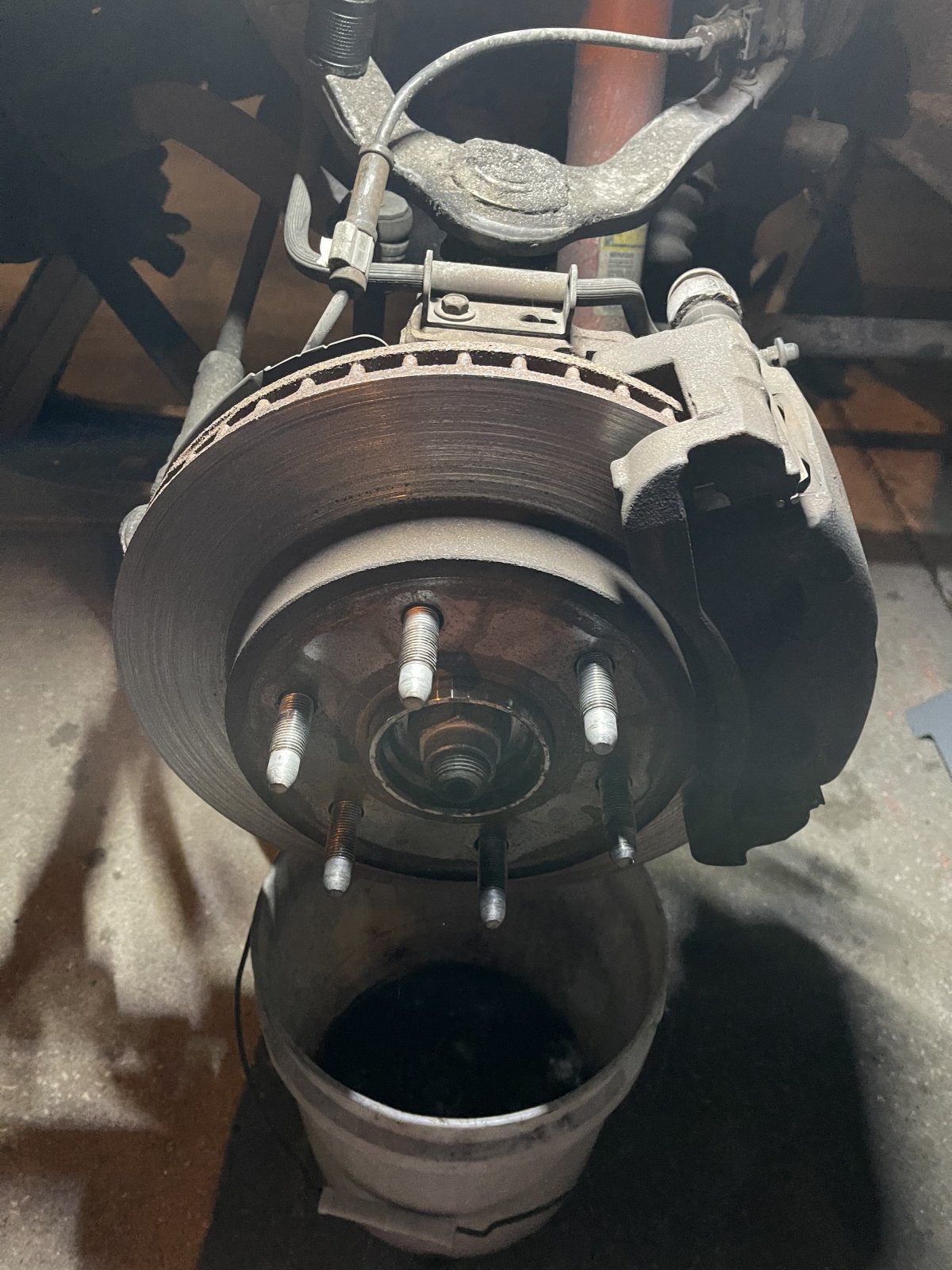

Weird was a screen shot of the website and the kit. Must have stripped it, I have successfully installed the Power Stop PWR-KC2067-36 kit for an 2007 on my 2005 Denali. The SS lines from Russel was fun, very stiff but was cold out so didn't help. But wish they had the same brackets as original and a little longer so could route them like the original lines. Here couple pics, to note i do have swapped rims and they are 20s, so no problem with clearance but don't think would be an issue with the oem rims.
Photo Dec 23, 21 22 04.jpg Photo Dec 24, 12 14 10.jpg Photo Dec 24, 12 16 19.jpg

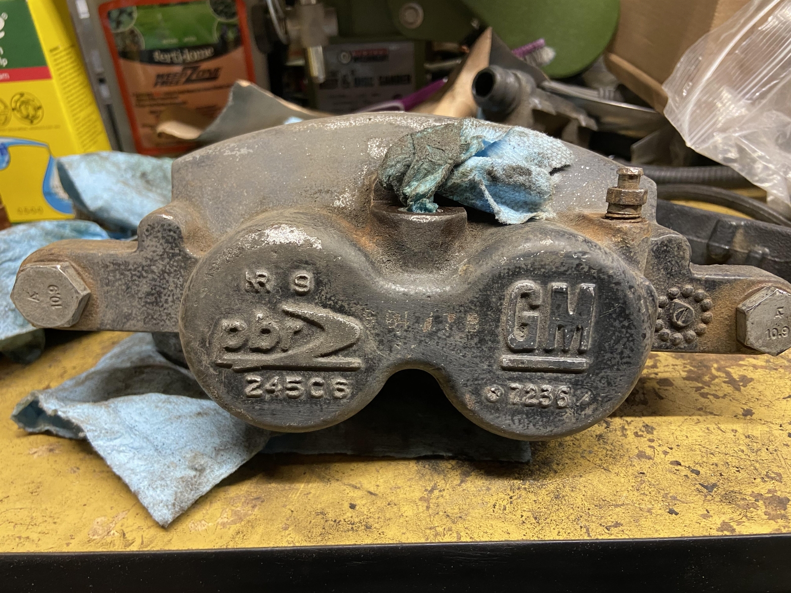

I believe you are correct about the difference from 07 to 08+ being the drag reduction clips. They do have different casting numbers.

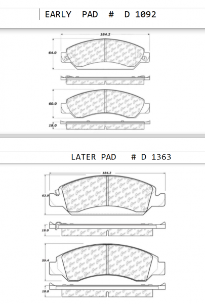

- YEARS --- PAD # ------ MODEL ----------------------------- YEARS ----- PAD # --
2005-2007 - D1092 - SILVERADO/SIERRA 1500 --------- 2008-2014+ - D1363
------ 2007 - D1092 - AVALANCHE 1500 ------------------ 2008-2013 - D1363
------ 2007 - D1092 - ESCALADE (EXCL EXT & ESV) ----- 2008-2015+ - D1363
------ 2007 - D1092 - ESCALADE (ONLY EXT & ESV) ----- 2008-2014 - D1363
------ 2007 - D1092 - SUBURBAN 1500 ------------------- 2008-2015+ - D1363
------ 2007 - D1092 - YUKON 1500 (INCL XL & HYBRID)- 2008-2015+ - D1363
------ 2007 - D1092 - TAHOE ------------------------------ 2008-2015+ - D1363
------------------- EXPRESS VAN 1500 ---------------------2009+ - D1363
------------------- SAVANA G1500 --------------------------2010+ - D1363
THE NNBS upgrade also includes the K2XX. The calipers, pads, and rotors did not change from 2007 to 2019 (K2XX).
The pads are almost completely identical in size and shape, but they attach differently to the caliper. They both use the same rotor, but if you are possibly piecing together from different locations (such as ebay or a friend and trying to save a few bucks), you will need the pads that goes with those years calipers (/vice versa). If you are ordering all of it at once, and have the option, personally I would order the 2008+ (even 2009+) year, simply because the K2XX (generation 14+) used the same front brakes as the NNBS. So getting pads down the road should give you more options. I THINK the earlier calipers have a finned design.

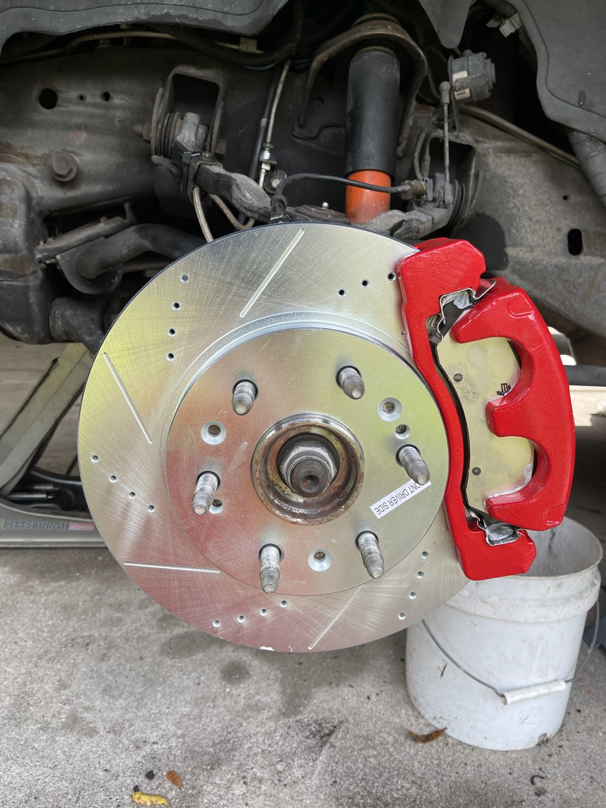

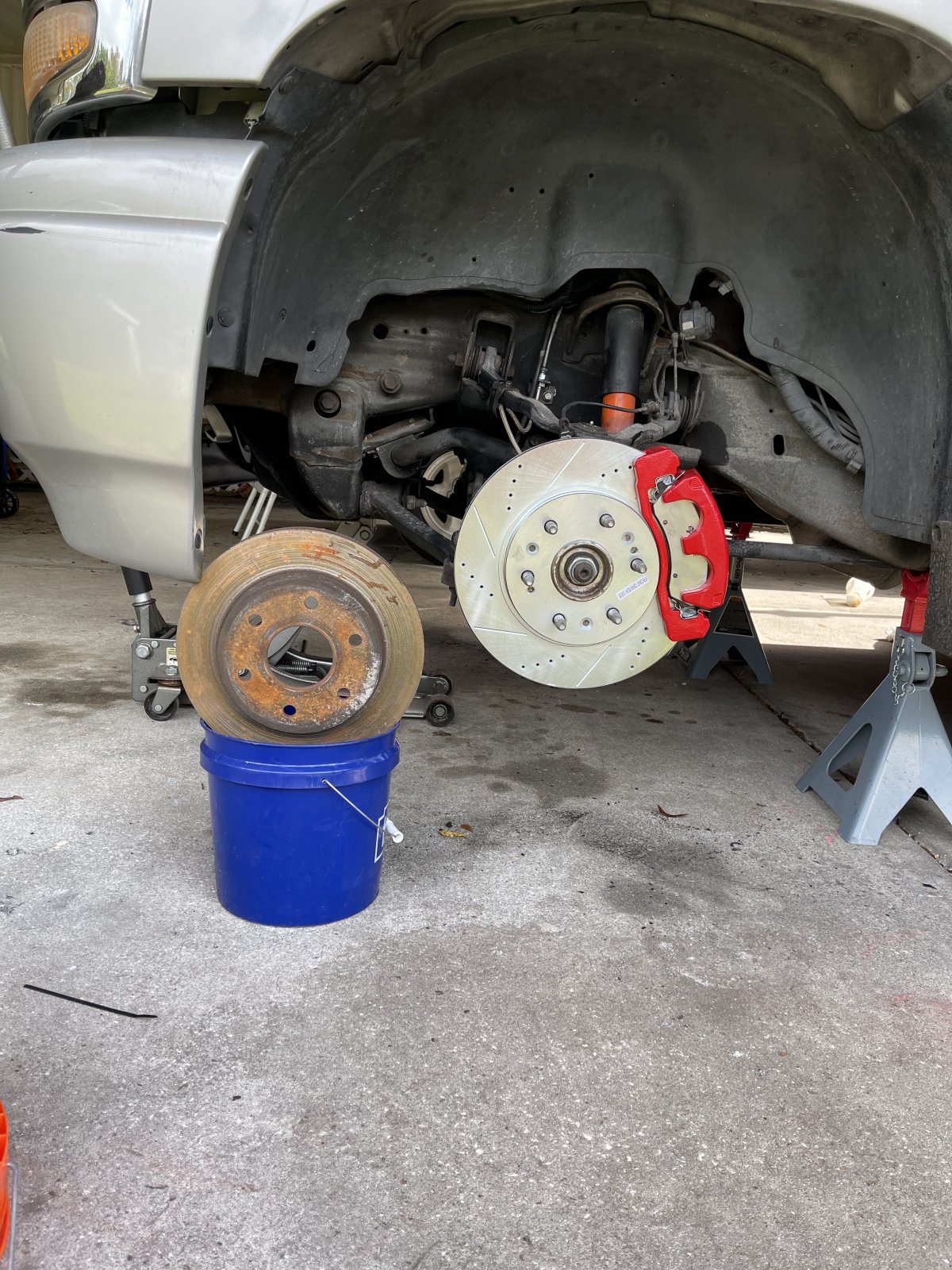

Just want to add: I’ve had my NNBS upgrade on now for a couple months, and it’s absolutely worth it. Braking is MUCH better! Definitely a worthwhile upgrade, and I also recommend going with a set of stainless braided lines.
And the install:
