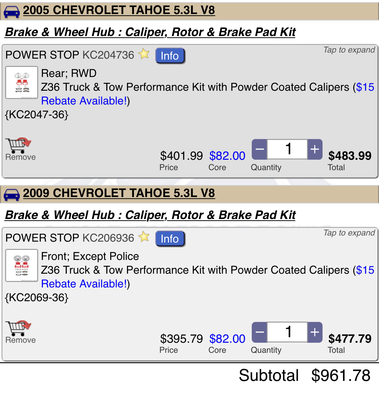

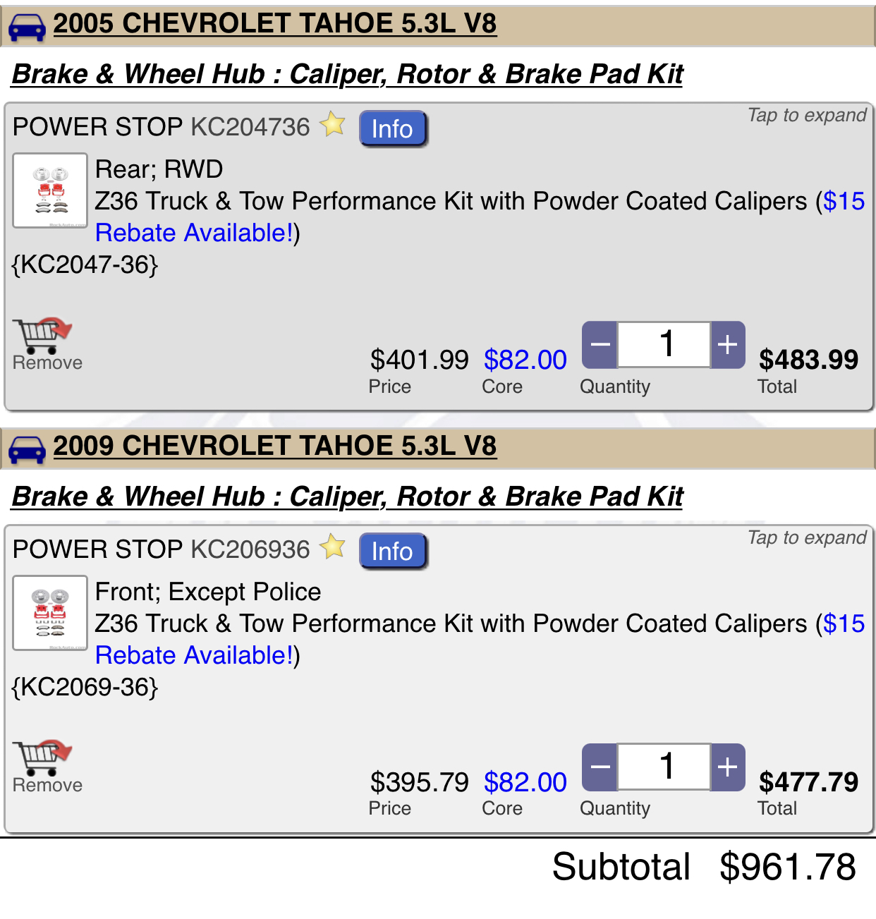

Well all ordred up. Front 2007+ and Rear 2005 Powerstop Z36 kits and Goodridge SS lines. $1150 for it all. I wish I seen this when prices were so much cheaper. But hey, its the world we are in right now. Hope to have it installed the day it comes in!
