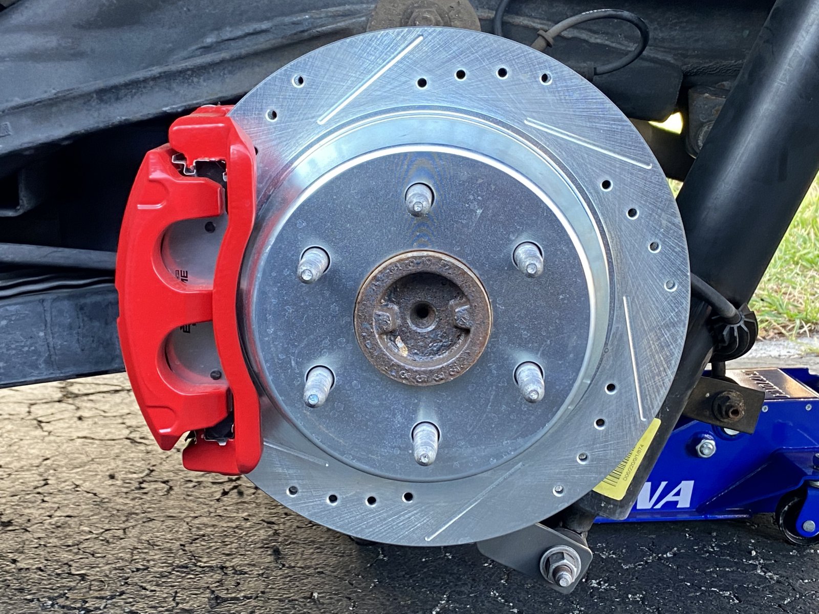

So I finally got around to installing my NNBS brake upgrade. Got 2009 Powerstop fronts and 2005 Powerstop rears. Also did all 6 Goodridge SS lines. I honestly think I have to rebleed the brakes. Pedal still feels a bit soft. Loving them so far tho!!
Pretty much the exact setup I went with, and it works AWESOME! I’ve had to use it for several panic stops, due to incompetent drivers, and truly believe they’ve saved me every time from any damage to my vehicle. I like them so much, I just added the equivalent setup to my old Honda. Too bad I don’t have larger wheels on that yet, or would have made it a big brake upgrade as well. I used to run some nice summer wheels on the car, but all that changed 15 years ago when I became a single dad, and priorities changed overnight.

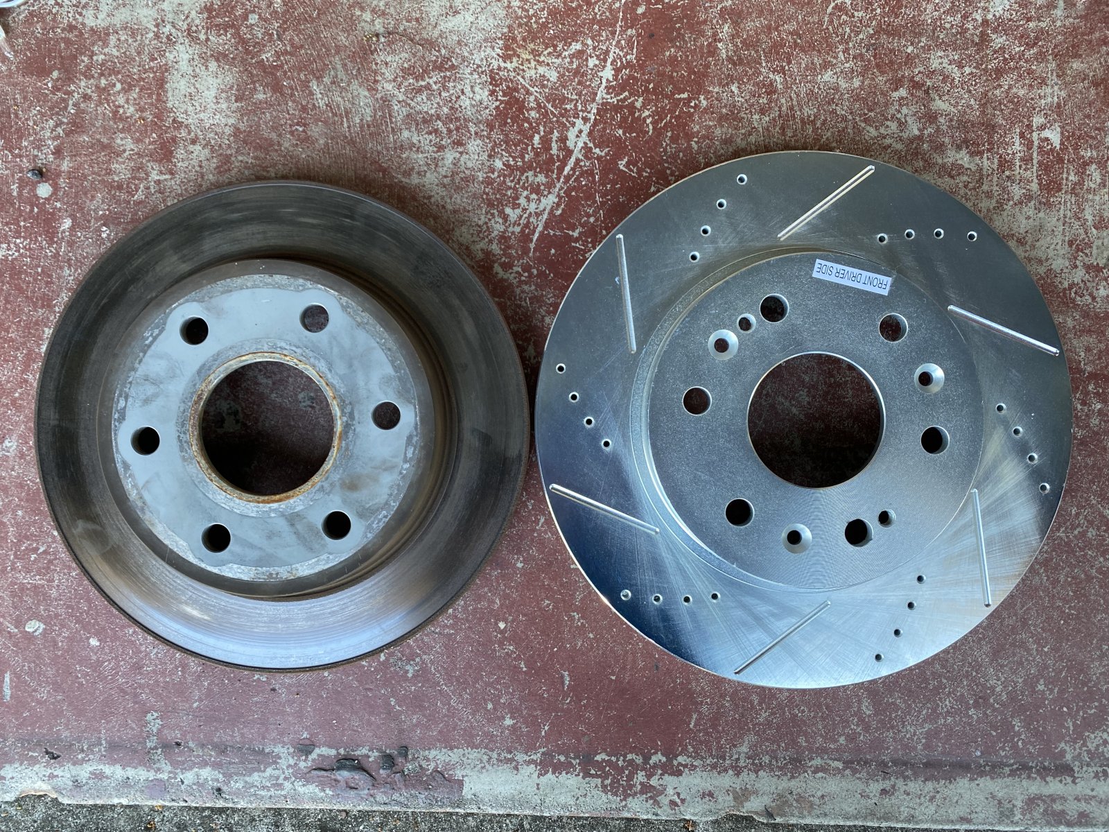

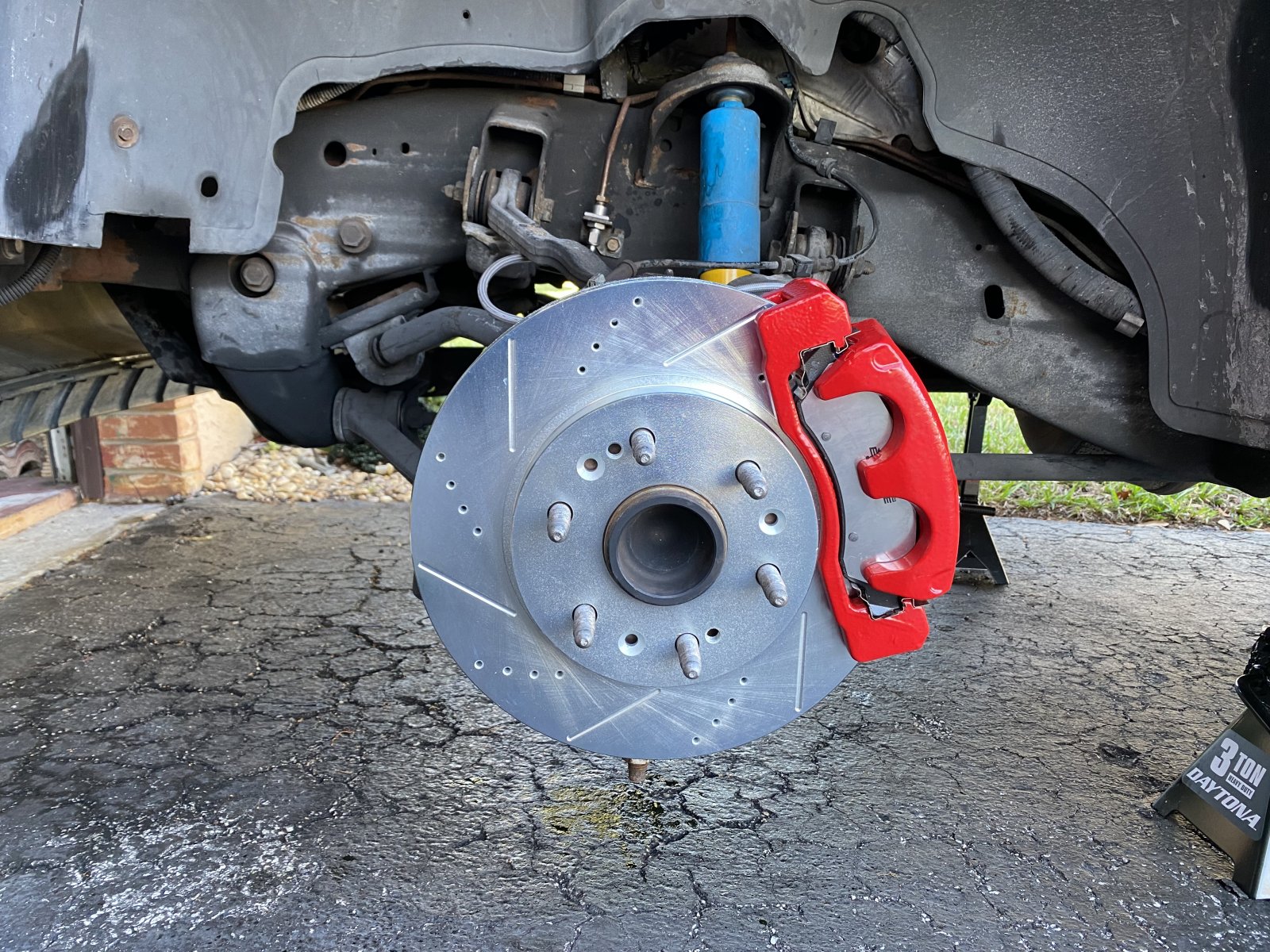

I did the upgrade last week and noticed right away how my '04 Tahoe feels lighter when stopping. Calipers came from an '08 Sierra ($40/pr) and cleaned up nicely. New caliper seals, brake pads and regular ole boring rotors arrived from Amazon. Money well spent.

I suppose there's no way to be sure whether it's the larger rotor or the upgraded caliper that's improving my stopping distances and brake pedal response.
All I know is, my GMT821 will never go back to using GMT800 front brakes.
