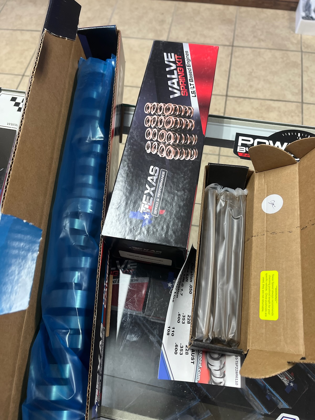

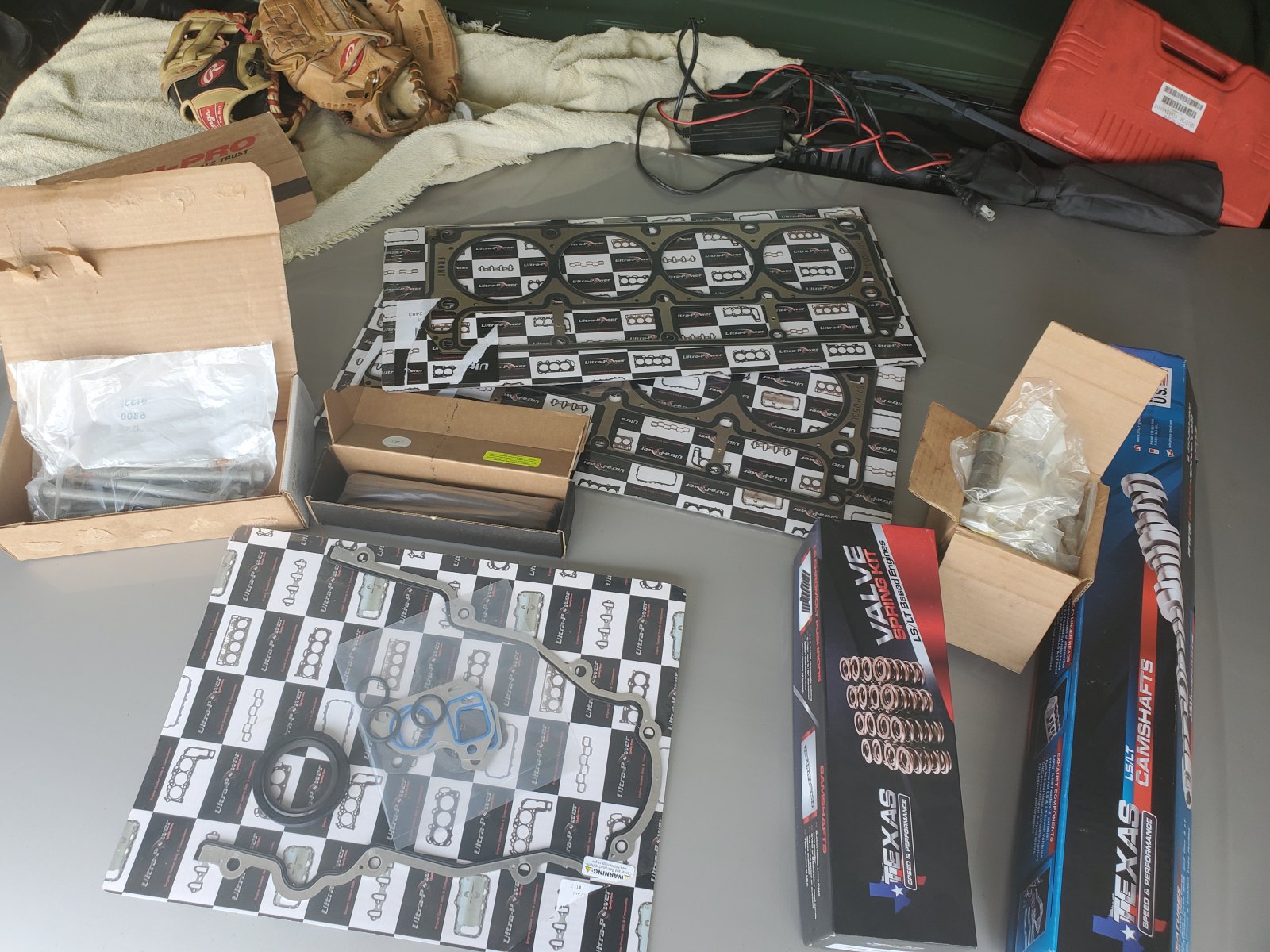

I got with them this morning and the parts were out of warranty, the work was done in 2020. They did give me a big discount on the new parts I purchase from them this morning.
New cam (just a bit bigger)
Dual spring setup
Chrome moly pushrods
OEM LS7 Lifters
Dual spring setup
OEM LS7 Lifters
How many miles were on engine since repair, I wouldn't use the push rods they used they shouldn't look that bad almost looks like they weren't heat treated correctly. Good luck with your repair.

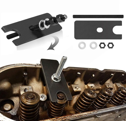

@Dantheman1540 Do you have the part number of your spring compressor. I'm thinking of rebuilding the engine I pulled out when I dropped a new upgraded engine into my Tahoe. My old heads have dual springs and I may want to have the heads refurbished.
Here’s a link! Iirc I bought better bolts to use with it because I bent them. I’m also a savage and can break anything, be less like me.
COMP Cams 5462 Valve Spring Compressor for LS Engine https://a.co/d/bsnRRgJ

I used one like this. Simple, cheap, works great. I did have to adjust the position just right before starting to compress the dual springs so the valve stem would be centered when compressed and the keepers would go on. And don’t forget to use a dab of grease on the keepers when you install them so they stay put.
Thank you for the link.
