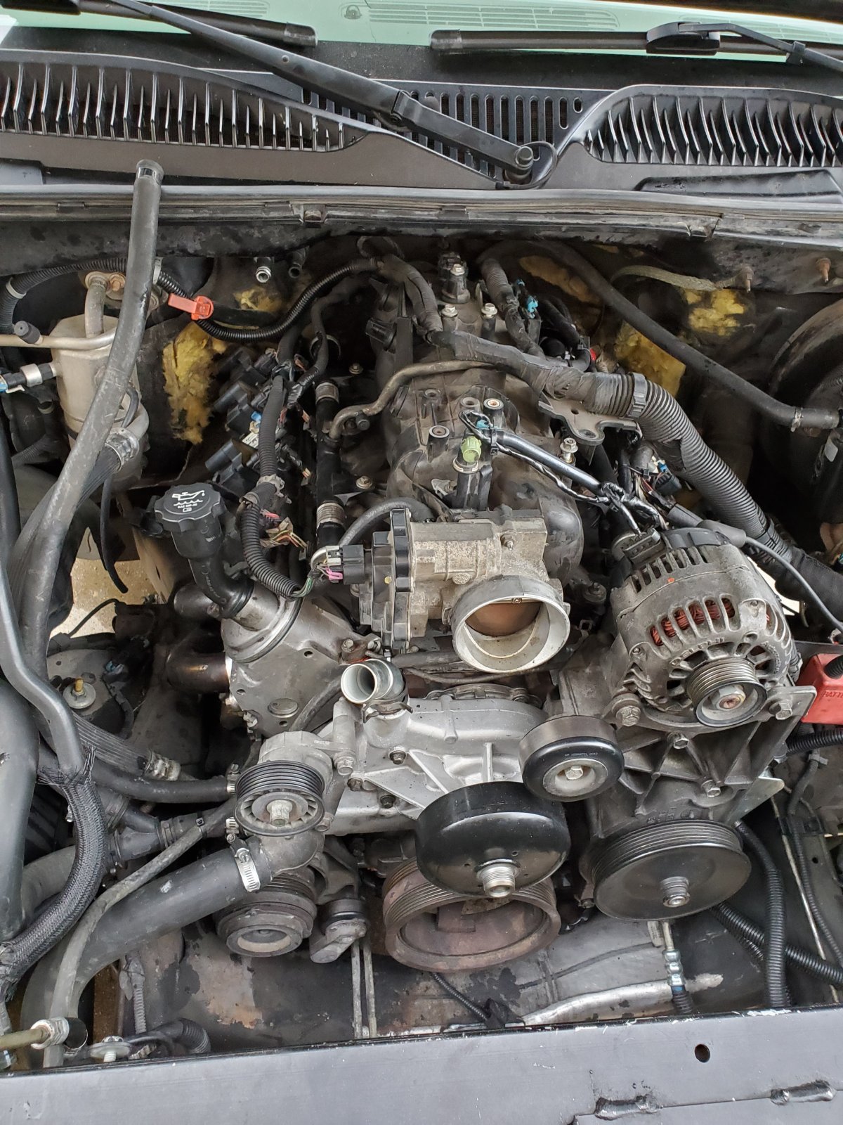

Starting to see daylight at the end of the tunnel, only thing left to do is install the plugs, wires, fan shroud, fan and button up some of the cooling hoses. Super excited to hear it run.

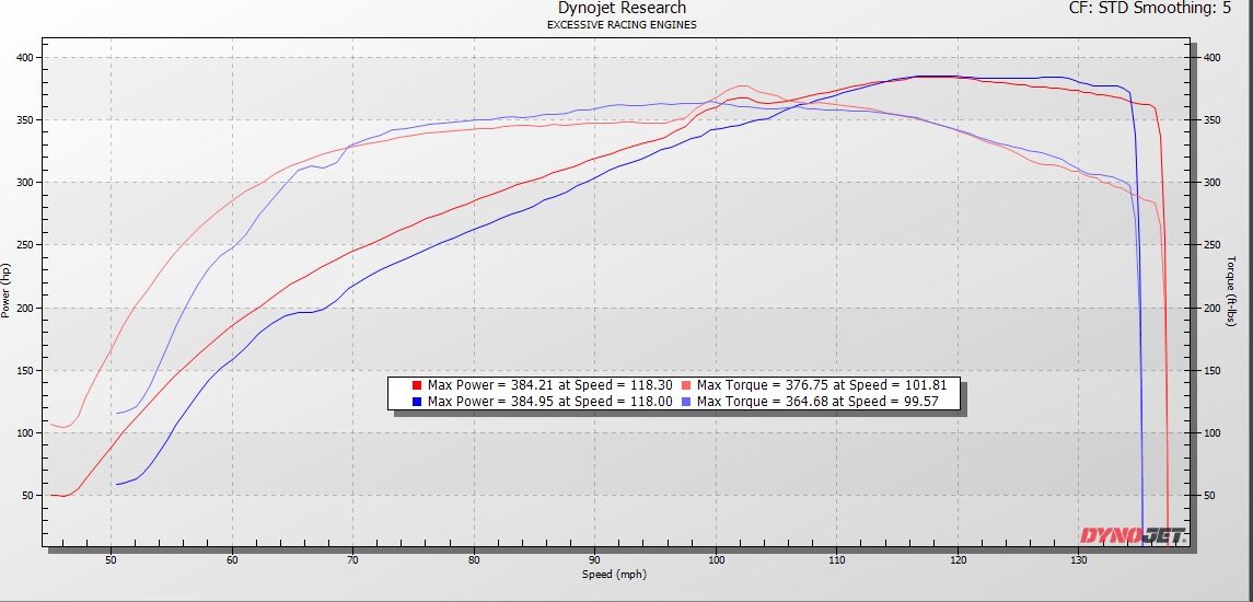

What are the specs to the cam you have on your yukon?
It’s Vinci’s “trucker” cam…not as nasty as the one you’re running. It’s got good lope though, sounds great in combo with the blower. Lope and whine lol.
DUR @ .050" 216*/ 224*
LIFT .553/.553
LSA 115*
5A
