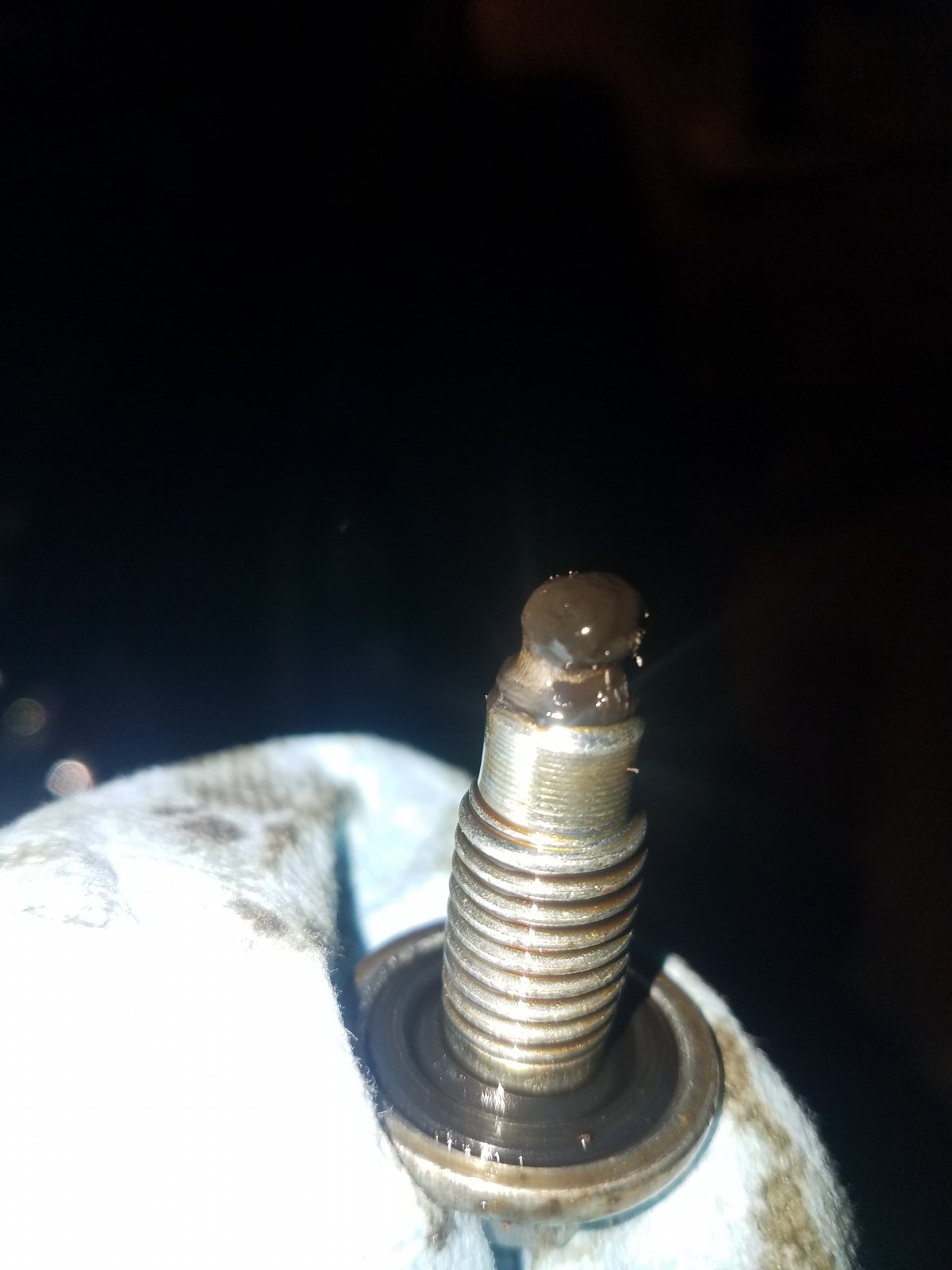

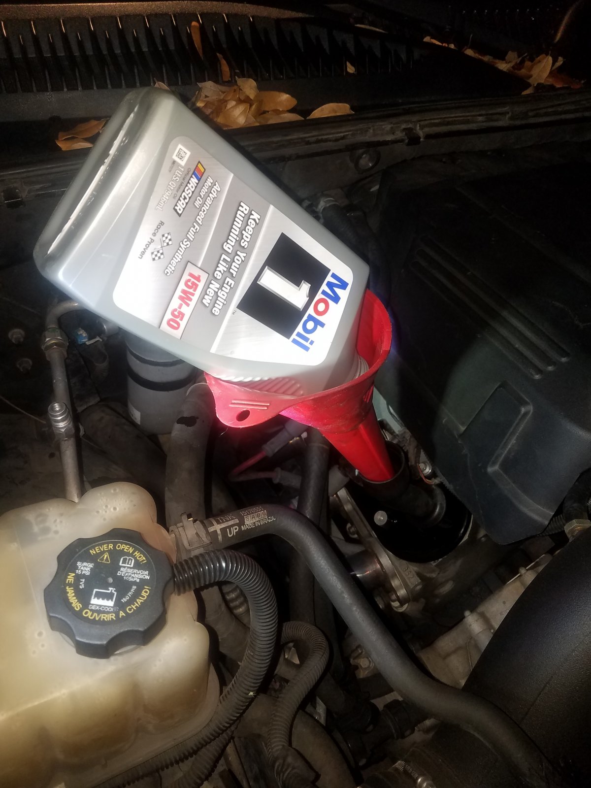

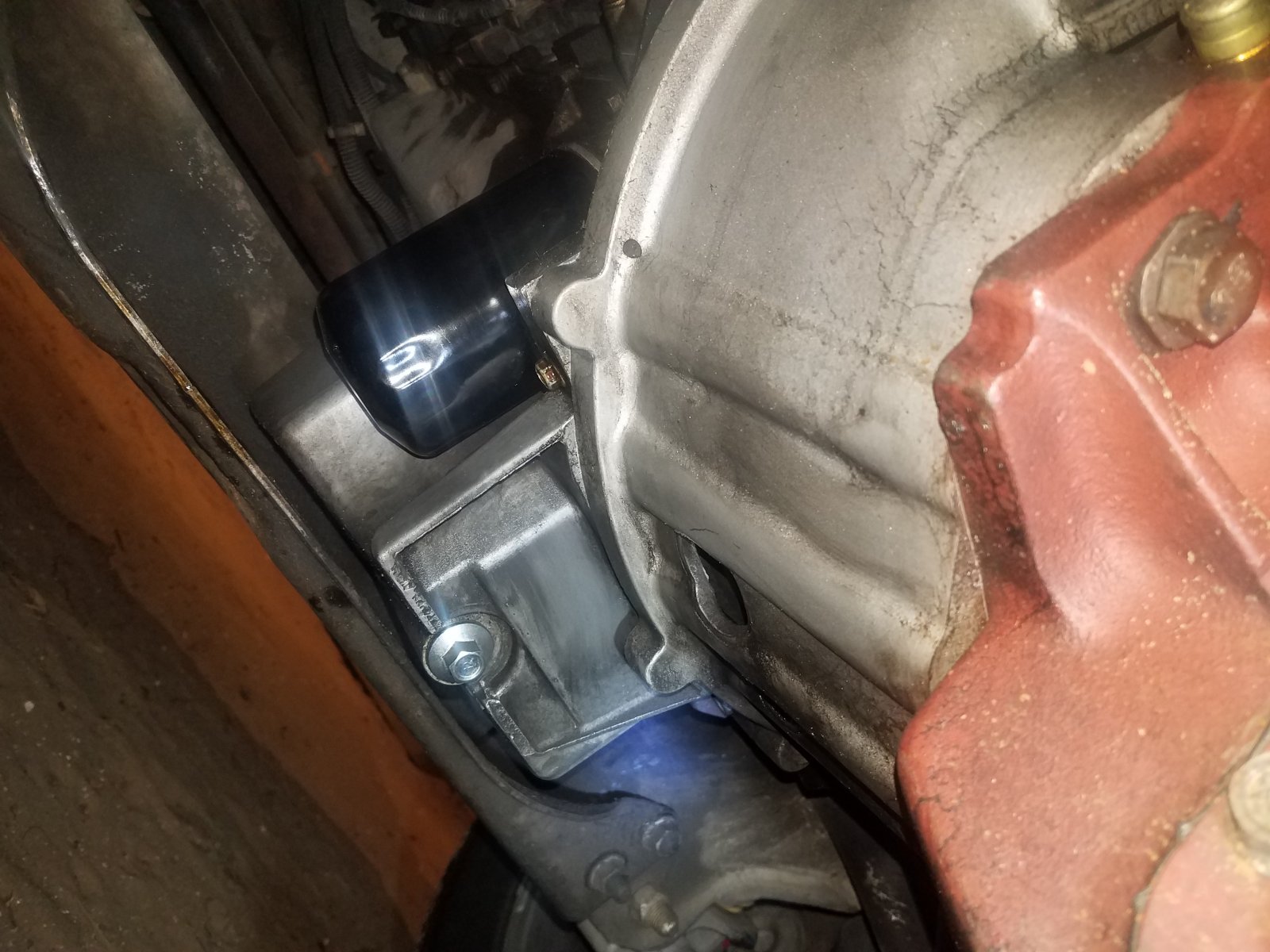

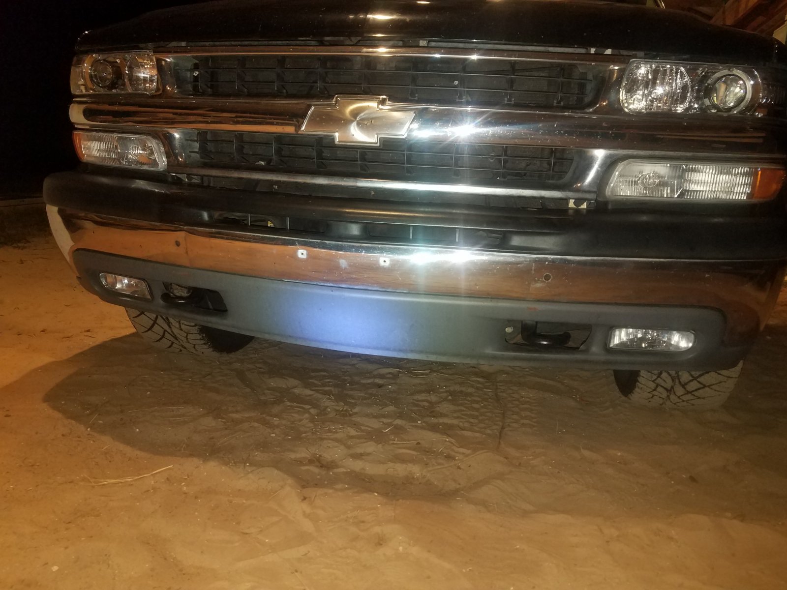

It was time for a little maintenance tonight and since my shop is currently full I had to do it in one of my barns.
Changed oil over to some thick stuff since the rear main leaks a bit. Drain plug looked normal and I cut open the filter which looked clean as a whistle. I think it's been 5 or 6k since the last oil change and around 8 or 9k since I did the filter when I first bought it.
Also added some tow hooks I picked up used.
