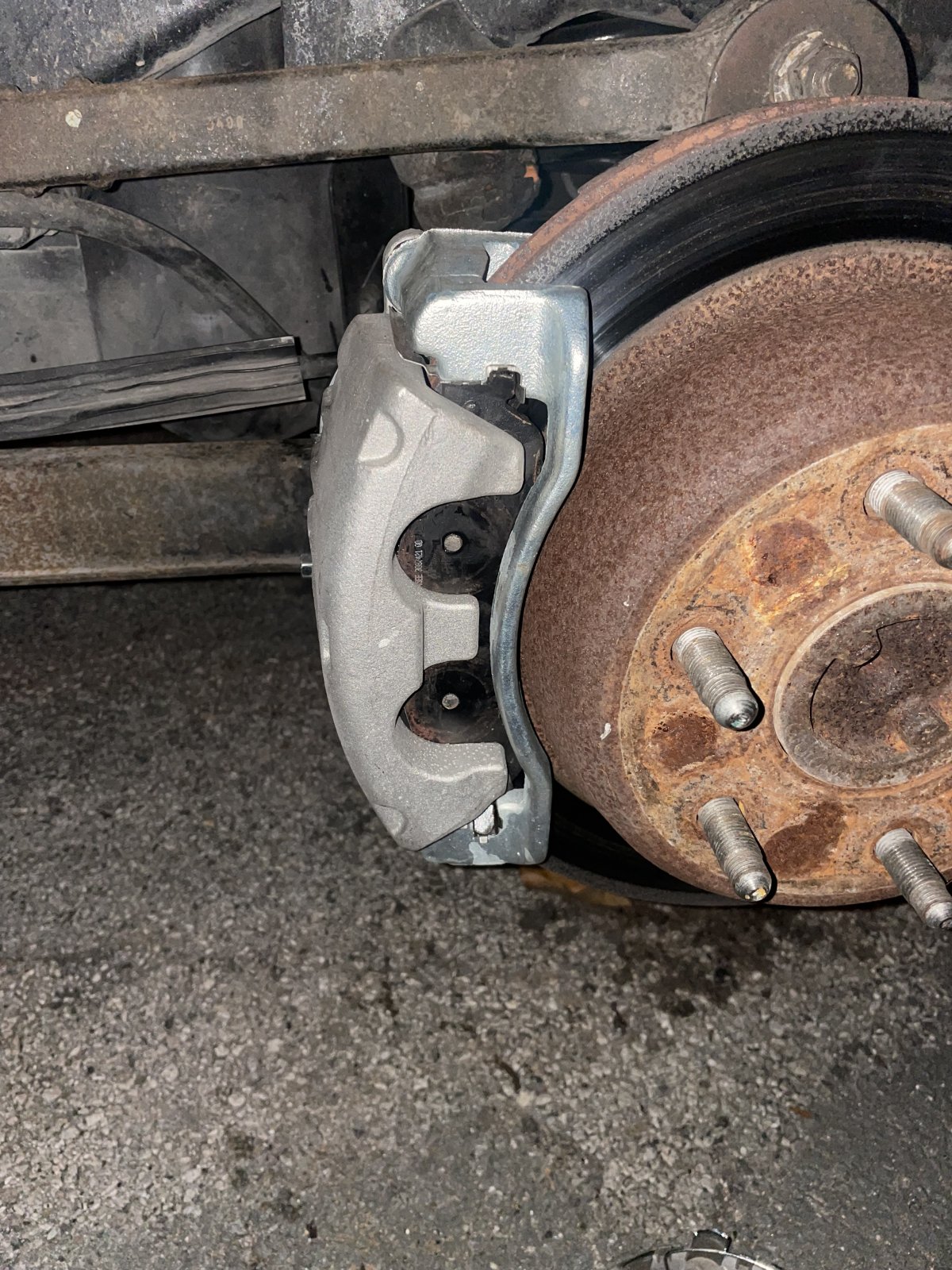

Can you post a pic of your rear calipers?

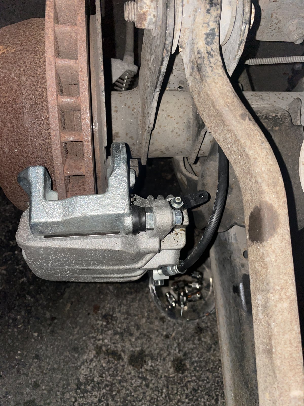

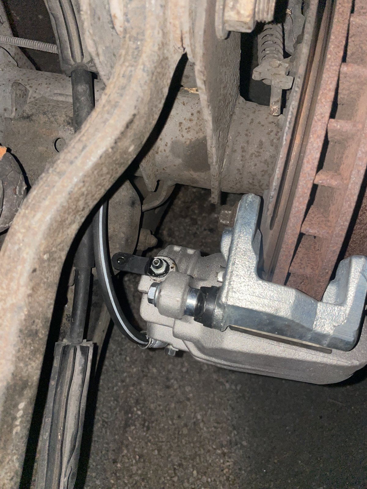

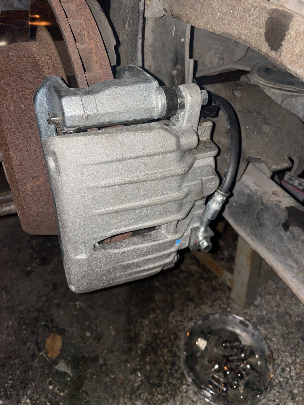

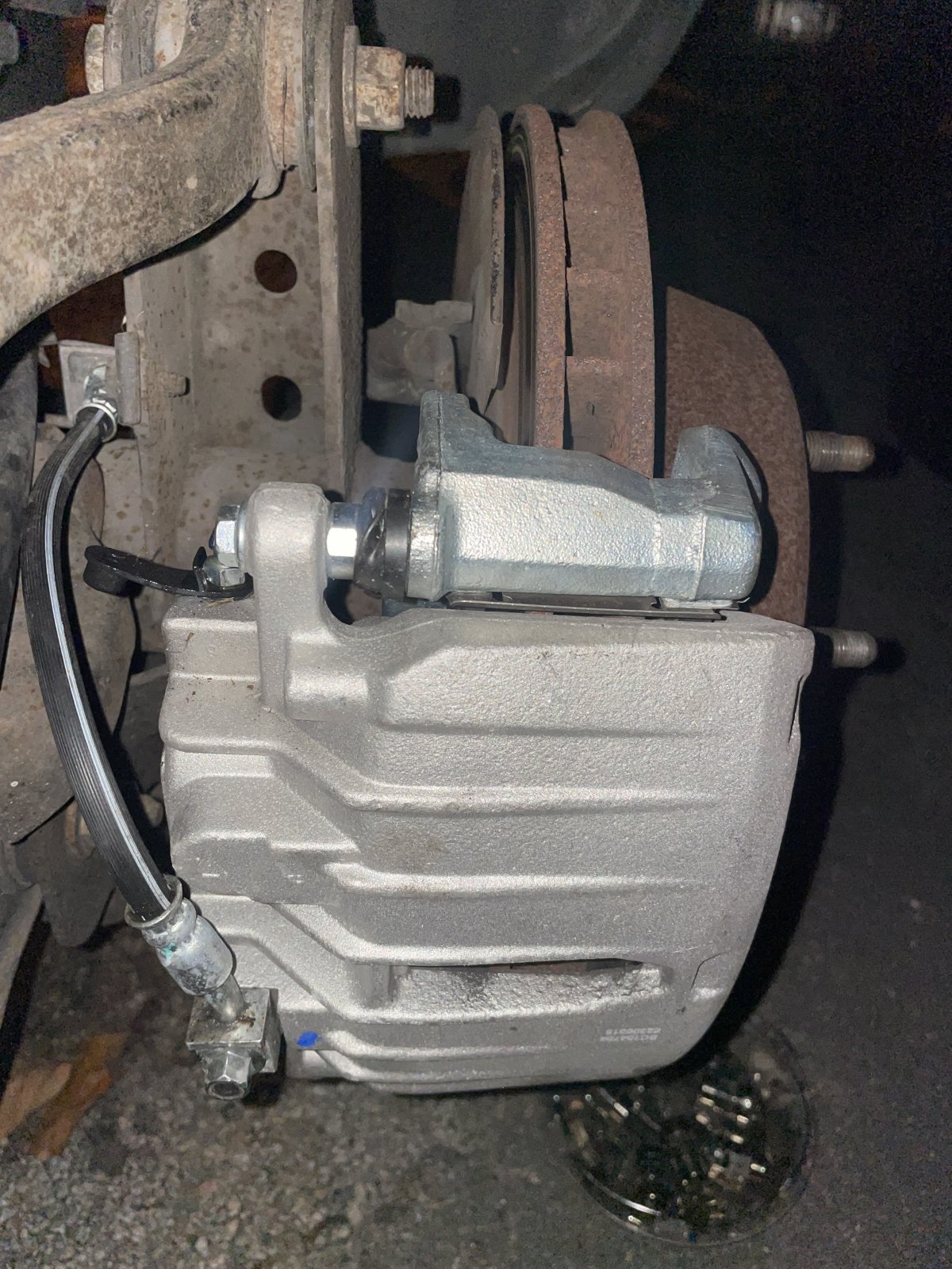

Driver side
C
Cellison
Feb 4, 2024
15
Dammit. Your symptoms match those of calipers installed on the wrong sides which puts the bleeders at the bottom. My next stabs are defective new master cylinder or there's a crap ton of air trapped in it somewhere.
