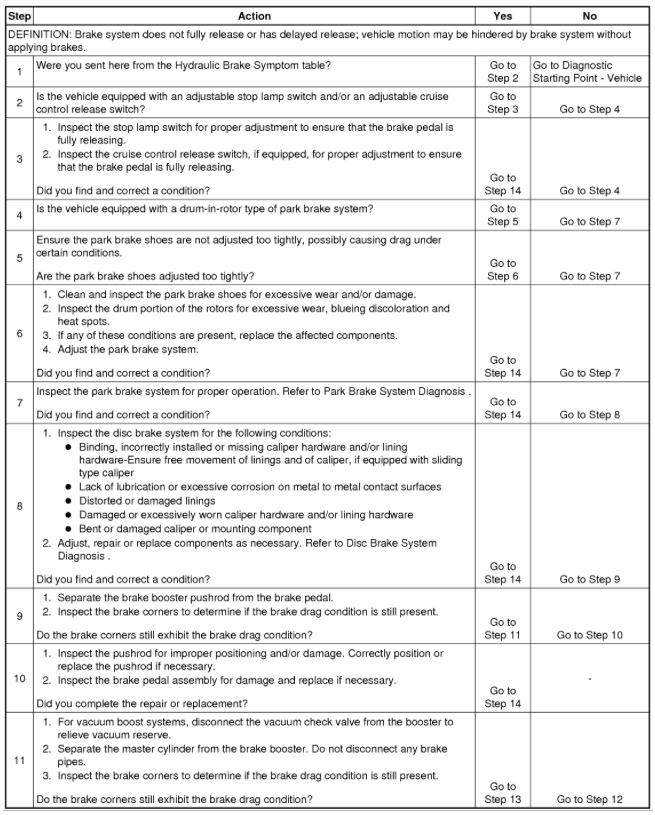

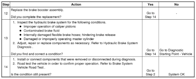

Here is the official troubleshooting guide for dragging brakes:
