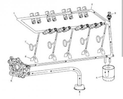

I'm sorry that you are going thru this, I would have the shop redo the work. I bet they used the wrong oring and didn't even clean the pick up tube. Apparently those yahoos have never worked on an LS engine to know that the pick up tube needs to be cleaned. It's hard to believe that an LS engine died at 111k miles. I seen them reach almost 400k miles with regular maintenance.
Do you know the history of the suv? Has it used conventional oil most of its life? To find out remove a valve cover and if it has oil gunk build up the engine is toast. The oil passages get plugged with gunk and don't let oil thru to the top of the engine.
