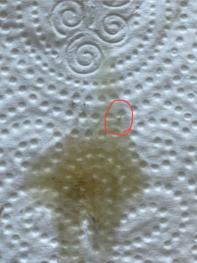

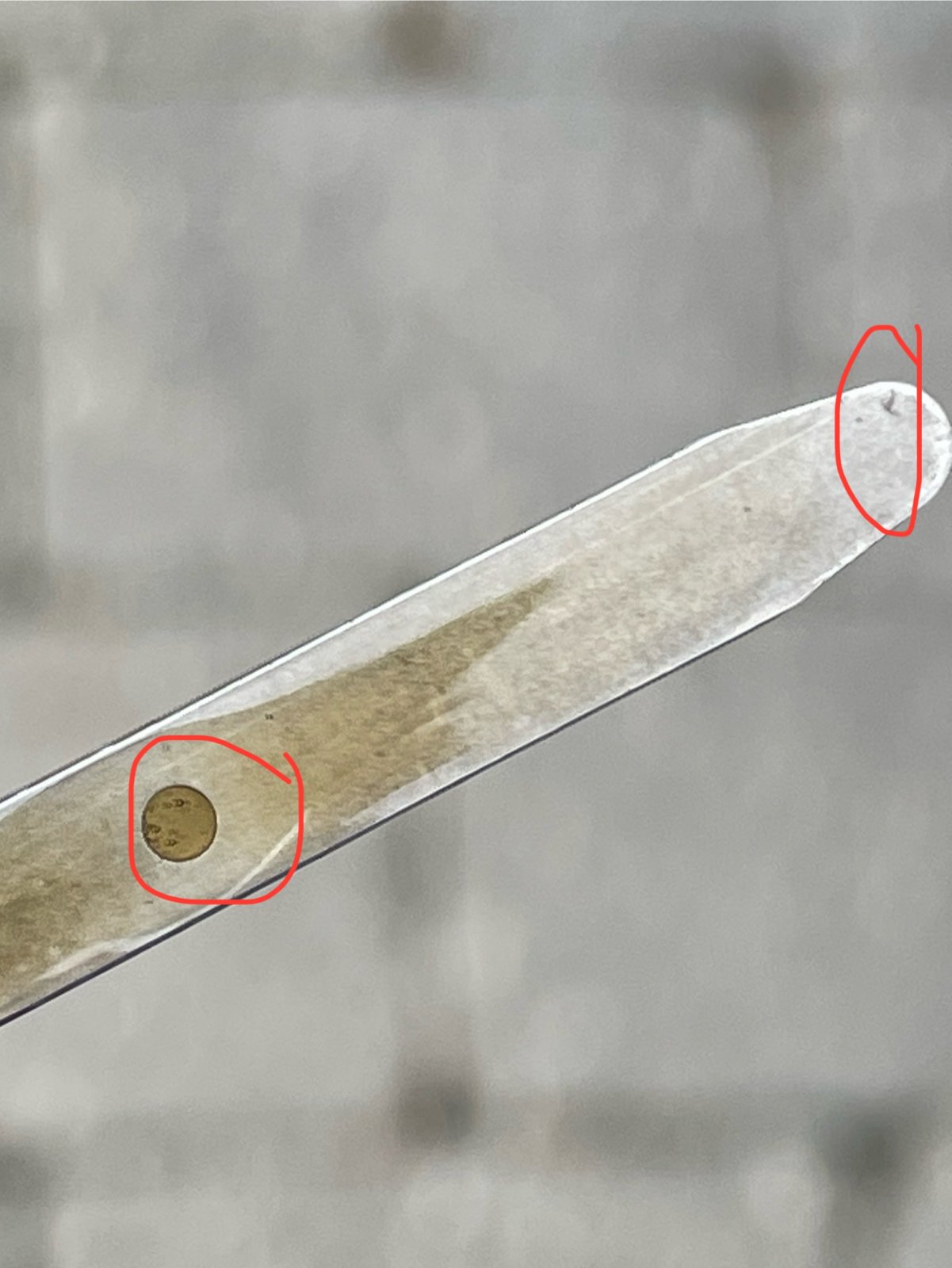

Took a look at the oil dipstick today. It looks like I have metal shavings on the tip of it and the oil also has small black spots. Will reach out to oil analysis company on Monday and see if they can help.
The dipstick can't give you a big enough sample to say. That could've been from anything, including manufacture of the dipstick itself. I agree with your inclination to have oil analysis done, and I would cut apart the oil filter and inspect the element for metal shavings also. The rule of thumb for visual analysis of the filter media is if the actual metal material (not carbon) from the filter is enough to cover your pinky nail, it's time for concern. I use a magnet to collect ferrous metal from the filter media. In general, aluminum wear creates gray dust and tiny blocky chunks, and steel wear generates tiny slivers. Anything big enough to read a part number on is obviously a problem. :p
That said, are you still getting the rather loud knock at cold startup that you posted in your first video? I just gave that another listen and it seemed pretty loud for piston slap. The 6.2's especially get some good piston slap at cold start but neither of mine have ever been quite that loud.
