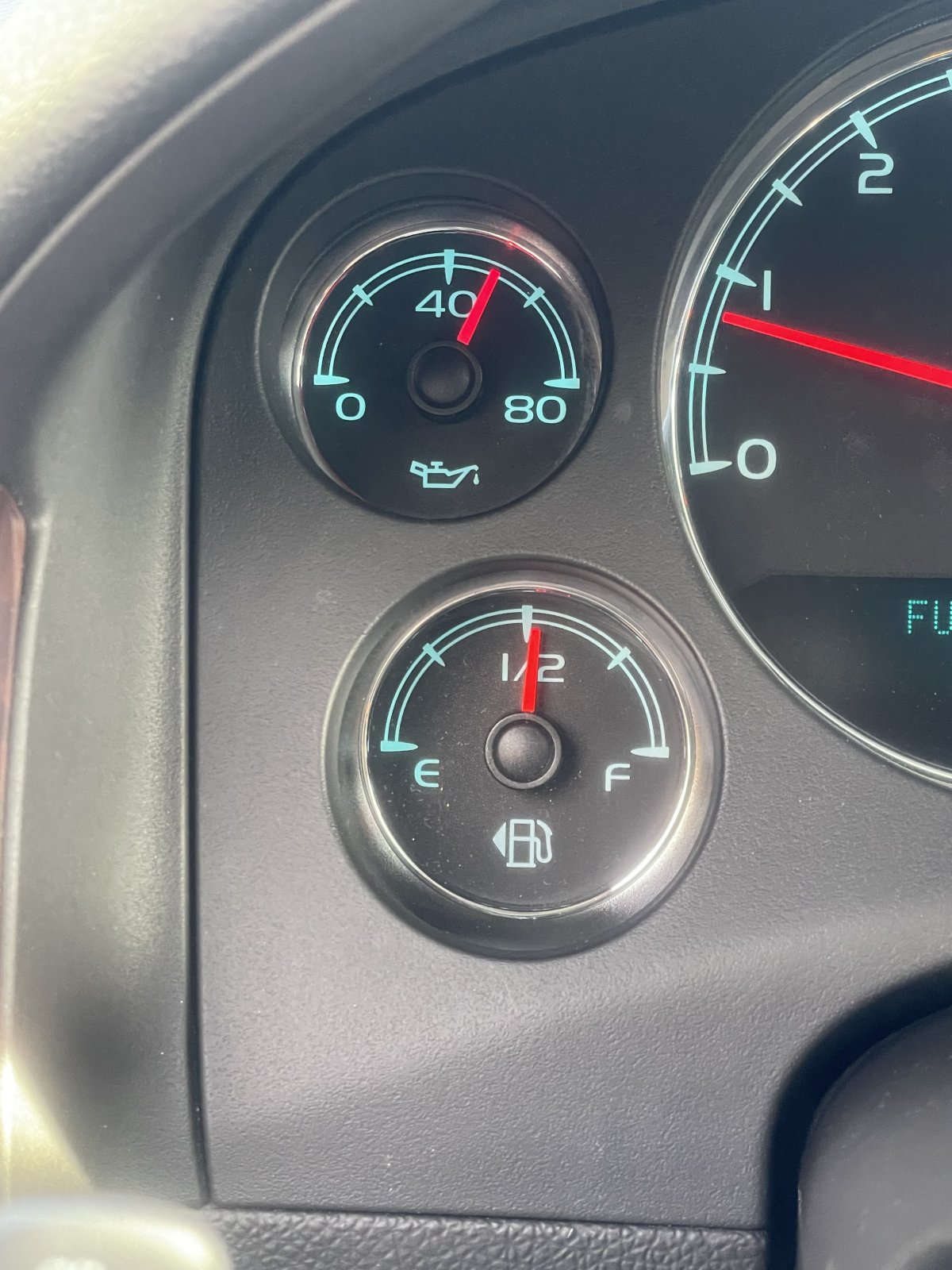

Update.
Got the Yukon back after the o-ring replacement.
Oil pressure is worse now than before the change. Before the change it was 11 psi at hot idle, now it’s 8 psi.
Oil and filter was also changed so everything should be new. However I never thought that the pressure would get worse after the change, it really sucks…

That makes no sense. What else did they say? Did they inspect the pickup tube and screen, did they clean it out thoroughly? Making the seal refreshed and rejuvenated yet resulting in lower pressure doesn't add up IF no other factors changed.

I mean 3 psi is a pretty small difference. especially if read off the dash gauge, could be just a different brand oil filter or a few rpm lower idle.
I'd chalk that up as no change in my book. I do personally believe we overly blame the o'rings for low oil pressure, from posts I see most end up going back in with a high volume pump. Sadly that might be your next step. if it's something you can do yourself, I don't know.

They said that the o-ring was flat and hard. Didn’t mention anything about pick-up screen, I think they only changed the o-ring. They did put on a new oil pan gasket, 5w30 oil and AC Delco oil filter. At this point I can’t find a reasonable explanation for having a worn out o ring replaced and then have lower oil pressure. Even on cold starts it’s a tiny bit lower (picture in post). For now it’s an unsolved mystery
