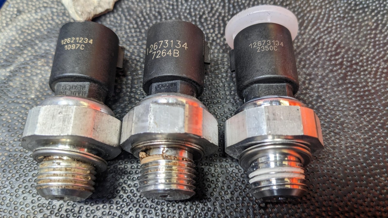

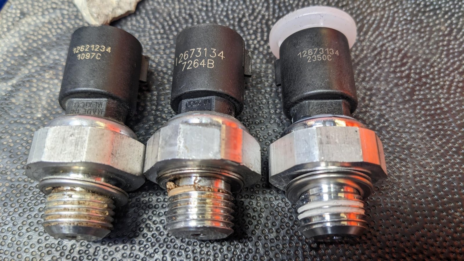

there might be a legit acdelco store in Amazon but it's definitely not what comes up for most people. I got taken twice. Just in oil pressure sensors. they look pretty close, bags look legit. but the Lazer font is wrong on the part itself compared to the oem 2011 one and the rock auto and local gm parts department one. plus both fail within a few months. sort the reviews by worst and you'll see a trend, none of them last more than 5 months, most don't update the reviews thou.
I've heard of gm parts department doing this before. they are selling fake parts to their customers. maybe not knowingly but if you can't get a part from the internal supply chain at dealer cost but you can buy it on Amazon for cheaper.and or our if stock everywhere else. it ain't real is my 2 cents.
I'm convinced Amazon is knock offs. left is the oem from 2011. middle us Amazon acdelco and right is rock auto. the 15$ middle one is not the same as the 50$ ones.
Even the threads on the end look different from the real ones !! not a nice taper/champ fer
