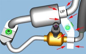

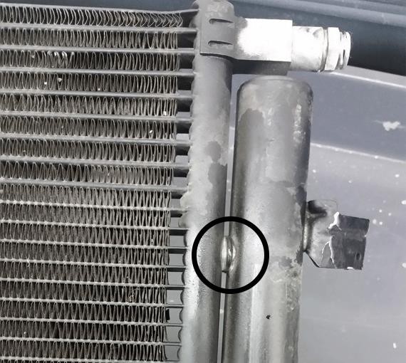

If condenser warranty was upped to 5yr/60k that's helpful. There's only one condenser/heat dispersal in front of the radiator. It's the evaporator/heat collection that there's two of, if equip'd for rear a/c.
It doesn't mean it's not there, but I couldn't find a GM recall specifically for rear A/C condensers.

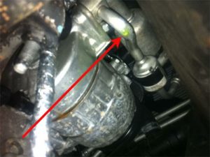

1-31-18 Class Action suit Approved on GM Recall 17336 Combi Cooler Air Conditioner Nov 2017 - GM will warranty ALL for the Escalade/Tahoe/Burb & Yukon goes from 2015-17. Interesting though it's the "thermal cycling on the combination transmission fluid/oil and AC condenser cooler creates a crack that may allow refrigerant to escape. The condition consequently may deactivate the AC system which may cause potential customer annoyance."
LOL, annoyance. Wonder what pissed off would look like?
https://gm.oemdtc.com/8154/special-...igerant-leak-2015-2017-cadillac-chevrolet-gmc
Apparently the hard line that returns hot gas from the condenser, bolted to the a/c compressor itself is also flawed in design. The lines can move until they crack, lose the a/c charge and ultimately cause compressor failure. If the compressor fails catastrophically, it can allow debris or contaminated gas (acid) into the rest of the system (and cause further customer annoyance).
https://www.consumerclasslawyersblog.com/bunch-hot-air-ac-gmc-chevy-trucks-simply-not-work/
In the above link, GM completely removed TechLink related to this issue. It's the hyperlink in red lettered word "here".
